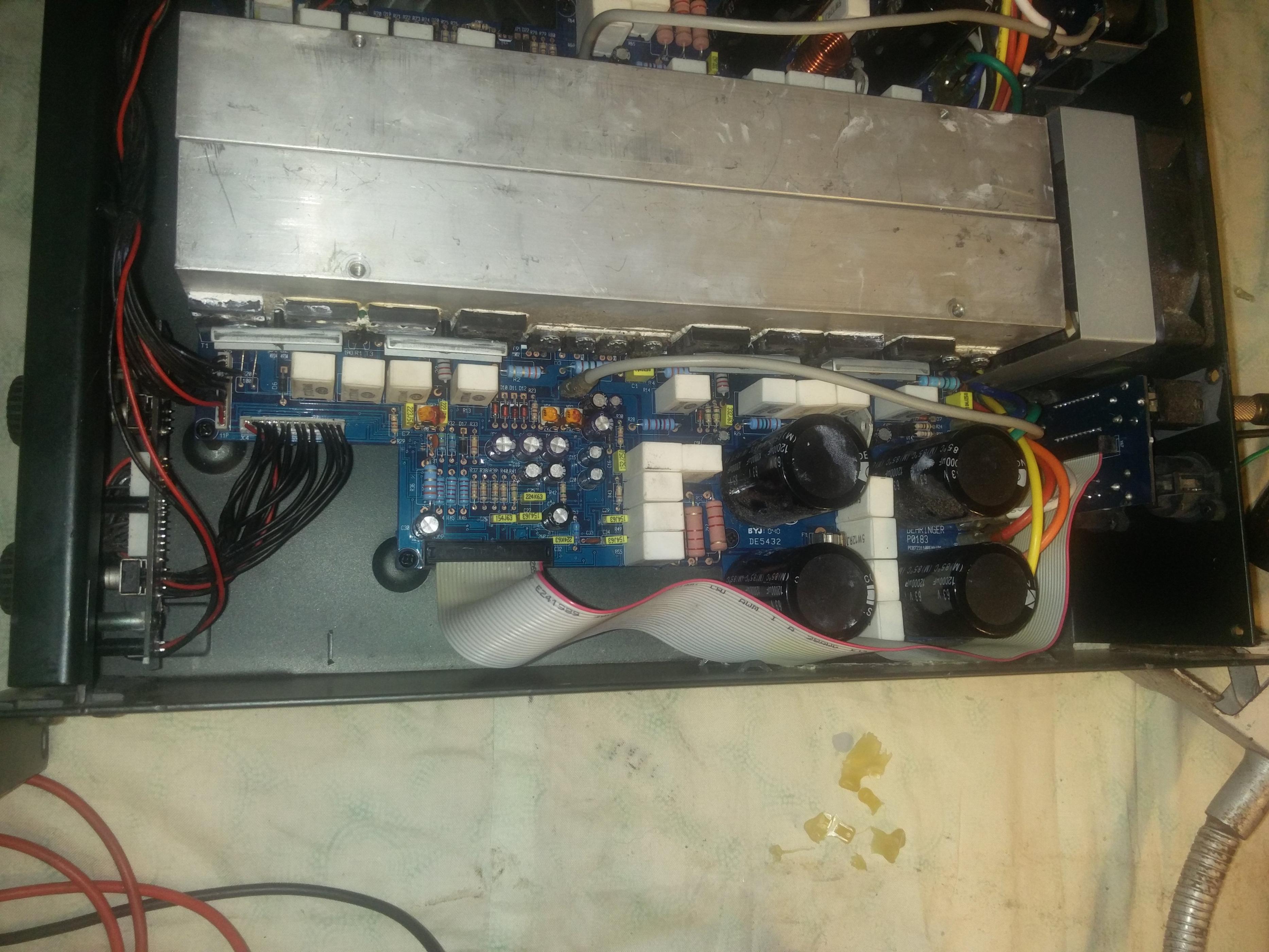

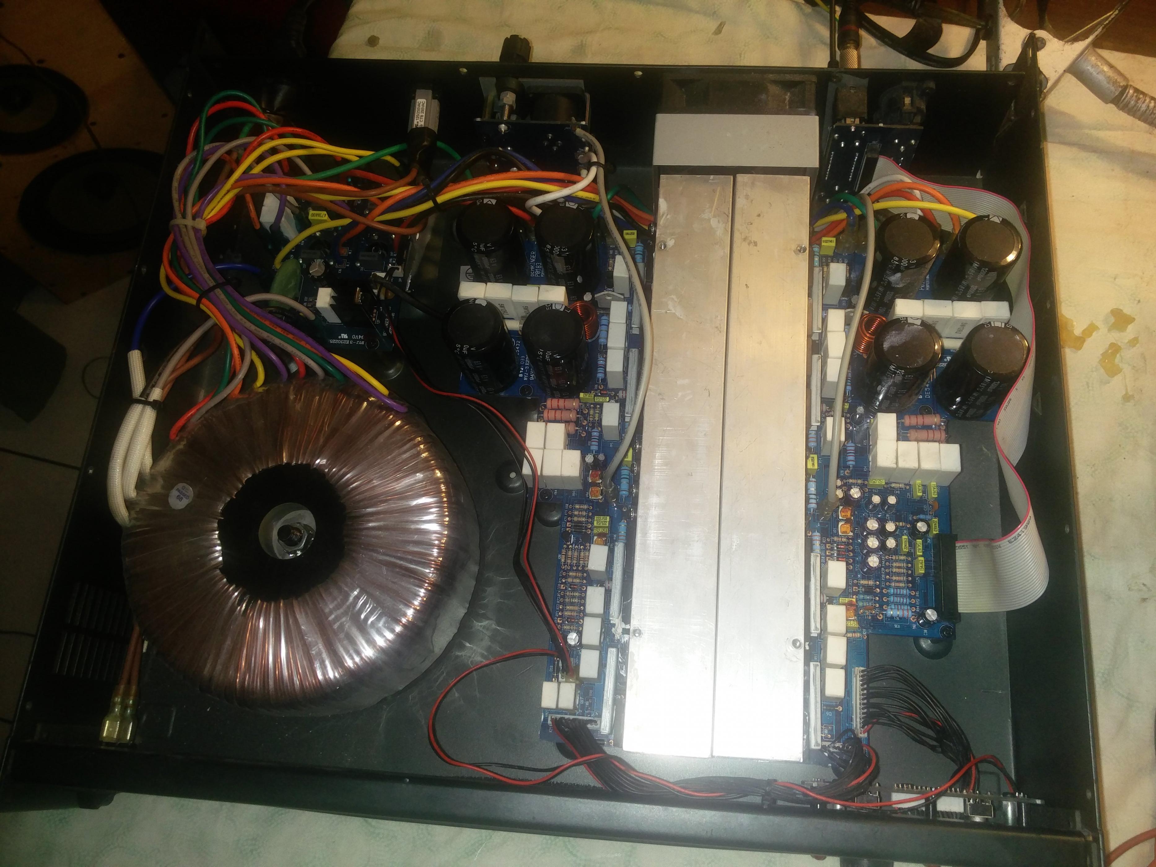

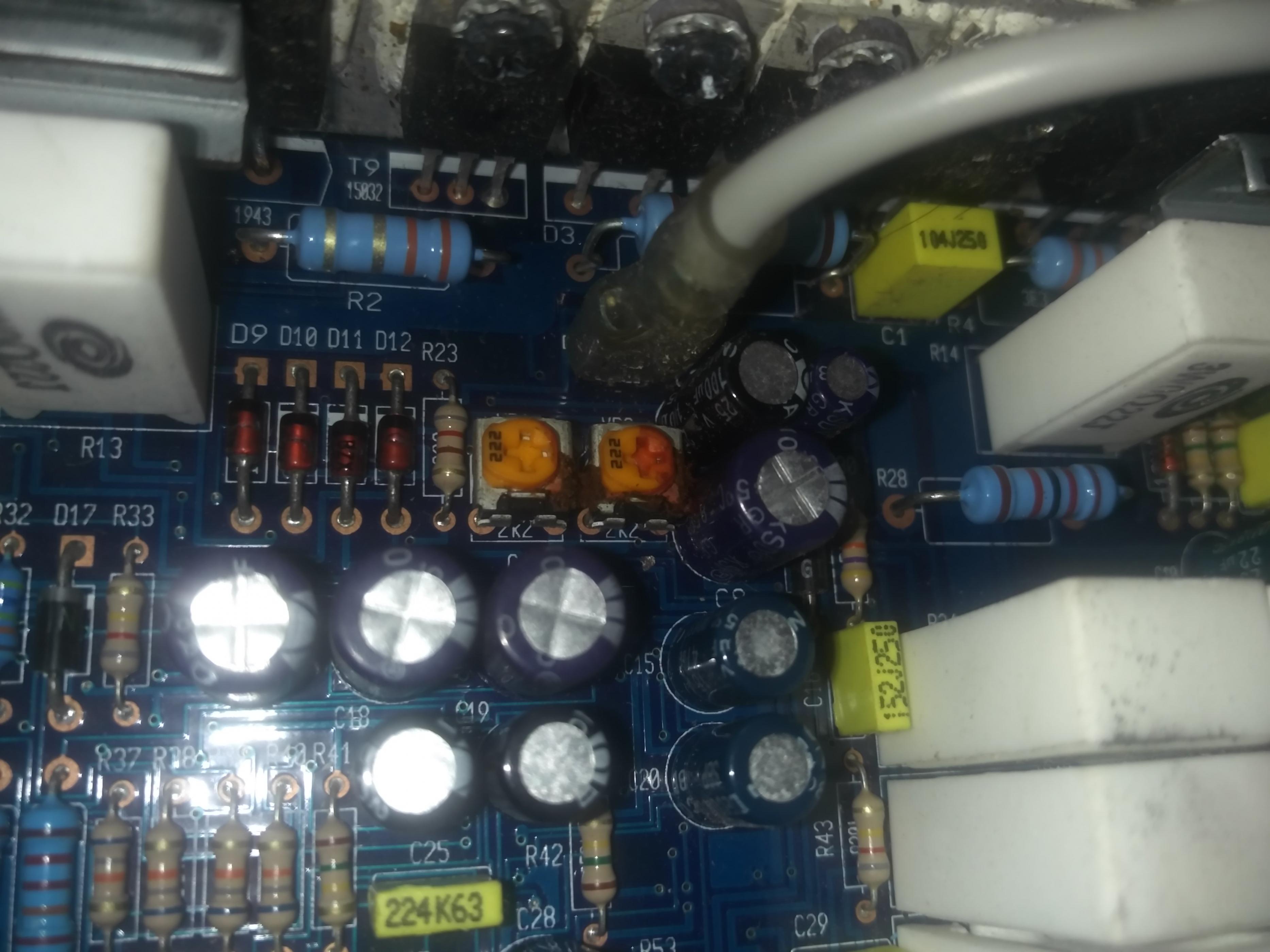

Good Day, I am trying to repair a semi-functional Behringer EP4000. Originally it was making a noise which I was able to get out by fiddling with the ribbon cable but it has another issue. On channel 2, the clip light starts to flicker when turning up the volume until it reaches a point where the light illuminates fully and the sound distorts until the audio signal is completely turned down. When the clip light lights full time the input voltage on the 4580 IC opamp drops from 15v down to 6-7v until the audio is completely turned down, then it jumps back up to 15v but only one one opamp. I don't know whether changing the zener diode at D10 will make a difference as the voltage drop can be measured there.

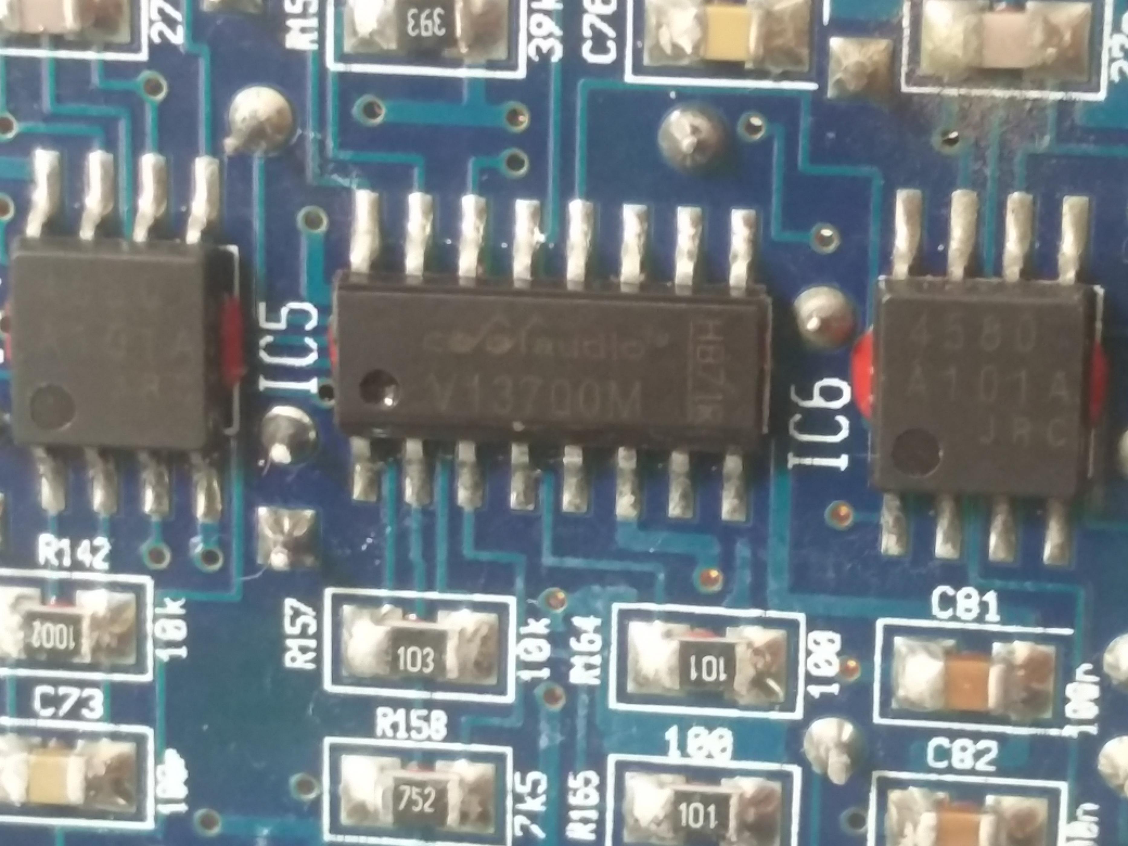

Channel 1 plays fine without the clip light coming on. I have checked all the output transistors and they measure out fine, and I also swapped out the JRC 4580 with no change to the problem. I have already fixed the ribbon cable problem and I don't know what to check next.

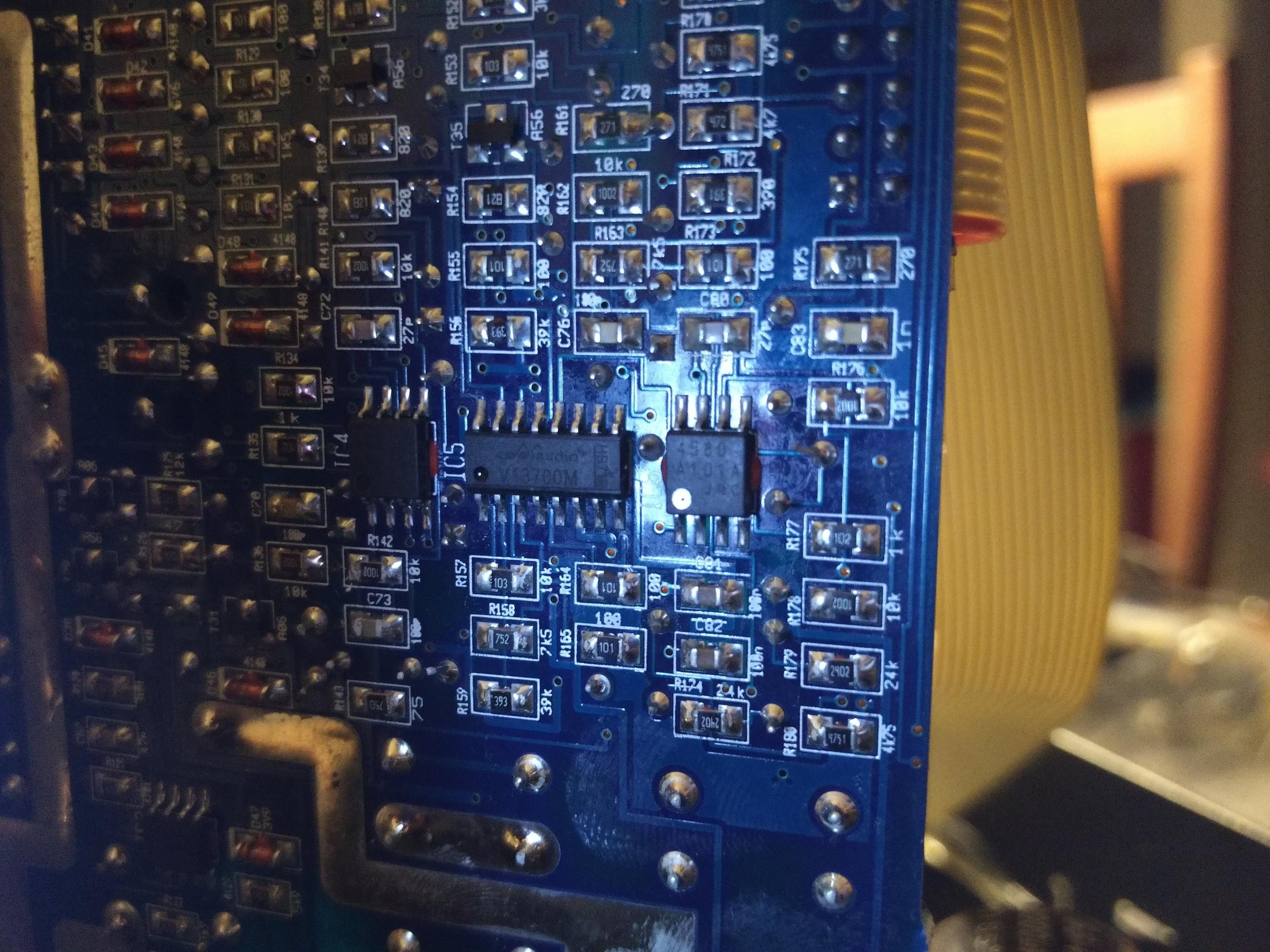

The IC and opamps are located on the underside of the circuit board. After digging around some, what happens now is that the +15v does not drop anymore but the - 15v is the one that drops now. I had switched around the 15v zener diodes on top of the board, and the 5.6v zener diodes on the bottom of the board. The +15v was dropping before, now it's the - 15v that is dropping. I have not found any defective components as I trace the troubled circuit.

So, You are telling us that only one op-amp fails connected to the same supply ? There must be a crack on the PCB or a bad via / solder.
The caps look to the untrained user like bypass caps on the op amp supply and are usually 100 or 220 uf electrolytics. Without them the op amp supply collapses if the output swings more than a few volts. It is a flying rail amp design, which also answers the above question as to why there is only one op amp on that supply. They are independent in each channel, including separate zener derived supplies.
If you measure between pins 4 and 8 of the dual op amps, (+ - 15v = 30v) I expect it stays stable and the ground is floating due to a bad connection or a burn up caused by an earthing issue on another piece of equipment taking out the ground link in the EP4000.
