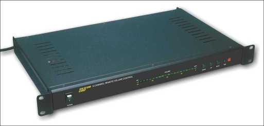

HI
The Behringer DCX2496 does seem to need a full
signal to get the most out of the unit.I came
across this 6 channel remote volume kit. It uses
LM1973n volume chips and then goes to TL072 output
buffers. The TL072 are easily updated with better
chips but if the LM1973Ns are ok it would make a
very neat solution to the DCX2496 volume issue.
Since it is a kit it pretty cheap at AUD$199.
It is a magazine design from Siicon Chip hear
in OZ. There may be some others that do
just the boards but here are URL about
the kit.
At the moment I am building a 24db/octave
3 way analogue crossover for my dipole panels.
Plan to migrate to the DSX and this 6 channel
volume control when funds become available.
regards
AnthonyPT
http://www.altronics.com.au/index.asp?area=item&id=K5600
http://www.siliconchip.com.au/cms/A_30608/article.html
http://www.decibelhifi.com.au/webcontent10.htm
