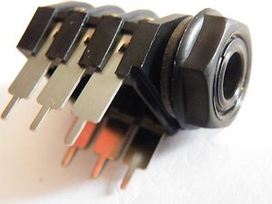

Agree and add: if the jacks are "free" and just join the PCB wirth wire,then almost any one will do, but if it's a PCB mount one, jack pins/legs must match holes in PCB, so it becomes more complex to find the exact one.
Supposing those are the popular "Cliff" type jacks ("what Marshall uses") , you can't fit a stereo one instead of the mono one, because the extra ring connections will not have a hole waiting for them.
I suggest you post a couple pictures of the original jacks, even if broken, and another showing the PCB solder side.
Cliff mono with wired lugs:
Cliff stereo with PCB lugs:
As you see, if replacement (stereo) jack has 6 legs but PCB only 4 holes .....
Now on the wired type, you can simply ignore what you don't need.
