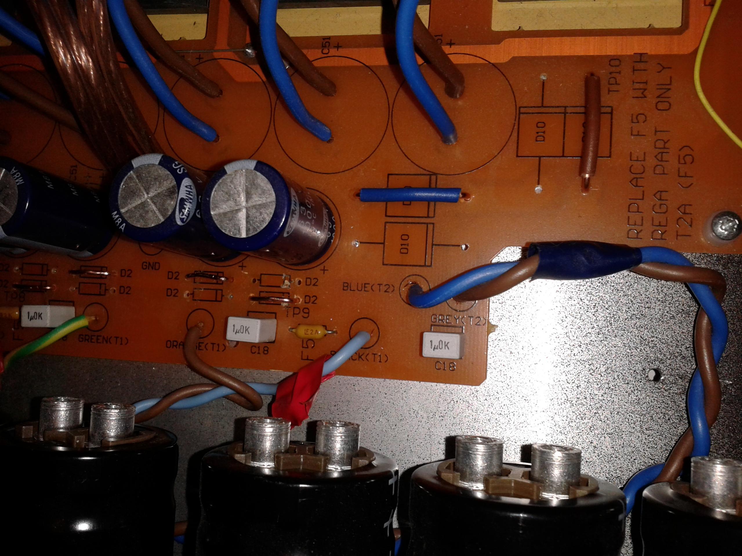

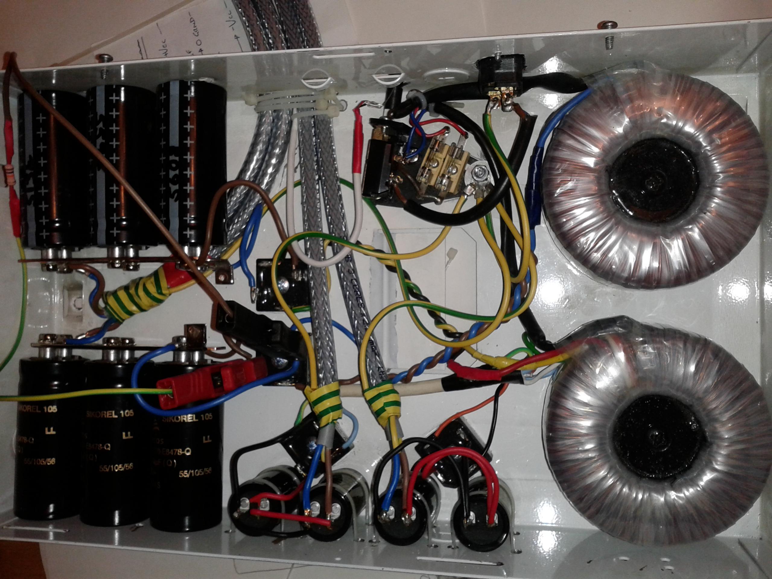

So you are saying the existing board has retained its bridge and reservoir caps.
Lets just be clear on the transformer... it is a two wire secondary that is used to generate a single rail DC supply on the main board. If so then yes, you can feed DC into the existing AC input of the bridge. The beauty of this is that the polarity doesn't matter, the bridge automatically corrects and outputs the correct polarity voltage. The disadvantage is that you now have two diode volt drops in the chain which slightly lower the DC supply by around 1.5 volts)
Another option is for you to connect the new DC supply across the existing bridges output terminals. This time polarity is important.
Many thanks for your replies 🙂
I have had my multimeter out and checked the board to I could remove the bridges and short them - thanks for the idea!
One pic is the original board with the bridges removed / shorted, other is of the diy psu - I hope there are no obvious balls ups :-o

I have no bulb tester (as of yet) only a multimeter. I get 58.8Vdc and 58.7Vdc on the two smaller smoothing cap circuits and 51.2Vdc on the two larger smoothing cap circuits. Which I guess have to be right as they are the original transformers.
Unfortunately when I do plug the psu unit in to the original board I still get one fuse blow (one fuse/transformer) I was hoping that problem may have been solved with the new psu experiment, but, I think the problem must be on the main board somewhere which is way beyond my understanding so will pop it in to a professional to resolve that issue for me, and will also ask for my psu to be given a quick once over ;-) we don't want anything too unsafe with curious kids and cats around ;-)
Many Thanks for your assistance, much appreciated 🙂
The voltages sound balanced and I guess nothing is smoking or getting hot and so yes, it sounds as though the PSU is at least basically OK.
A bulb tester is definitely the way forward because it would let you measure under the fault conditions and so get an idea of what was happening. If the main amp is faulty then that's going to be a whole different ball game in fault-finding and testing.
