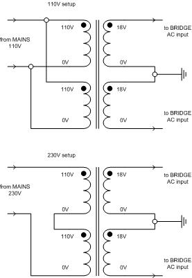

Hi, Nuuk
Your site is very informative, I'd only suggest more pics. However, I think I've found an error in the article "How do I wire up the transformer?".
"With dual secondaries (4 wires), two wires will supply the secondary voltage and two wires will supply the zero voltage. You will need to know which wire is which and this information should be supplied with the transformer. The two zero volt wires are joined together and connected to the zero volt rail. The other two wires are connected to the rectifier bridge."
I think the last two sentences should be:
"One secondary wire and one 0 wire are joined together and connected to the zero volt rail. The other secondary wire is connected to one bridge AC input and the other 0 wire is connected to the other bridge AC input."
Regards
Regards
Thanks Moamps, I got myself confused there! I'll make the changes to the site. Would it be OK to grab that circuit diagram - I'm getting rather bogged down doing all the graphics and I have a second GC to build for myself!
