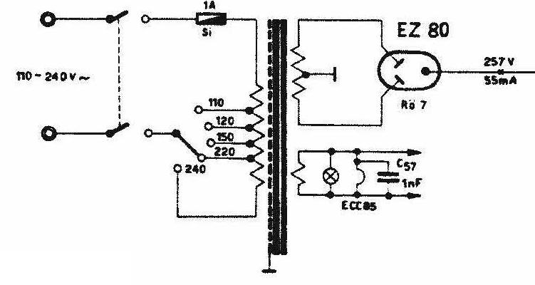

Im going to build my second tube amplifier !!
But there's one problem :
I'm using this circuit (http://nmwilliam.tripod.com/ecl82.html) but
i have bought a power supply with ez80 tube that is supporting 247V !!
What Resistor i have to use to set the voltage down ??
Is it enough when i take 4 x 62kohm with 0,6W ??
Should i use capacitors ??
Thanks !!

Could you post the schema of your Power supply ?
Yves.

emil_86 said:Here is it ! but i have messure the voltage and it is 247 Volt!!!
I don't doubt !
Wanted to have a look at the schemo before making any suggestion !
I can't see it here, is it the one drawn in the referenced link ?
Anyway, do you measure voltage with or without load ?
Each amp will probably consume some 30 to 40 mA.
Nevertheless, there is no risk to try, at least for few minutes, the time to take voltage while working.
Yves.
emil,
i built the same project, and my power supply is almost 300v.
I have tried using 240v (two identical transformer back to back) I didnt like the 'thin' sound i get. so i think yours is just fine.
If you really want to lower it, 1.5k resistor 25w to replace the (100R 5w) should do the trick.
But i think within <250v is fine. It runs hotter but it sounds richer

Morse's 6BM8/ECL82 thread
http://www.diyaudio.com/forums/showthread.php?s=&threadid=14694&highlight=
His has 240 V at the OPT
dave
dave
