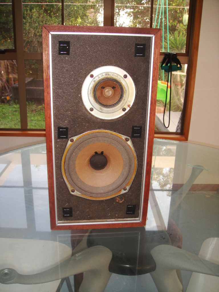

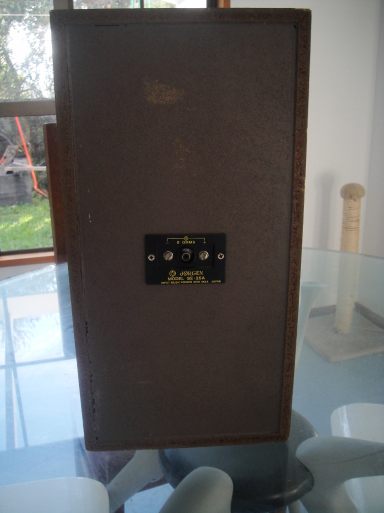

Anyway I found these old Japanese AMI Jorgen SE-25A bookshelf speakers on the side of the road. I want to use these as my monitors for my low budget studio. Obviously they won't be as good as proper monitors, but they should be better than nothing. I am thinking that as they are old, perhaps the manufactures didn't try to colour the sound too much maybe?!
I pulled the drivers out of the boxes as I was painting the front of the boxes and I noticed that whilst the tweeter has a 3.3 uf capacitor on it, there is no inductor on the woofer. I thought it might be better to have an inductor on the woofer. The woofers seem to be 5" and the tweeters seem to be 2"
The Woofers have 481121 E written on them and the tweeters have TWEETER 8Ω 0726Aa Japan 8N22D on them. I looked up on google and there was nothing came up.
Would I get a better sound for mixing with some inductors? I don't have much money to spend as I'm a stay at home father with two children, so there is not much of a budget for this.

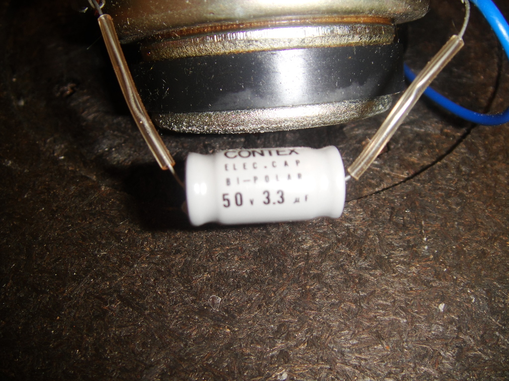

Is that white cap in // with the tweeter on the pictures ?
I have had an old bookshelf with just a serie cap on the tweeter a 8" + a paper tweet (2.7 uF cap). Sounded nice.

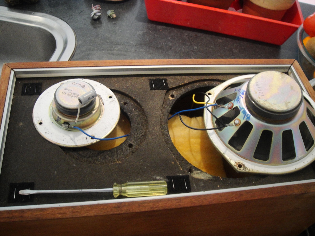

Hi, I have got most of the dents out of both tweeters using just a drinking straw and my lungs. I didn't want to use the vacuum cleaner because the paper is so delicate that it would tear the paper.
It's got a 3.3 uf capacitor on the tweeter now. The tweeters are a little unusual though in that they have three terminals on them, so not exactly sure what the internal wiring is doing.
They don't sound too bad, not very exciting, which leads me to believe the frequency response is relatively flat.

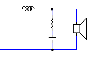

If you have a DMM, disconnect the wires to the woofer and measure DCR. For a 8 ohm speaker you should get about 6 ohm.
The 8 ohm woofer impedance at the xo frequency of 6kHz would be around 16 ohm at a stab which would require an inductor around 0.42mH. You can try that and if you get a hole in the middle, then unwind half a layer and try again. Repeat if necessary and at a guess you may end up with around 0.33mH.
Use an air core inductor (for speakers) with 1mm wire. I don't know you location but you can get these at Speakerbug, Wagner, Soundlabs, Speakerbits.

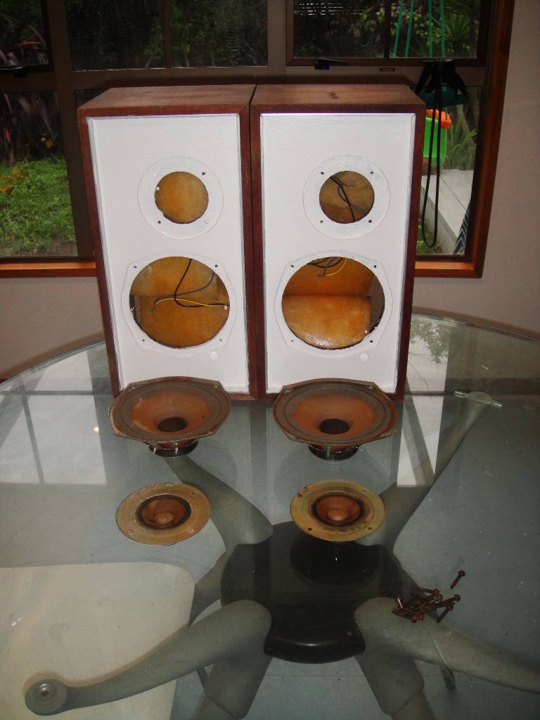

I've painted the boxes and removed most of the dents from the tweeters, so just need to decide if the circuitry can be improved.
I have listened to them, I just had the drivers out today and was surprised that there wasn't any inductors. I'll do those tests suggested and report back.

Here is the current state.

I think you better stay off an inductor as this will only create phase problems. The small values you mention above will not affect the freq-curve much anyway. Just get a better polyprop speaker-capacitor with the same value as the original from an electronics shop and leave it as that.

A diy coil can range from #24 to #18 AWG. The greater the inductance required, the thicker the wire you should use in order to cut down DC resistance. For example, for 0.25mH use #24, for 2.5mH use #18.Any idea on the minimum thickness wire I should use?
P.S. I'm with diyiggy. Let that mid/woofer run free. No inductor and a 3.3uF polypropylene capacitor on the tweeter. Splash that sound around! 🙂

I have looked at a couple of circuit boards which I have lying around to see if there are any I can scavenge, but they all are much smaller value, in the yellow box type of capacitor. I'll have to look at some other scrap boards to see if there is anything.

Nah. And I will paraphrase my guru here when it comes about filters (AllenB) : bipolar lytics are just fine and do the job with speakers filters. A film cap has zero interest in your project but the precision of the capacitance value... which you really don't mind here, Film caps are just a plus for expensive filter and you are in the dimunishing return...
Though not sure speakers bipolar lytics cost less though than polyester caps you linked and where you live!
So two way, you find 4 x 6.8 uF /50V like the green Nichicon Muse or Elna Silmic II to make bipolars like I explain, hopping it will cost you not more than 5 bucks at the local shop... but dunno about choice about audio caps in mortar local shop. Or better if yu have 4 from your work shop or an old device... free and it should not arm as the tweeters had center dome hard return to life.
The caps the shop want to sell are Polyester, it's ok and stand between lytics and polypropylene which are not costing much but audio branded caps.
Think money best spent in new tweeters as the Visaton but it's another project. And Indeed parts seems to be costy where you live...

Do not use the Jaycar
3.3uF 100V Electrolytic Crossover Capacitor | Jaycar Electronics New Zealand
OR these
1.5uF 250V Metallised Polypropylene Crossover Capacitor | Jaycar Electronics New Zealand
The green ones will work in subwoofers but higher than that they sound awful and I do not have golden or even silver ears. The yellow ones are absolute crap for music
