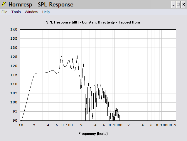

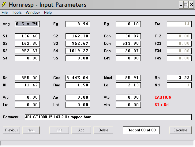

I'm going to have to disagree with J's assertions. Car audio subwoofers tend to have what it takes to make a sub-horn, so assuming the room's construction can handle the pressure, it looks like it can do DD reference on just a few watts without exceeding Xmax down to 15 Hz in a corner loaded pipe horn. Factor in a bit of room/corner loading and it ought to please all but the most hard core HT aficionados. The trade-off of course is size at 10+ ft^3:
GM
You are most likely right about the horn, but I was operating on the assumption that someone who was asking basic Q's about specs would not want to tackle a horn project, or have the experience and or equipment to do so.
10ft^3😱
It's a simple conic expansion/build as you can see from folk's pics in the tapped horn thread, so just some staggered straight boards and FWIW I've noticed over the years that 'newbies' are just as likely to tackle such 'brutes' as a seasoned DIYer. Yeah, 10 ft^3 is big if you live in a trailer or small efficiency apt., but a pipe horn can fold up vertically to reduce its footprint considerably.
GM
