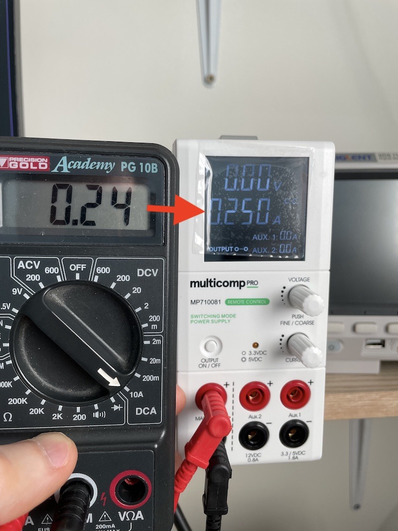

It is both pretty, offers some really nice features .. but .. it's flawed in a big way for beginners.
Let's address the elephant in the room. It's minimum current limit is 250mA not 20mA not 1mA but 250mA. I mean - the device and form factor has market dominator written all over it, except for one small minor detail.. the daft current limit. That means blown LEDs or small devices for beginners. The entire MP71000xx range (including the 20V one) has a daft current limit minimum of 250mA..
My gut feeling is that the SMPS supply they use probably will have problems supplying current that low, either the switching drops into audible range or the components are large enough to cope with low rate or infrequent switching.

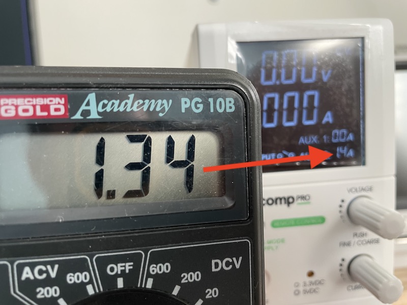

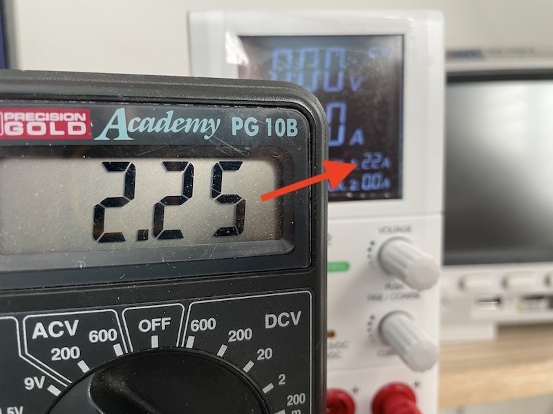

I've tested the voltages and current with two multimeters and the output vs displayed voltage/current seems spot on. Although I have noted to seems to take a short second to home in on the voltage. A good example is if you alter the voltage, there seems to be three display updates as the voltage drops to the set value.

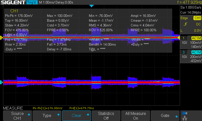

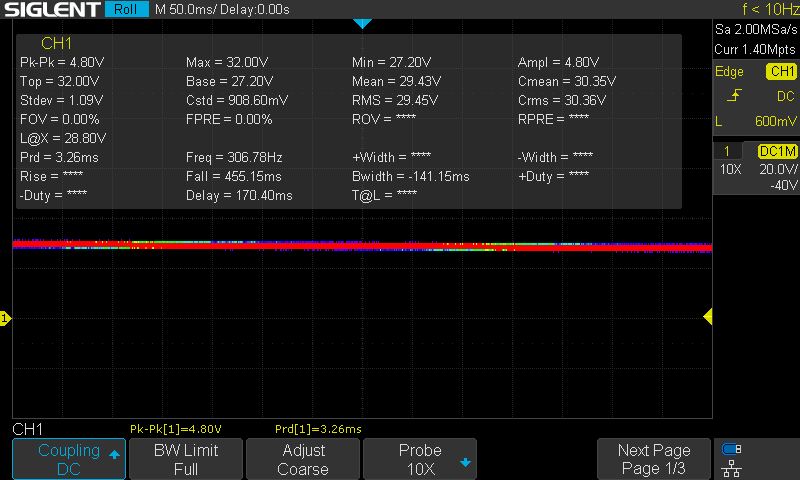

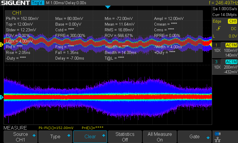

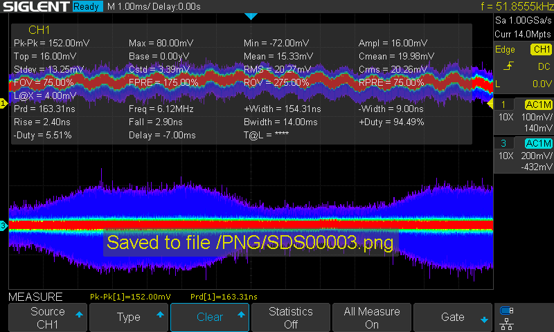

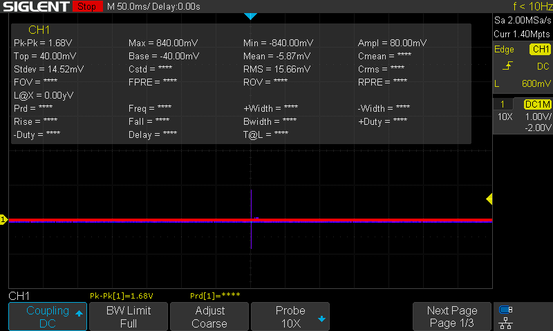

AC coupled. Top trace is the positive, the bottom trace is the negative grounded via scope ground lead.
1. No power
2. Powered up but no power enable (note voltage range increase):
3 - connect a 100W 8 ohm resistor load
3.a. Enabled 20V unlimited current (1.8A) - reads 10V 1.2A (no range changes)
3.b. Enabled 40V unlimited current (1.8A) - reads 14.45V 1.8A = 25W.. max current limit
3.c. Enabled 60V unlimited current (1.8A) - reads 14.45V 1.8A = 25W.. max current limit. Had a bit of a large AC wobble before settling down:
3.c. Enabled 10V 1.2A load limit set (as 10/8=1.2A) we should see 10V..
10V but then dropped a little to 9.79V at 1.2A, the multimeter shows 9.6V, changing the multimeter around this shows 1.9A too.
That is clear and seems common is that although the power supply is only outputting a small amount of noise through the positive, there is a fair amount of noise coming out from either the earth or the negative pin (I assume the earth which then shows up through the scope ground clip).
So it seems capable, although the 1.8A limit means you don't have a clear 60V into anything (ohms law), it does seem well behaved so far in terms of noise.
Next up switch on/enable on/off using the scope and a rolling trace.

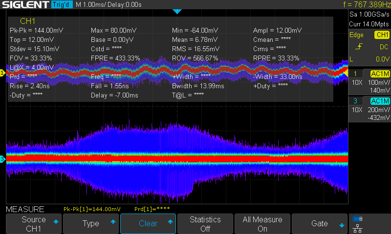

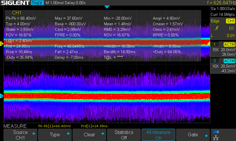

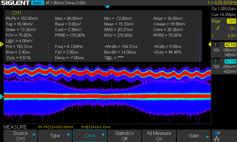

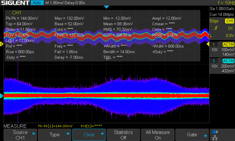

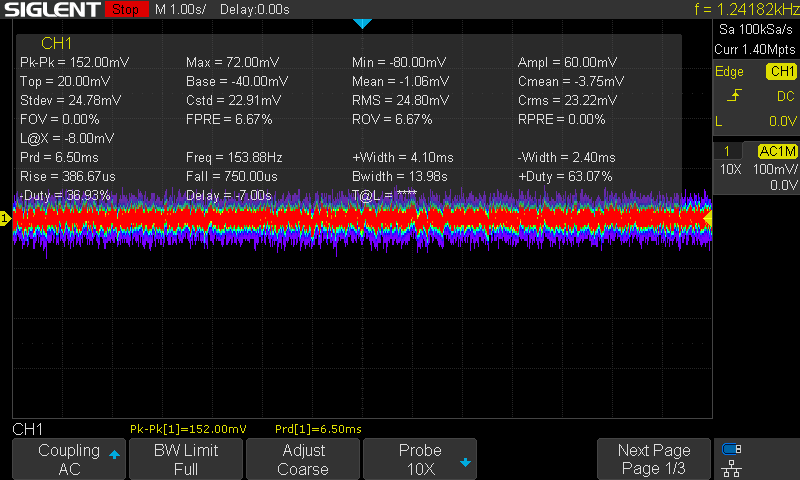

So first just a single channel on positive rolling trace showing noise level when output enabled. The scope is AC coupled.

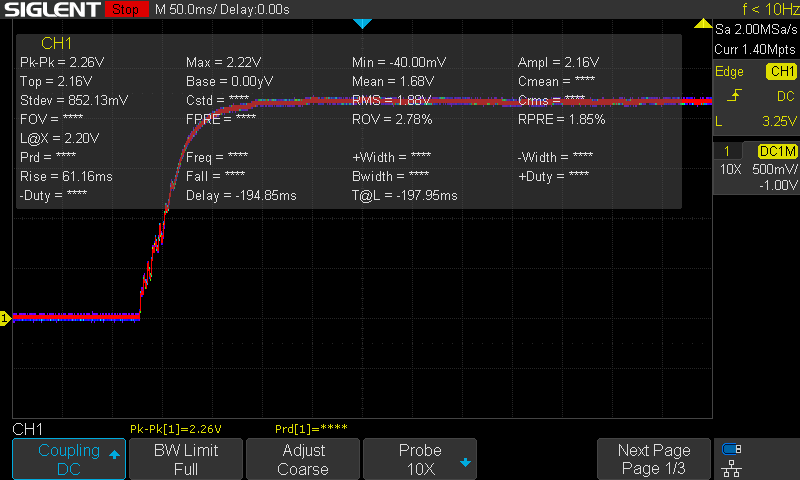

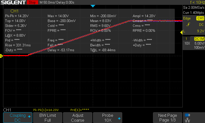

Next up a full current rise with DC rolling trace with a trigger set to pick up the rise. 14V at 1.8A across the 8R load:
You can see the time it takes to switch on, this also happens when you current limit at 250mA across a 8R load:

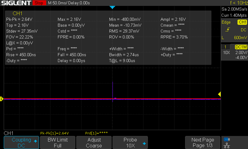

Next up - is a test to check if the multicomp sends power through the output on mains switch. A rolling trace with a 8R load. The supply has had chance to discharge before power on - the short answer is there's a little spike:
Next up is the ON(enabled, 1A limit)-OFF-ON and a slightly larger spike appeared:
Note those are with a 8R load present, zooming in shows two close spikes at 2.16V. These occur just as the firmware version is displayed:

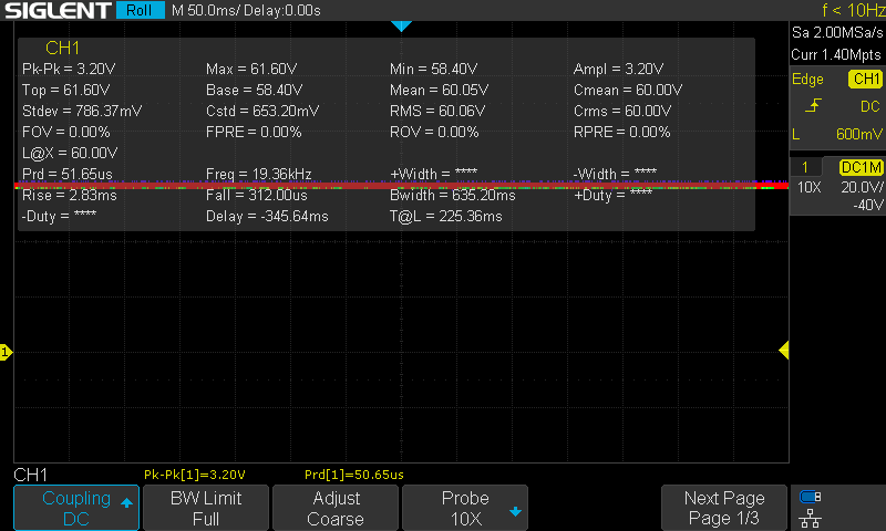

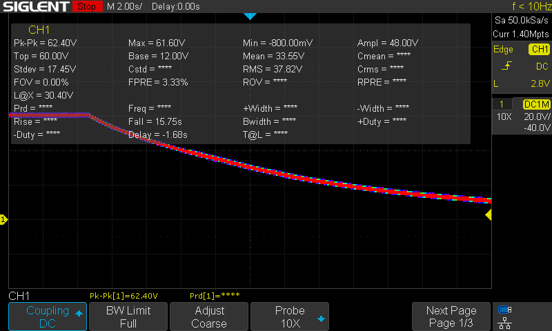

Without a load, set to 60V - turned enabled shows 60V on the scope:
Then mains power switch off and you can see a slow discharge through the power ports:
A longer rolling curve confirms this! So NEVER assume a powered off supply is not providing power! Classic capacitor discharge. As this is not connected to the 8R load, this is a bleed off:

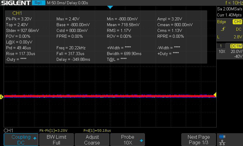

Next a 60V set, the PSU is discharged and powered on - it appears there's no 60V spike but interestingly the voltage reads 0.63V without an output enabled.. showing an electrolytic has started to climb back up.. but the scope shows 630mV mean on the power supply rails without the enable on. Perhaps the enablement mosfet used to switch leaks over 1/2 a volt when the power is set to 60V.
I'm not going to try a 60V enabled ON-OFF-ON as it's clear that the supply will still be discharging through bleed off as we've seen already.

So no other gremlins to report other than the expected SMPS noise. It should be noted that these supplies don't follow a current limit that takes into account the voltage. Hence you get 1.8A limit regardless if it's 1V or 60V (into a 36.6R load would give 1.6A - it's quoted max) and that 100W into a 1R load doesn't result in a 10A at 10V..

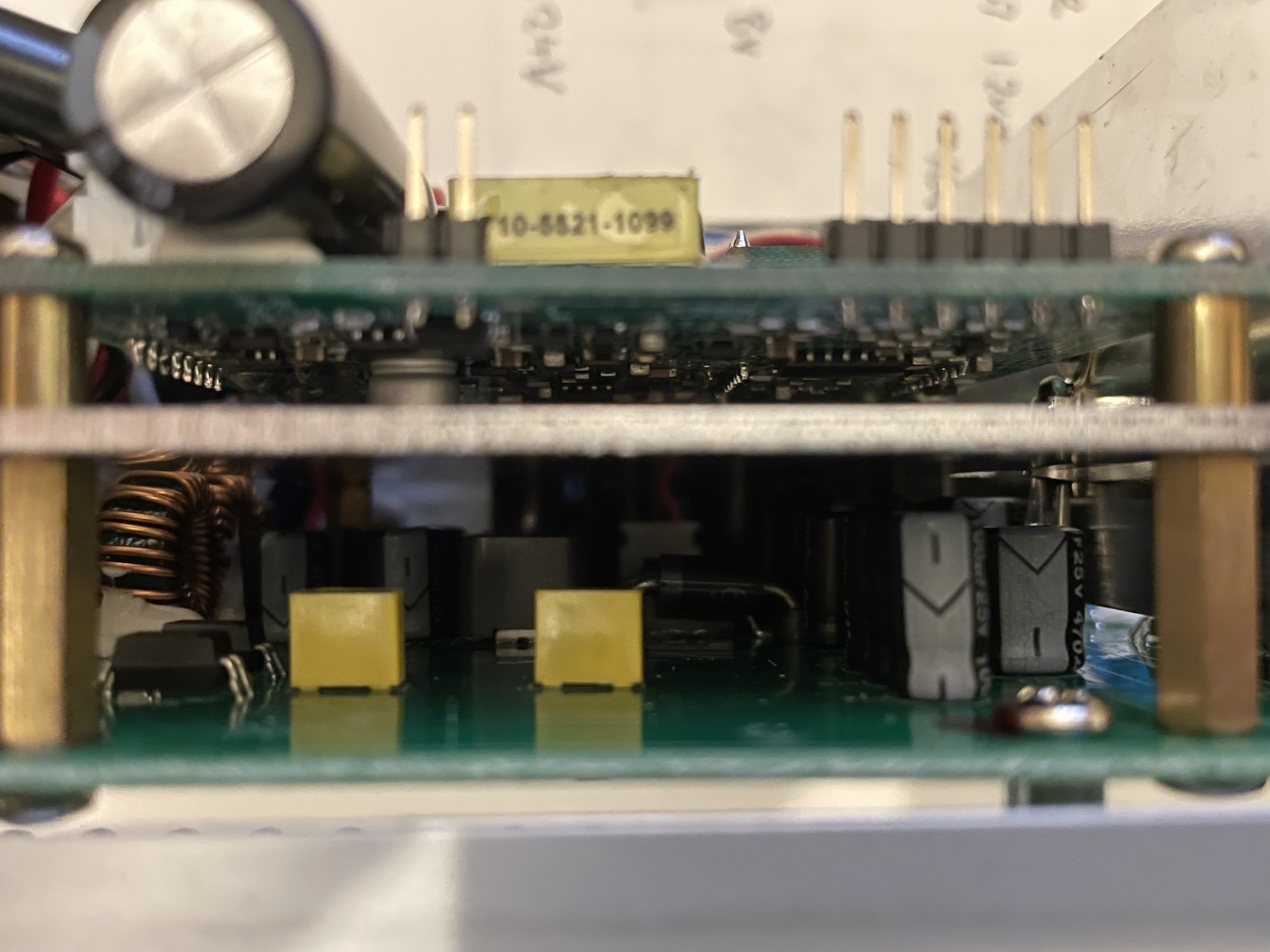

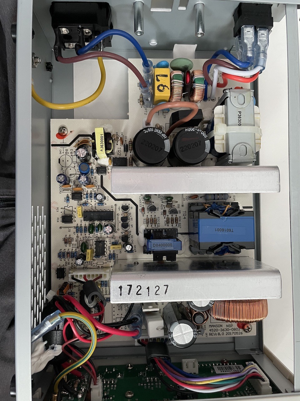

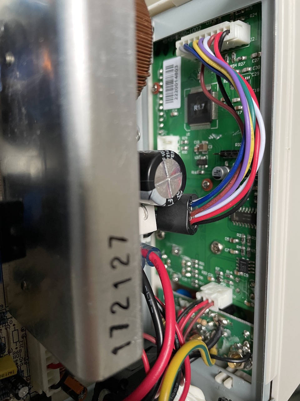

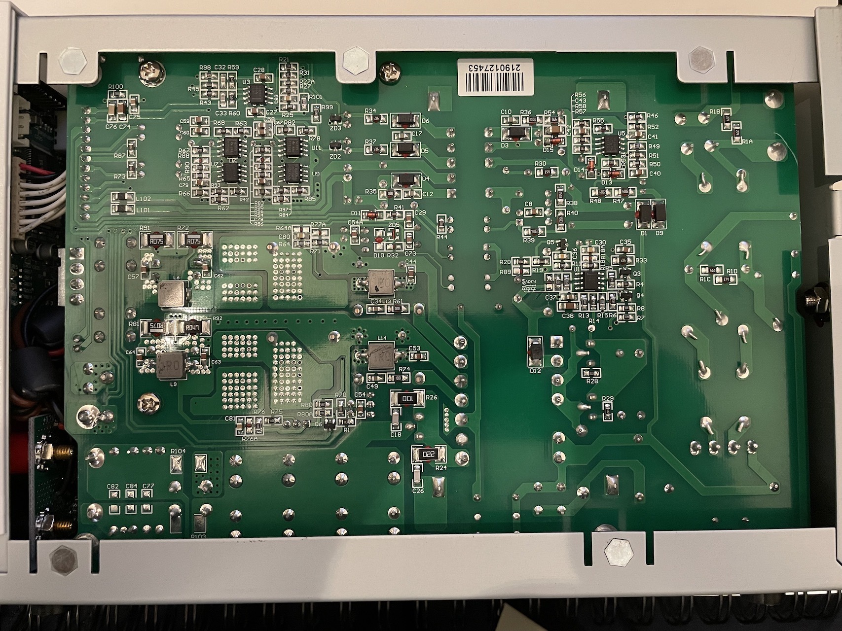

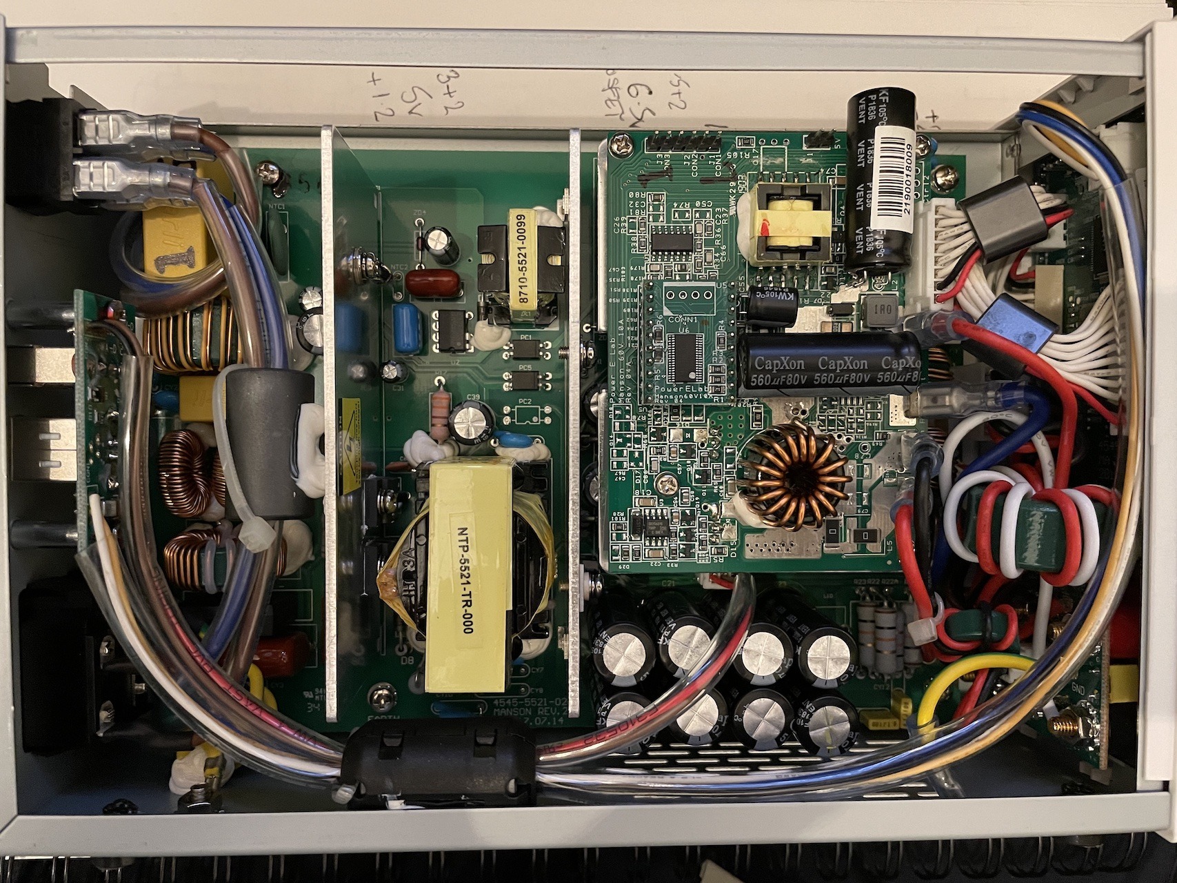

Channelling my best Davey "Don't switch it on, take it apart!"
It's interesting that the "Engine" above is rated for 60V 10A...
The front panel:

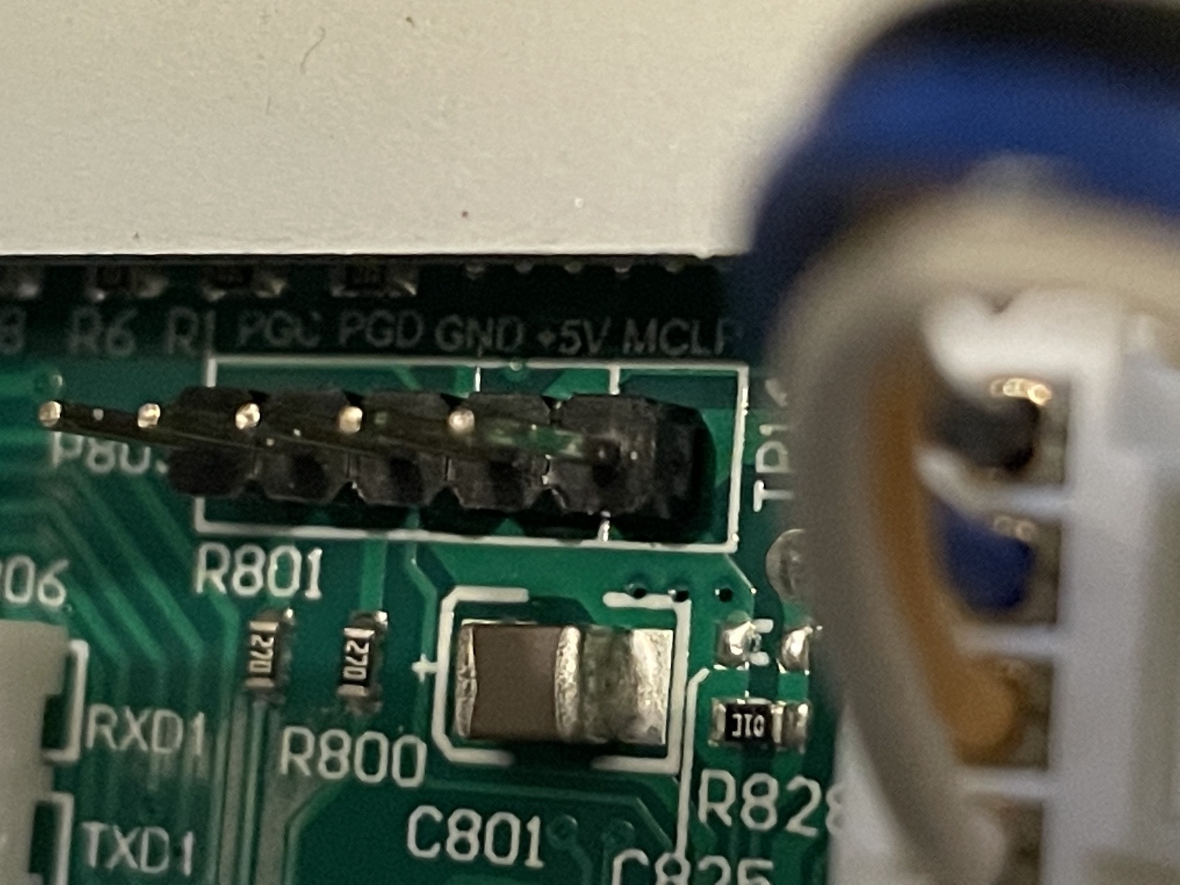

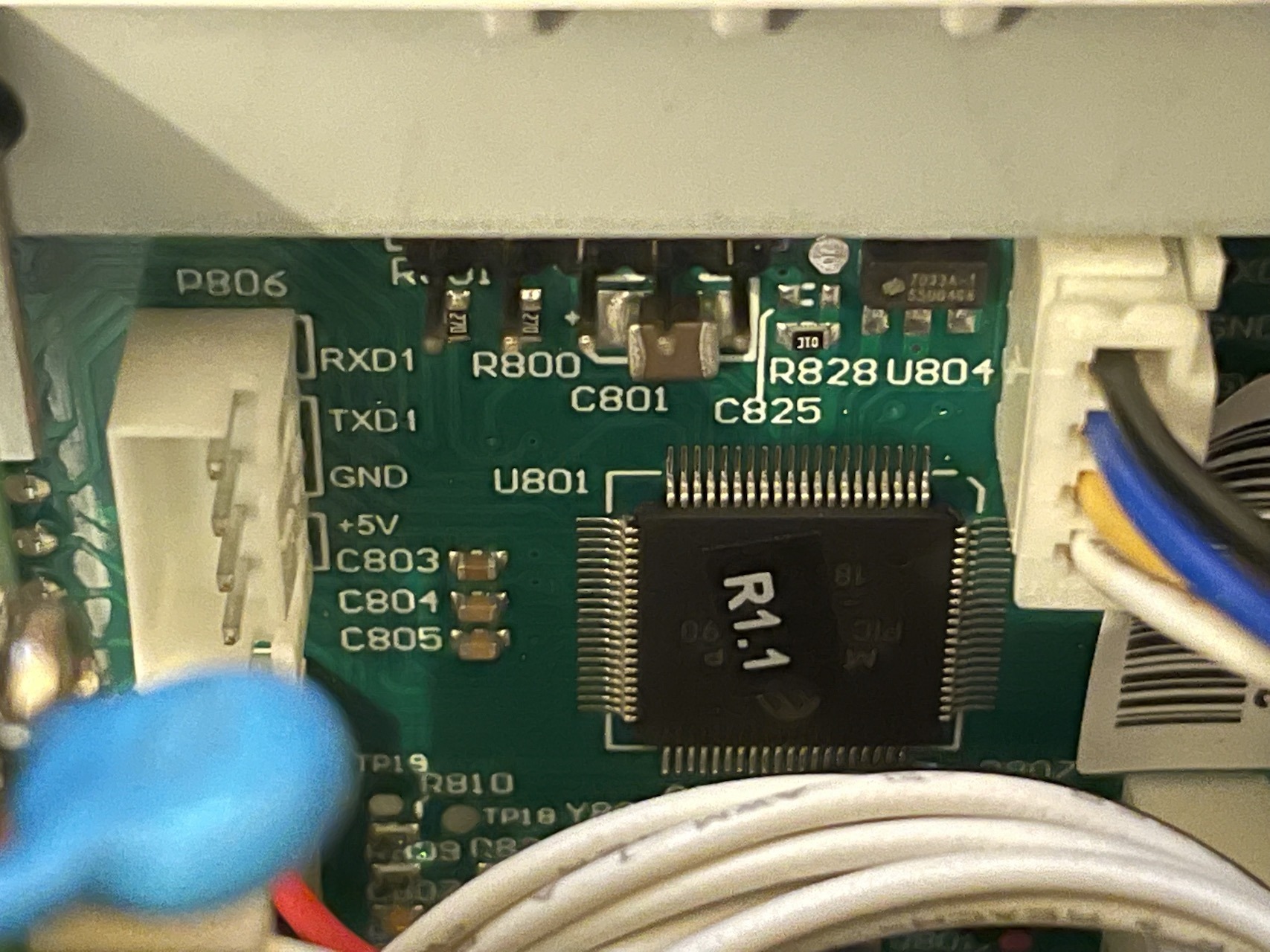

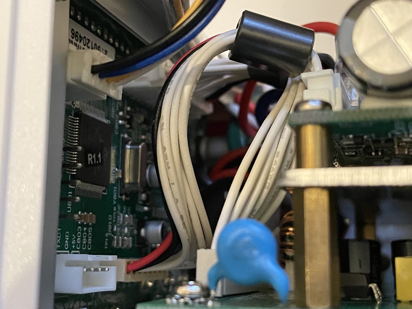

Interesting it has a TX/RX pair - it already has one of these to the left (with the blue/yellow/white/black) labeled TX/RX that connects to the back USB board.
Hidden at the top is this - this is a PIC programming port allowing you to read/write the chip including downloading the code from FLASH:
All the screen printing makes it easy to see what is going on - including the large white connector on the main board that tells you the purpose of each of the wires going to front display/control board.
Apart from the CrapXOn (CapXOn) caps which are low quality, the design seems relatively decent. I suspect the Capri X caps are also the favoured Chinese low cost producer as it seems to be prevalent on most Chinese produced boards. However the amount of tech packed in for the price I'm not surprised.
It looks like you get some components (engine) shared with many of the other Manson line however the components are lower quality/lower specced. The amount of inductors to keep it all clean was quite surprising. They certainly have packed it in. Now if only I knew why they set a lower limit of 250mA it may be able to reverse engineer and reprogram the microcontroller for low minimum limit..
Hmmm "Programmable" isn't entirely correct. Looking at the SCPI commands in the operating manual and trying them out:
This shows you can get/set the functions over the USB port using a simple 9600 baud serial terminal over USB. The PIC on the front panel then implements your commands. Unfortunately you can't tell it to set a smaller current limit over USB unfortunately as the PIC controller knows it's 250mA coded minimum.
So I suspect the windows CD program provides the control and UI then behind the scenes it schedules SCPI commands immediately as time progresses on the computer. There's no programmable preset memories on this model (although the PIC microcontroller can do that). You could do the same with python and pySerial.
The PowerEngine seems to be components designed by a small HK design org, PowerELab, that creates SMPS components that can be plugged together like lego by customers. Hence I think the inside is modular with the other Manson range. When you look at this model half the components aren't populated on the engine PCB.
It uses a differential pair across a current sense resistor for the output current and provides that to the ADC on the PIC controller.
I suspect the engine is a simple implementation just made to look complex by the boards but the components aren't populated. It looks like a PFC into a DC link then it has a set of buck converters to drop from DC to DC for final regulation.
Typically buck etc shouldn't have problems providing a minimum current level below 250mA, after all the power supply can be operated without load on the outputs which implies no load thus no current and so the PWM would be at the minims or in sleep.

This looks older and the insides also confirm this is an older/simpler design. It uses the same switching dual push-pull mosfet/half bridge configuration, the same microchip controller sits on the front board but the boards are different, specifically on the output voltage control. It looks like the Tenma uses a voltage regulator but the multicomp uses a more complex design.
The 150mA limiting is better than the multicomp but not able to dial down to 10mA for example.
The voltages seem good, along with the current limiting. It has a different noise profile on the scope but they both have noise on the output.

This is where I noted that the multicomp failed to provide a current readout whereas the tenma read within 1.5mA compared to the DMM setup as an independent current meter. The multicomp was outputting current but not displaying it. It may be the multi comp can only read to 10mA vs the tenma that reads to ~1mA.
Perhaps the floating configuration (note supplies are close to 0V on their neg terminal but they could be sat slightly (ie mV) below 0V.
1. Regulator testing from 1 to 60V.
This worked well allowing testing of the LT3080 from 1 to 32Vdc before adding the maida. Components to test up to 60Vdc with an appropriate load showing no issues before migrating the maida regulator to the unregulated 177Vdc PSU.
2. Testing hybrid circlotron BJT stability.
Complex with the two supplies floating on opposite sides of the load - essentially providing an adjustable 1-32Vdc supply the the BJTs. The two HV 177Vdc for the tube then sits on top of the LV supplies for the tube triode which sees 177+22 or 32V. The entire lot floats around the single ground point.
