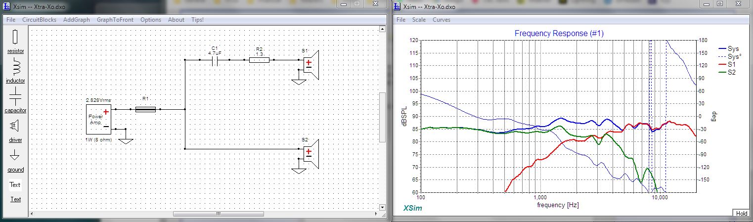

If you're just interested in getting half decent sound from a one time project, you can work with the driver's specs to build a box of the volume recommended and then use an extremely simple crossover like the one in the first thumbnail. 2 parts, not bad frequency response, within 6db of the ideal straight line.

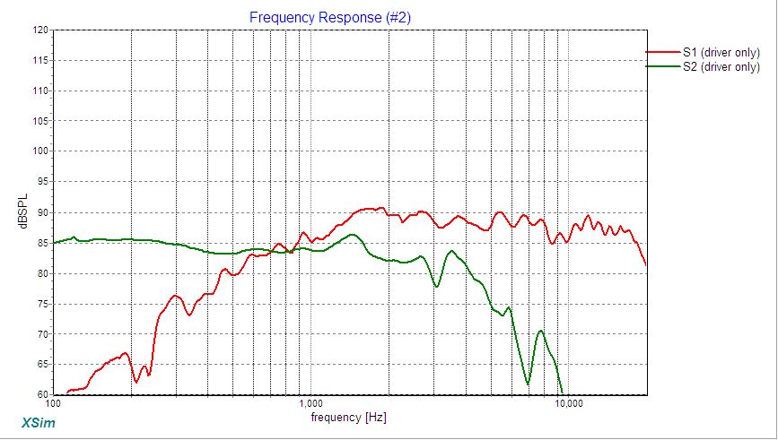

Okay assuming you want to get into this just a bit more first look at the plots of your drivers in the second thumbnail. You can see that on their own, they're pretty well behaved, so not much needs to be done to get them playing well together. Thus you should expect a fairly simple crossover design.

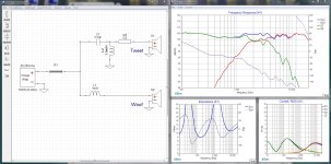

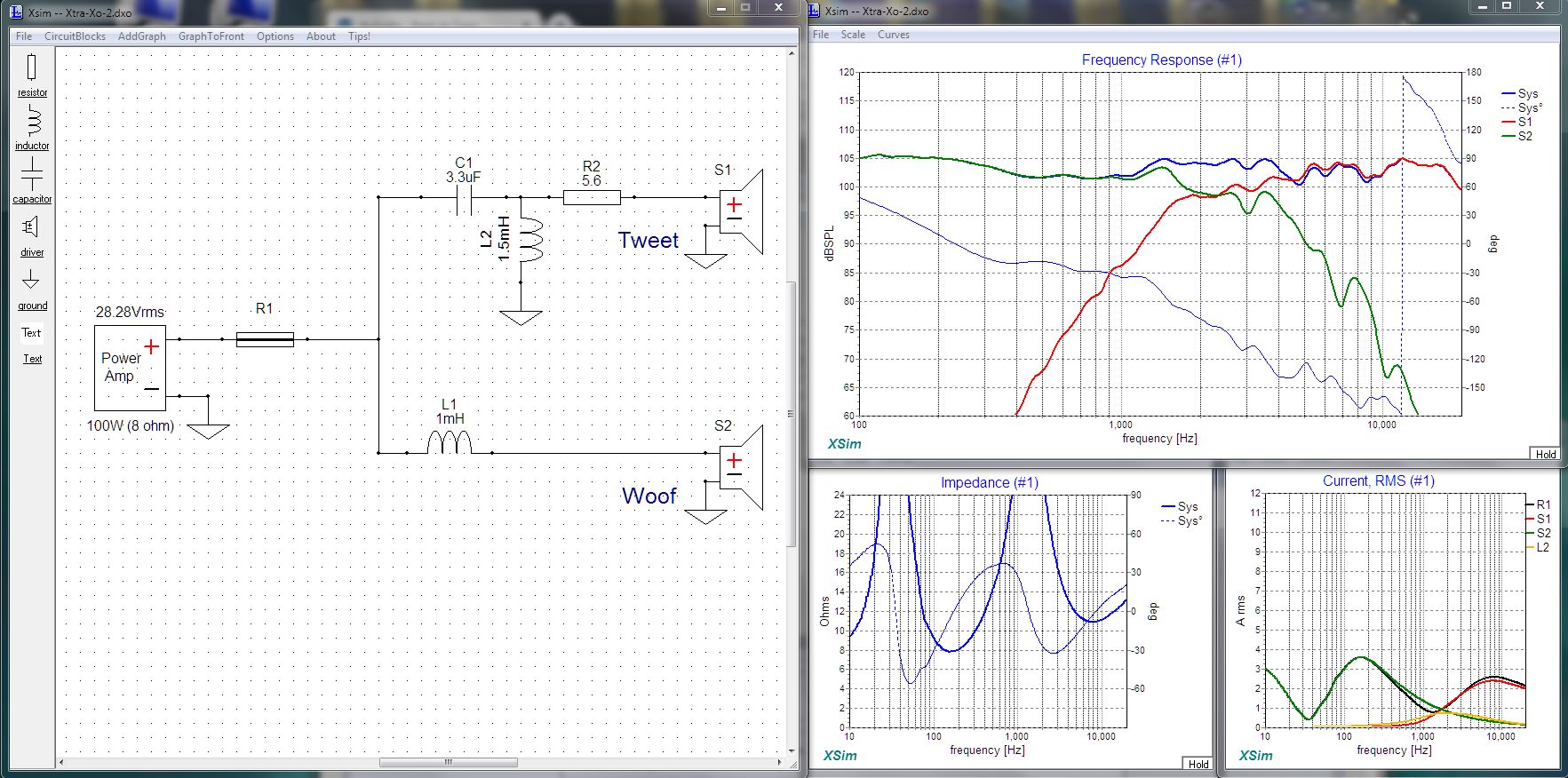

The third thumbnail shows a little bit more advanced crossover that will do a respectable job for you. Before building you should spend a bit of time examining the circuit to understand what does what and why each part is there.
I've also included the .DXO files from XSim so you can load it up on your system and work with it.
