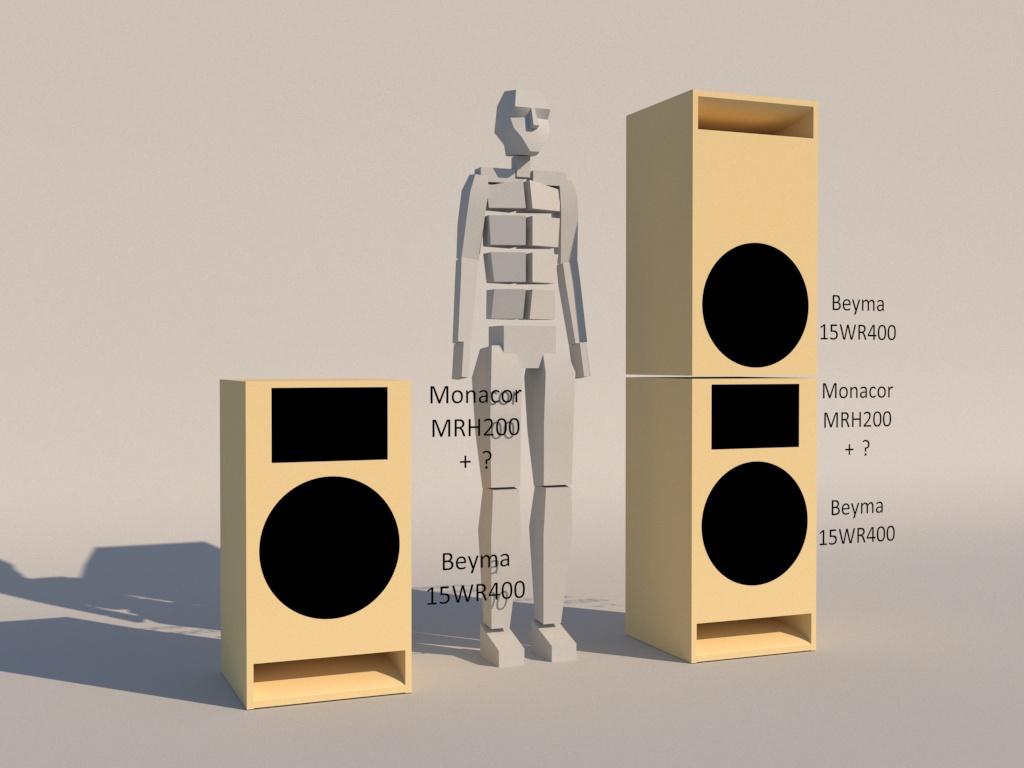

The goal is to develop a well-sounding loudspeaker that can be outside from spring till autumn (rain protected in middle Europe). Originally I planed 12 '', but then I tends to 15 ''.
After first sketches it was clear, that the 15 '' variant would be too heavy as a single box (every now and then it should be transported). Of course, they should be (spray) waterproof.
After 2 weeks of research and calculations, 2 driver families were short-listed. The SP12/302PA or SP15/402PA from Monacor, or the Beyma WR series. With both manufacturers I already had good experiences - price performance is right for both. In the end I favor the Beyma chassis.
the 15 '' variant:
TMT assembly is now clear: Beyma 15WR400.
Now I would like to ask you to an adequate high / midrange. My current thoughts are the combination of the MRH200 Horn with the Celestion CDX1-1747 driver. What do you all mean? Alternatives? Ideas?

For use with one or two 15"s, I'd look for a decent 1.4" or 2" exit (3" diaphragm) compression driver.
1" drivers don't get low enough to meet a 15" properly.

But an 1.4" or 2" driver with 3" VC will also be quite costly.
Perhaps you could first tell a bit more about your use, like how many people will be listening, how loud it needs to be and what amplifier you'll be using.

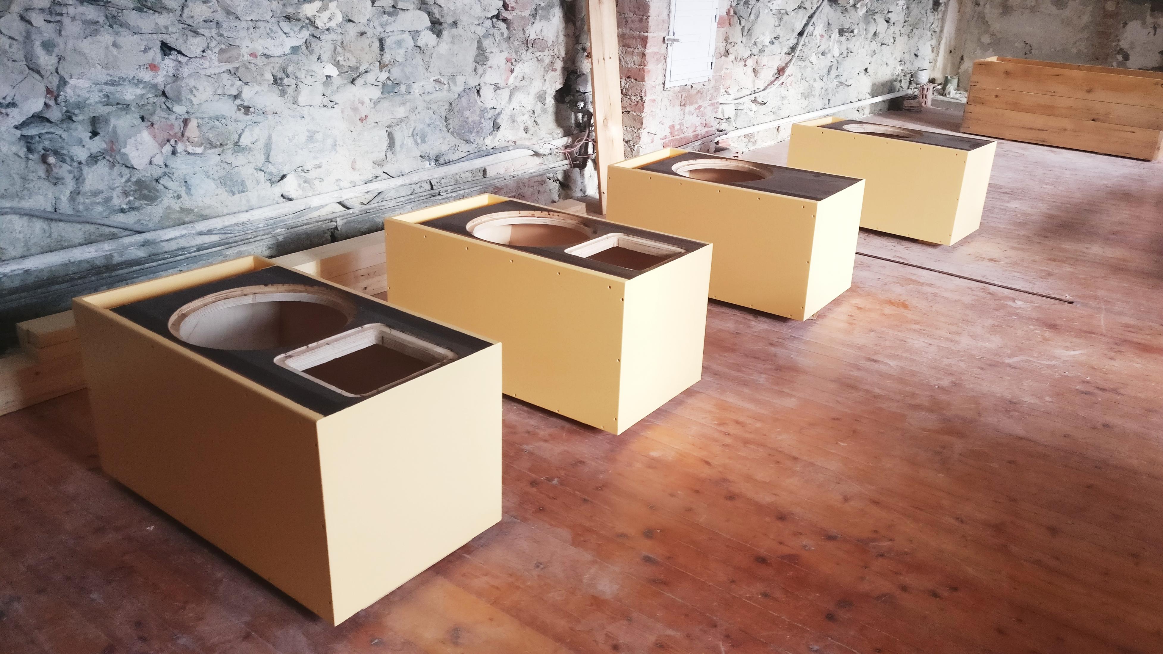

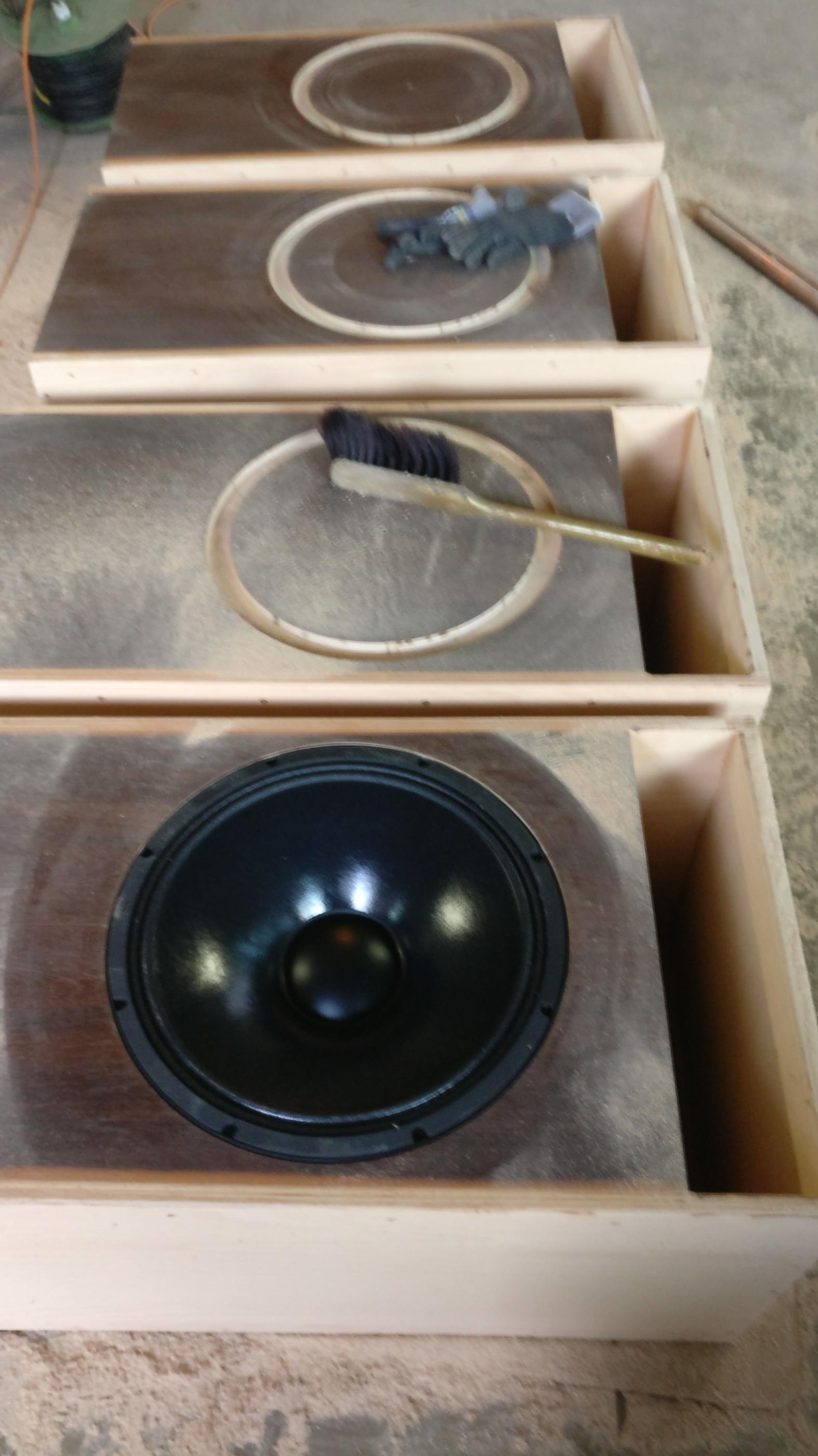

I live a bit outside of vienna, so, thats not a problem. Sadly I had a lot of other stuff to do, so the project is still not finished. At the moment I am doing the painting job *boring*

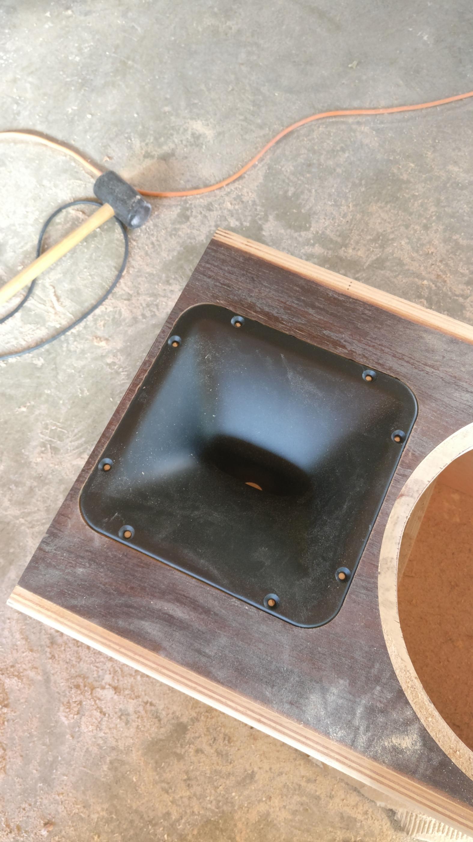

I guess, you are right 🙄 over time, I changed some things. The tweeter is now from Obertone 1.4'' (just want to try them) and the horn from 18th sound.

You are right. Painting is nearly done. Now connectors and protection corners needs to be mounted. Then measurements starts.
After long planing and a visit at Oberton in Plovdiv, Bulgaria, I decided to use a 1,4'' driver from them. So bass from Beyma, HT driver from Oberton and the horn from eighteensound. I think a nice European collection.
