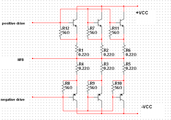

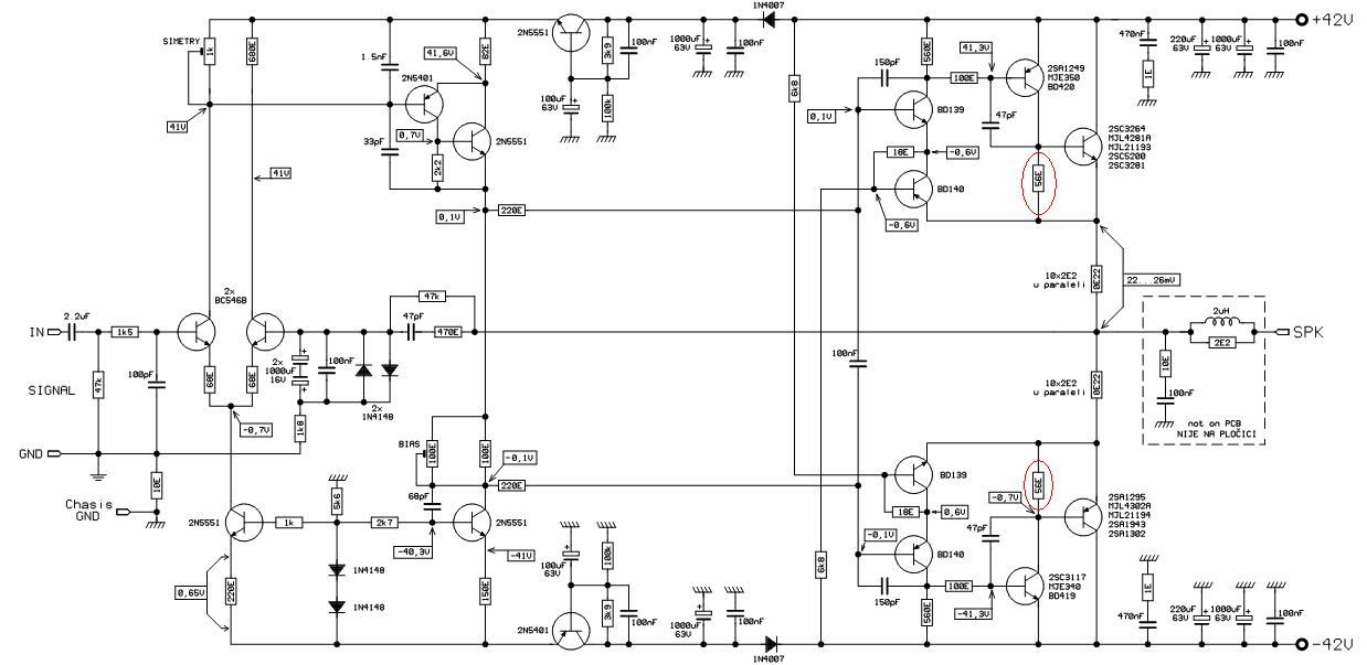

i going to make this amp very soon , will design my own boards .... all i want is that i should be able 2 play load as low as 2E... as this amp is specified for 8E i think it needs more output transistors to be able to play 2E loads ..... i could have done it on my own but there r a few problem .....
1. what type of output configuration does this amp have?????
2. what is the function of 56E resistor place from base to emitter of the o/p transistors????
3. how can I add more output transistor ????????
I HAVE POSTED THE SCHEMATIC & THE ADDITIONAL O/P STAGE WHAT DO U PEOPLE THINK??????????
REGARDS
ANIKET
