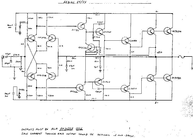

Does anyone remember this nice old amp ? 10 watts with positive forward feedback. How does it sound compared to today's Class A amps ?

The diagram was posted from someone that removed company information. The model 10/10 is not much different from the 25/25, so you have the diagram. The difference is the bias.
This was a toss up at the time for an auto bias amplifier, that is why you find the 5.6 k
resistor in the emitter circuit of all the amplifiers. This resistor locks the bias for leakage on the output transistors. Some of my designs come from the days of Acoustic Control working with the model 400 amps which were all auto bias. To make any of the Bedini amps auto bias you need a resistor placed in the VBE multiplier circuit to ground and the 2K pot removed. I would not suggest doing it on these boards, but it can be done. Remember who I worked for Maden Sharma he was a tricky guy with circuits.

Model 10/10 Bedini
Nanook,
Thanks for your kind words, I take no offense on this issue. But for those that want to know about the model 10/10, that little Amplifier was given to the Dealers at the time as a sales leader. So what they would do is order a mix of amplifiers then send them all back and keep the model 10/10 ( Number Made 40) so Gary and I stopped making them for that reason. You would find then that they were being sold for $500 or more. Today you can not find one for less then that. The 25/25 and the model 10/10 used the RCA 2N3055 H transistor The normal 2N3055 could not survive the abuse. The main use for them was the Stax headphones and Quads. The Topology was to couple a Dual Diff front end to a Quasi output stage feed forward, why because it sounded better. It would be easy to re-build the model 10/10 today with flat packs and I just might do that and DIY it. The Q series is all flat packs and were sold in England. Gary is working on the Bedini pages where we can post all the amplifiers we have left for sale. I hope this answers most of your questions and if not, Ask.

thermal bias is detected two ways
SY,
The thermal bias is detected two ways, if you notice on any of the pictures The VBE multiplier transistor is the same as the output transistors that is why the odd numbers on the heat sink. I always found that the VBE transistor should have the same gain as the output transistor. Since it was going to be auto bias that 5.6 K resistor is fed back to the base of the VBE Multiplier, it is the quiescent current that must be tracked, so I choose to do it this way. I do not believe in putting diodes on heat sinks, it's not fast enough for me.
You know if you lose the VBE transistor you can kiss the amplifier good by. Another way to look at this is by the time you detect the heat of the output stage it's too late. I have never had a failure this way with the VBE circuit. I found all these things out with work on big 300 watt RCA amplifiers in the 70's. I have seen people beat these amps up at 1.6 to 1 ohms so I do it this way.
I do not believe in protection circuits at all as they spoil the sound. It has been almost 40 years now and the come back is minimum. The tweaks kill the amp not John. This is just the way I do it, you might have other ideas. The Heat Sink is the other problem so I have tested that too.
Bent pieces of metal work better then some of the big expensive extrusions and it keeps the cost down for the consumer. The faster the heat radiates the better the amp runs. Some here say he used cheesy heat sinks with bent pieces of metal, but did they do the experiments, no. I have also seen some mounting heat sinks as heat traps, in other words backwards instead of the correct way. So thermal management what is that? I run the amps at 1/3 power for days to see what happens. The 25/25 is an example of over heat as some have said but it keep going to this day, anybody can break anything given enough time. Hope this helps.

get the real diagram
Jacco,
Go get the real diagram it's posted in the help with the 100/100 One Meg. You can not really make this drawing out. but the 10/10 is just missing two 2N3055H's , so it has a total of three 2n3055H's on the heat sink.
