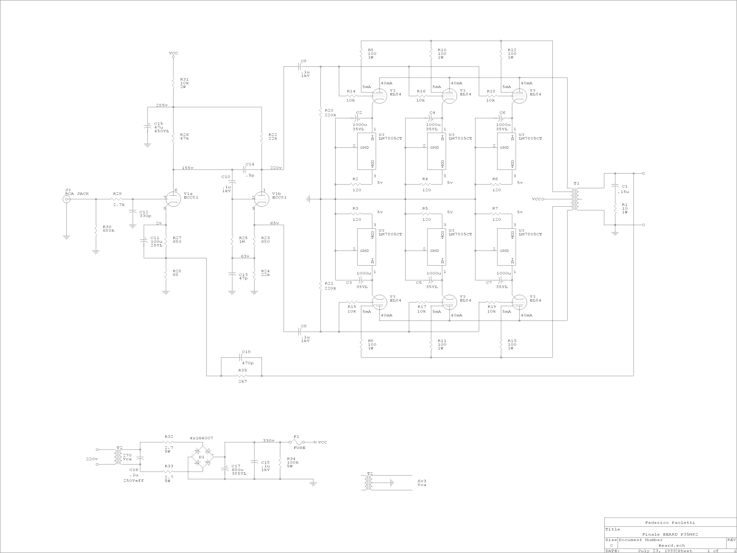

i have need of photos of the one beard p35mkII
photos of the inside transformers (power and output)
because my p35 have one hum noise and i think
that the power transformers was changed ... see the picture
help me...

no... but the noise hum in the speakers is very low, very little...
the big noise hum is in the amplifier... it comes from the power amplifier....
also when the speakers are unplugged the hum is strong...

I would not advise turning the amp on without speakers connected.
It is difficult (and dangerous) to repair if you lack knowledge but it is also difficult to advise if you have no information. I would first measure voltages/current on strategic places (left and right). Something in the amp could be wrong resulting in excessive current draw. At first sight the powertransformer looks big enough for the job.
Check if your el84's do have glowing/red plates. If so change tubes first.
Measure voltages on the cathode of the el84's, perhaps a voltageregulator is dead or sick.
these 7805 are in cathodes as CCS-es
I have schematic somewhere .... maybe I can find it tomorrow and scan ;
but - repair of that amp is still for experienced person

yes 7805 is for automatic bias...
i can not fix it myself.... but the schematic is very necessary...
in the schematic is write the value of the power transformer?

unfortunately - all I have ( and still didn't found that paper ) is sketch by hand of amplifier,without any information about xformer .
I remember there are voltages , but nothing about exact xformer .

Is the sketch available?
So you are not getting hum, but buzz, right? Schematic will be of no use for this, rather build a simple DC blocker.
270v AC 330vDC
270v AC 330vDC
Thank you for the schematic.
The amp is working perfectly, no ham or any other kind of noise, although it is connected to 107 dB speakers (avant-garde duo).
I asked the schematic in order to modify some points.
Thanks again.

try to tighten up the bolts on the power traffo...if that does not help...you will need to dismantle that traffo from the amp and put a wooden wedge(popsicle stick types) between the core and the coil...then dipping into a bath of insulating varnish will kill that noise once and for all...

See a few posts back 270V AC secondary on the power tranny to give a VCC of +330V. 6 off EL84 will want 150mA DC minimum for each channel.
EL84 draw 0.76 Amps heater current each => 4.6 Amps + 0.3 Amps for the input/phase splitter, 6.3V @ 5 Amps (min.) for the Heater winding for each channel Double these currents if building a single power supply stereo amp.
A pair of Ultralinear EL84 needs a 8K Raa Output Tranny. 3 pairs will want approx. 8K/3 = 2700 Ohms Raa and a power rating of 55 to 60 watts. Raa=3K3 Output Trannies are reasonably common and would be fine. 43% Ultralinear taps.
