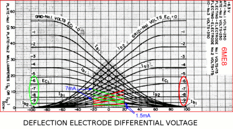

Looking at the attached curves, the deflection voltage could swing 40 volts each way, in a diffamp giving > +30 dbu, before going into the nonlinear part of the transfer function.
Looking at the ratio of deflection voltage to plate current differential, using the deflection electrodes as a differential signal grid gives a Gm of approximately 175 to 35 uMhos over the range of -6 to -9V on grid1.
Grid 1 will be used to control the gain over about a 12-14db ratio.

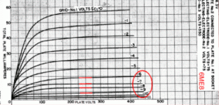

It turns out that the 6ME8 is basically a pentode with respect to grid 1, so that made me wonder how to structure the anode circuit...

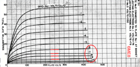

The 6EM8 is a beam deflection tube, therefore the control grid G1 sets the anode current and the deflection "plates" steer the beam to one anode or the other, the total current of the 2 anodes remaining constant.
With respect to the G1, it the tube has a pentode characteristic (see attachment) and in the chosen operating range is quite linear over anode voltage. This implies that as the anode voltages change wrt one another as signal is output, the total current will remain constant. I can use that knowledge later...
It looks to me like a purely resistive load would give a fairly linear output, especially if the topology is kept balanced differential throughout.

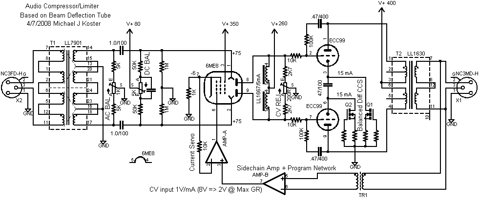

So, here's a simplified schematic. The input is transformer coupled with a signal balance network to null out the f2 distortion due to unequal signal swing through the signal path top vs bottom.
Then cap coupled to a DC balancing network to set the quiescent current balance between the 2 anodes by tweaking the deflection voltages.
The gain control voltage from the sidechain drives the control grid of the 6ME8 through a cathode current servo. Remember that the signal doesn't change the cathode current, just steers the beam back and forth, so this trick should linearize the gain response to a 2-8V control voltage input.
Back to the signal path, the BDT anodes are loaded by a common mode choke that should provide the first rejection of the control voltage induced common mode thump signal while passing the audio at a level determined bt the BDT current swing and the load resistance.
This couples to the output stage which can provide controllable gain through the "plate feedback". The load resistor also has an adjustable center tap so that the CV thump can be balanced out and rejected by the diffamp output stage. The cathodes of the output stage are AC coupled but DC separate, allowing perfect DC balance and AC current sharing.
The output stage gain should be adjustable between 1x and 3x (0-10db) which is in the loop and will set the compressor's small-signal gain.
The output signal is taken back to the sidechain amp where it is rectified and processed for threshold, attack, release settings and applied to the 6ME8 current servo.
All of the balance adjustments make it look complicated, but I think they'll be necessary for good performance. One characteristic of this limiter may be an increase in f2 distortion as the Gain Reduction (GR) kicks in ;-)

Hi Don,
A good differential gyrator could reject most of the thump.

Looking at the 6ME8 pentode curves, I see that plate current begins to drop off below 175 V. Not sure if the output will be dipping that low or not, but it will likely round off the nice linear modulation curves if it does. So might need a little more B+ on the LL1667. Also, I think there is a set of caps missing in the diagram between the LL1667 and the ECC99 grids.

Hi Don,
Thanks for the review and feedback!
Linear operating range:
Post #2 shows the proposed operating range of plate voltage vs current over G1 voltage in the red-line part of the curves. There is a little skew not shown due to voltage drop across the 1K2 DCR of the LL1667. From 2mA to 8mA there is 7.2V drop. I tried to stick to the flat part of the pentode curves so the output signal voltage of the variable gain stage would be entirely defined by the a-a load resistance and the current swing, which changes with G1, or more precisely in this circuit, cathode current.
Direct coupling:
I intend to direct couple the 6ME8 anodes to the ECC99 grids through the plate feedback network. Do you think the DC balance of the 6ME8 will be too unstable? I think for best operation, the circuit needs stable DC balance between the 6ME8 anodes anyway. The AC coupled CCS in the ECC99 tail should deal with a moderate amount of DC grid-grid drift. There is plenty of tail voltage as there is only 140V or so a-k across the ECC99 depending on the DCR of the OPT. Since I needed the +350 for the G3 acceleration voltage anyway I thought just build an unreg +400 or so and regulate the other +HV voltages down from that.
Target application:
This is intended to be a transparent "light-touch" compressor for recording chain use that one would go to for vocals, drum overheads, etc. that don't need to be "crushed". This is not a crusher by any means with only 12-14db gain reduction, maybe 18db if really stretched.
If it doesn't introduce too much distortion at low GR and in the +4 dbu signal range it might also be a good mastering compressor.
I do want a sidechain with attack, threshold, ratio, and release control. I think this has fast attack potential if the balance is stable enough to get a good dependable "CV null".
The ability to handle +30 db across the tube input terminals directly is a very useful property for these applications.
