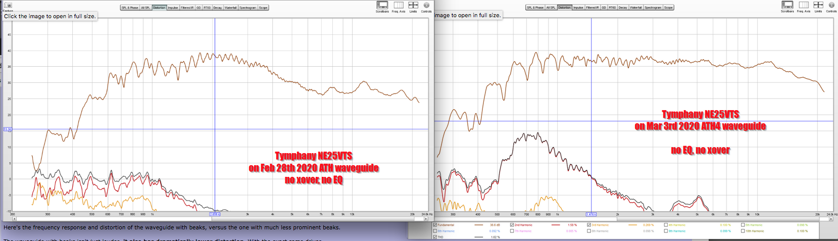

Here's the frequency response and distortion of the waveguide with beaks, versus the one with much less prominent beaks.
The waveguide with beaks isn't just louder, it also has dramatically lower distortion. With the exact same driver.
The waveguide WITHOUT beaks is gorgeously flat. This measurement has no EQ whatsoever, no crossover. I don't think I've seen a waveguide that measures this flat without EQ.
JBL sells speakers with soft domes and the 'beaks' are way less prominent than in the M2. I'd always assumed that JBL reduced the beak size because of the wavefront shape produced by the dome. But it's possible that manipulating the size of the beaks is a way to flatten the on-axis response. IE, the PROMINENT beaks appear to raise the SPL and lower the distortion, but if you are designing a loudspeaker and you need to sell it for a very low cost, you might optimize the waveguide to lower the cost of the CROSSOVER, not to increase the maximum output. This is particularly sensible for a loudspeaker that sells for as little as $150-$200 each at retail; at that price point, the cost of a $10 inductor can translate into raising the retail cost by $30 or more.
The waveguide that I made with beaks is dramatically louder and lower in distortion than the one without. Inexplicably so.

Patrick,This graph is absolutely baffling to me. I wouldn't be shocked if there was a difference of one or two decibels, but this is a TEN DECIBEL difference. This simply makes no sense.
Yes, there is something baffling that makes no sense if we exclude a simple EQ and sensitivity mix-up between the "TEN DECIBEL" graph and the Feb28 vs Mar3 graphs.
The Feb28 "beak" graph does show less distortion in the 600-1kHz range, but only a mild (+2dB) sensitivity increase in the 2kHz range, with a reduction in sensitivity both above and below.

This measurement was done at identical voltage, EQ settings, crossover settings and distance. I measure at a distance of two meters.
It's tricky to compare the unfiltered measurements because I generally don't calibrate the voltage. I'm admittedly sloppy with my measurements, I build fast and measure fast.
But the graph above, I set *everything* equally to do an "apples to apples" comparison.
