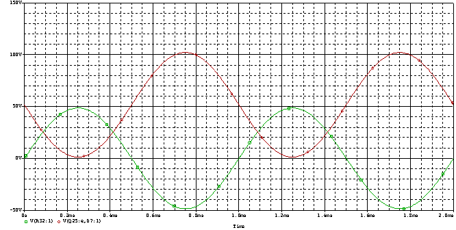

I'm almost certain that you will burn them, Are they in the VAS of an amp the might "see" almost twice the railvoltage. In this case it will be 120V.
They might not burn though. I used 139/140 in by Leach at +-55V rails before I changed to MJE340/350, the transistors played, but distorted like mad because of overvoltage.

Here is a sim of the VAS transistor in a Leach, I did not have the time in my first post - sorry.
Green is output, red is voltage C-E on the transistor
\Jens

I've repaired amplifiers with BD139 & BD140 used in VAS and as pre-drivers with up to +-50V rails with no problems. I had to replace dozens of output devices but never had to replace a blown BD139 or BD140. At low currents [ie: 10mA] they appear to be able to reliably withstand 100V [te ones I saw were from Philips]
Anyway, for VAS or predriver with +-60V supplies I would look for 150V or higher Vceo transistors. BD139 & BD140 would be OK for other applications where they are exposed to a single 60V rail

If you have access to a curve tracer, you can test what the actual Vceo of each device is. Some types and or batches will support higher voltage, some won't. It can vary from manufacturer and date code.
I've found many Japanese transistors to have much higher voltage capability than rated, but there were a few devices in each batch that were close to the spec limit too. I sometimes test and label a whole batch just as an experiment, and reserve the better devices for higher voltage application.
Bottom line, unless you test it's Russian Roulette, and with expensive output transistors as your bet. You have to decide if it's worth the risks.
