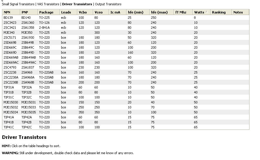

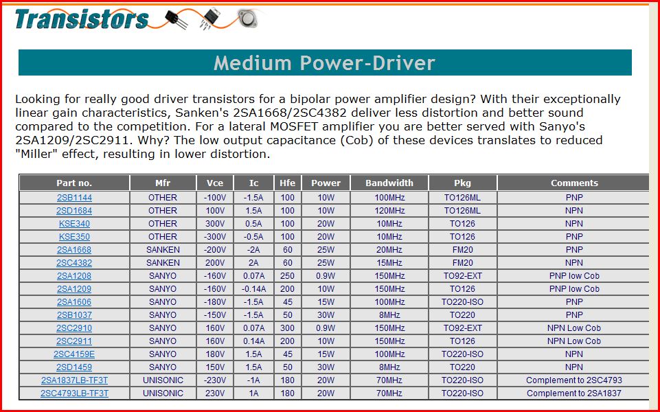

The only trouble with DB139/140 is that they aren't rated for higher voltage rails, even +/-42V is pushing the limit if you normally design with some de-rating. I've recently got some KSA1381/KSC3503 to try out - no idea what they sound like though but they look good for both VAS and as drivers (medium power amps).
Some old but obsolete and faked favourites like Renesas 2SD669/B649 and Toshiba 2SC4793/A1837 are now produced by Unisonic (Taiwan) and available economically through Profusion PLC. (UK, Germany). Possibly there are other global distributors who are not just selling fakes.
I've bought and used the original Renesas types and these are certainly as good as drivers, though I haven't used them yet in the VAS transistor role.
There's a few types worth consideration in this list: Medium Power-Driver
The 2SC4793/2SA1837 is available from Mouser too (Toshiba), and don't forget the 2SC5171/2SA1930, which are the one of the best driver under +/-60V.
