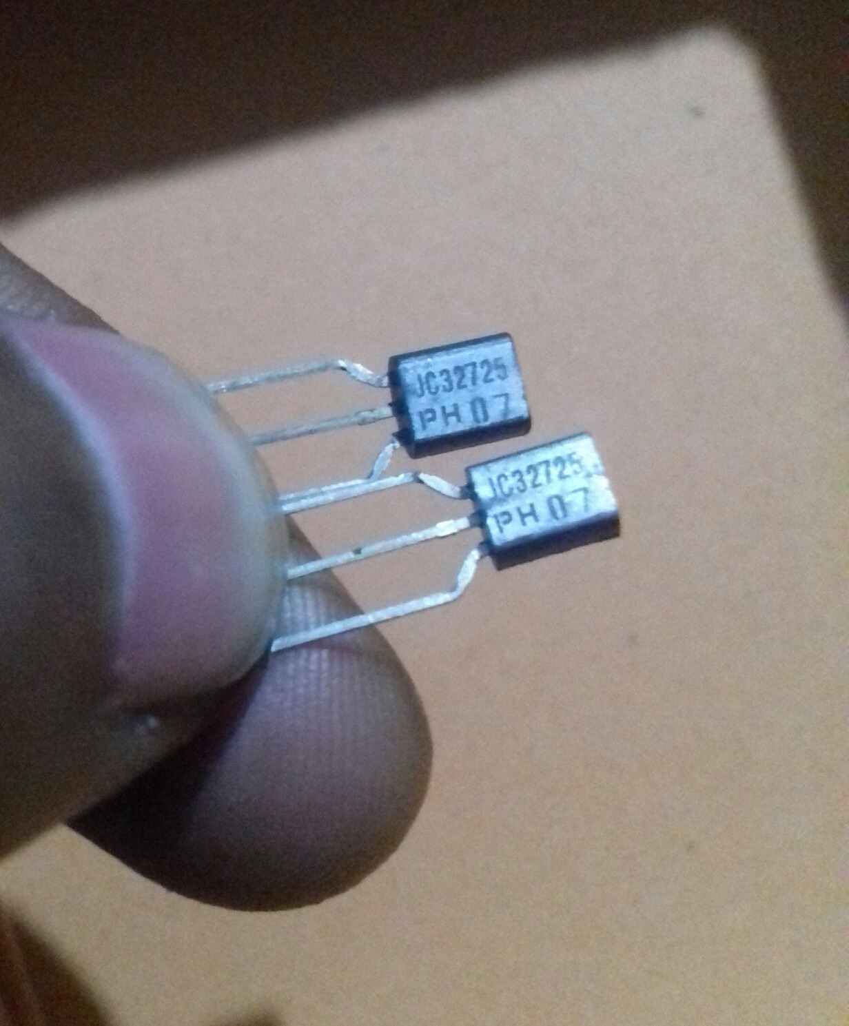

Very long ago we already used BC327-25 (or the 40) and BC337-25 (or the 40) as they were lower in noise when compared in real life to BC550C/BC560C. All made by Philips, I don't know of other brands.
Rbb is below 50 Ohms AFAIK.
