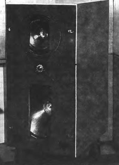

Have a look at the following BBC document for the LS5/8 which uses a similar principle:
http://downloads.bbc.co.uk/rd/pubs/reports/1979-22.pdf
I cannot remember if it covers the design of the front panel cut-out for the bass unit.
It widens the midrange dispersion of the 300mm woofer. Its the same principle as with slot tweeters.

As alluded to in that article, if you make the slot too narrow you
will effectively turn it into the front chamber of a bandpass cabinet.
Which is not what you want .........
Also remember to leave enough clearance for the units max excursion.

It can't be accurately decided by wave formulas alone. It takes experimentation and measurements for individual transducers. There are many things to balance. One is the off axis behavior of each 6.5'', since the dispersion is dependable on its cone flex and phase plug or dust cup. Then, the cavity behind the slot interacts with the cone shape and movement. The material and thickness of the slot baffle contributes also. Crossover frequency and slope is essential too. The goal is to get better off axis integration and certain desired dispersion without extra cavity and mechanical resonances coloring the area. In pro speakers that many such tricks are used, much wood is cut and many measurements are taken. Subjective evaluation and trial on error, is the order of the day despite the theory. I would try your 130mm starting point, it sounds logical.

If I can see it accurately, the speaker in the photo is the BBC model that was described in detail in some 3 articles in 'Wireless World" in the 1960's. It was the March, April and May editions of 1968. Title:"New BBC Monitoring Loudspeaker". Author; Dudley HARWOOD. The cross-over frequencies were 400c/s and 3,500c/s. (12", 8" and Celestion dome. An extremely early, if not the very first use of Bextrene for the two cone drivers.) I think the Spendor BC3 was similar. As 'salas' said it is complicated. It is also worth bearing in mind an observation made by Martin Collums in his "High Performance Loudspeakers". In the section on mid-range speakers he notes that many prefer a 2" dome because they mistakenly think it must have better dispersion than a 6" cone driver because it is smaller. But he observes the actual radiating areas of the cone may contract to 1" diameter as frequencies rise where as a 2" dome will actually be worse if the 2" coil is dominating. As C.S.Lewis said: "Life is complicted and any description of reality that is not complicated is unlikely to be very useful".

The active Ls5/8 with the "BBC slot" was always a great
speaker but a bit BIG! If anyone is planning a slot for their
dispersion woes take a look at the LS5/8 PDF page7 of 11 as it shows the slot is not square. I wondered why the later LS5/8 gave up the slot The later Kef made Ls5/1 had a slot but I have never heard one.
There was also some LS5/8 magic with the crossover and the BBC 2.8k? dip!
The technology in the B&O 5's appears to be an attempt to "widely disperse" sound in the midrange using a dome mid and very complex wave guides. If you can get it right a slot is a good cheaper solution!
