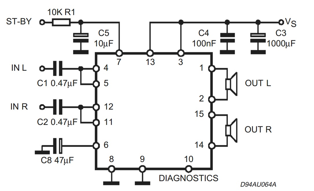

The problem is I get LOADS of trash sound if the volume goes up :/ The amp is TDA7377, the sound without the baxandall is really clear. The amp circuit is below, it is the same circuit from the datasheet 🙂

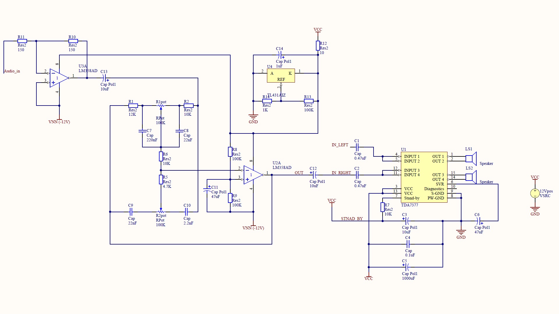

But then I tried giving -12V to the LM358 (instead of going for Ground) and it got Better again 😀 The sound is very clear until low frequencies appear, then everything sounds like through the water, the bass is overwhelming everything :/ Have any ideas? 🙂
At first I thought it was the baxandall working but twisting the pots didn't change anything :/ Tommorow I'll try adding those 2Kohm back 🙂 I am adding my current circuit (I did the full circuit for one channel because everything is the same for the second one) 🙂

You appear to have confused a passive tone circuit with an active one. The values of C7 , C8 sbould be identical. The values of C9 and C10 should be identical. .... same again for R1, R2 this would most likely explain your lopsided frequency response... Your first circuit U3 150 ohms input imedance is too low. for a gain of 1 and a good input impedance use R10=R11=10K or whatever input impedance you require - also pin 3 on U3 needs to go to ground, not -vee..... pin 3 on the tone control opamp U2 should also go to 0V not the divider you have. That divider is only needed if you are *not* using a -ve supply in the circuit. Also if the -ve supply is used, C12 should be turned round. C2 should be removed as it is superfluous anyway.
And use linear taper pots. Those passive versions which used unequal cap values used audio (semi-log) taper pots. You don't want those with the feedback-type circuit.

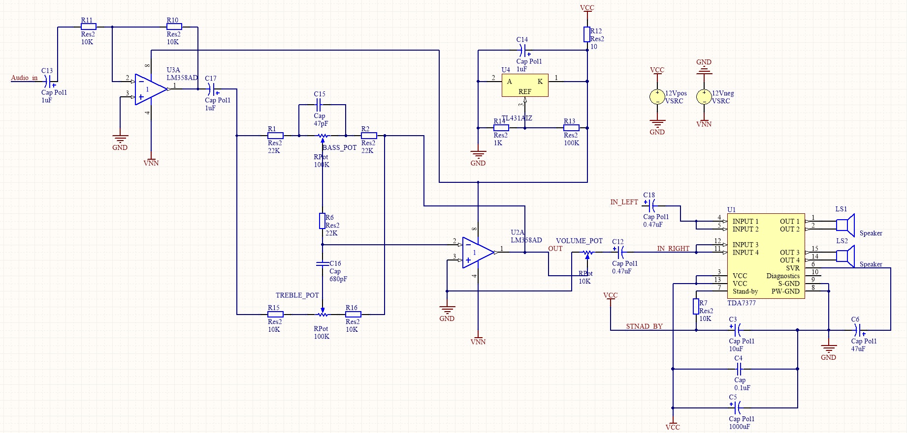

Okay here is an update on the circuit, didn't have much time to work on it, but made a few changes 🙂 I completely remade the filter, changed up the input 🙂 Here is the new circuit (added below) 🙂 Sound honestly is now clearer, unfortunately there still are problems occuring.
-It seems that if there is low frequency sound with bigger amplitude it starts making noise :/
-The overall sound volume is really low. I had some pots as volume control but even if I take them out completely it does not help 😀
I'll try to get my hands on some theory, if I'll find the solution, I'll post it here (because my previous source proved to be a load of crap) 🙂
P.S. I don't know if I mentioned it, but my new source has 8A, so I doubt the problems are caused by current shortage. And I am not sure what kind of pots I am using (got the from a friend), I will post a picture as soon as possible 🙂
