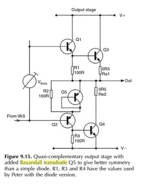

As I've seen recommended by Douglas Self in his schematic in the book the transdiode is made from a pnp transistor, like the driver.

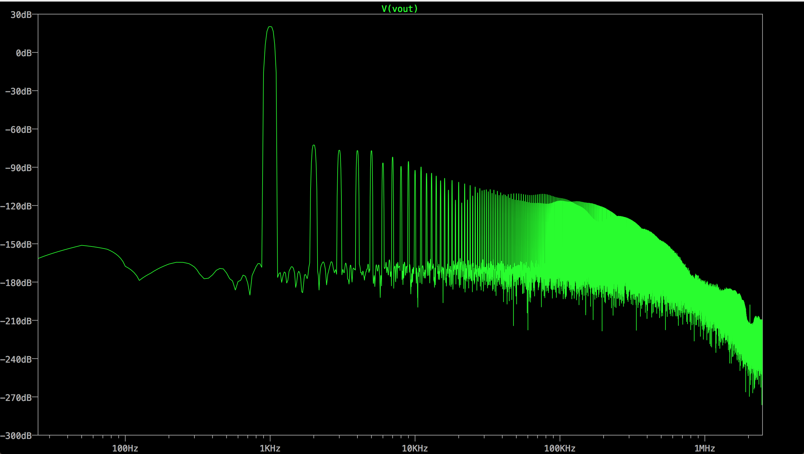

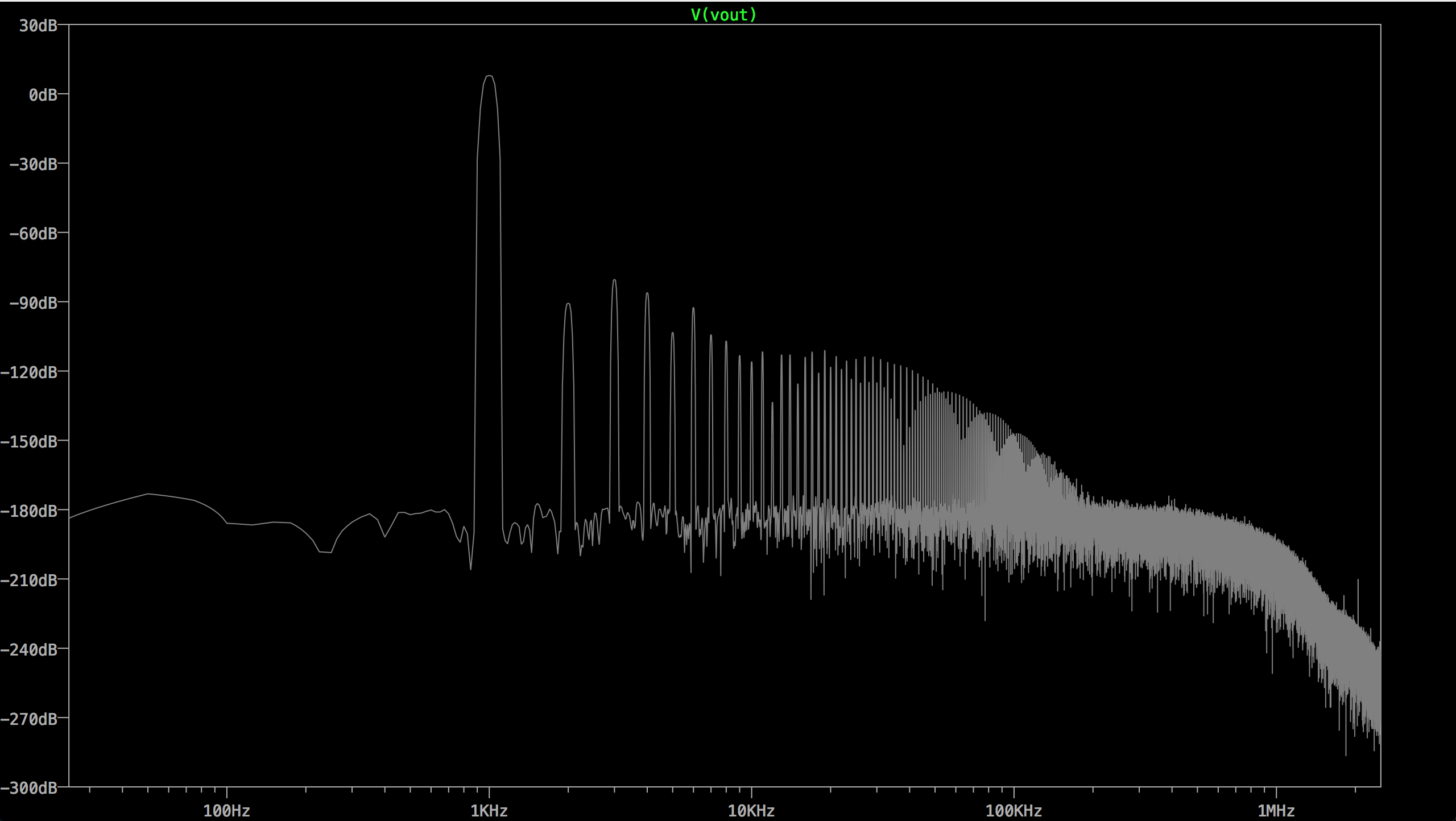

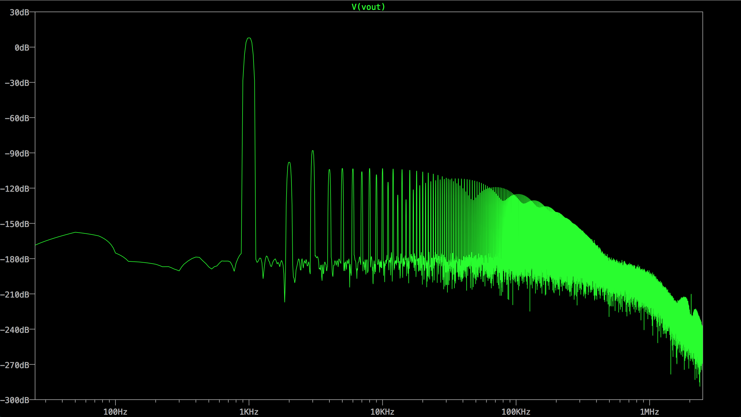

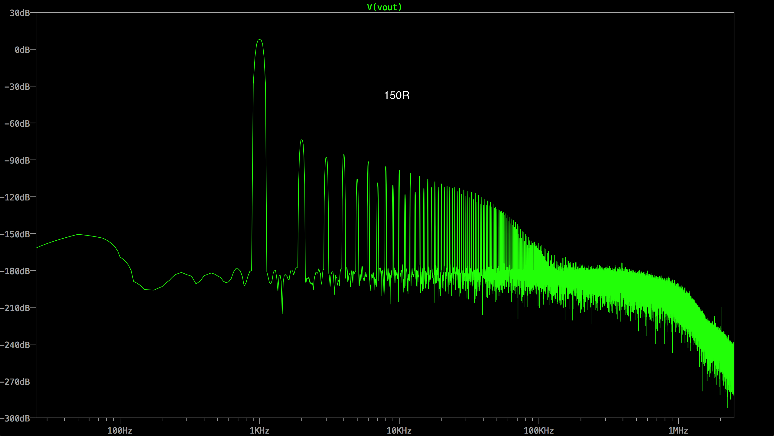

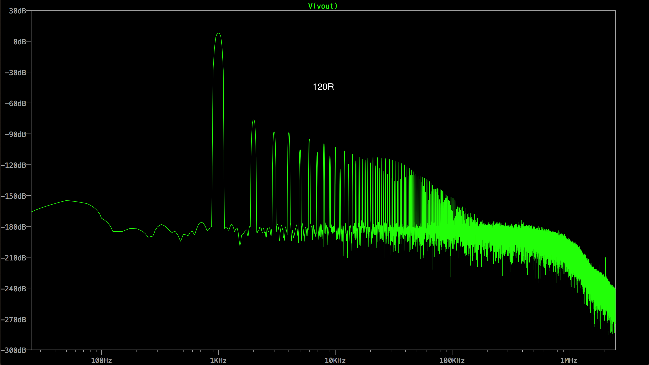

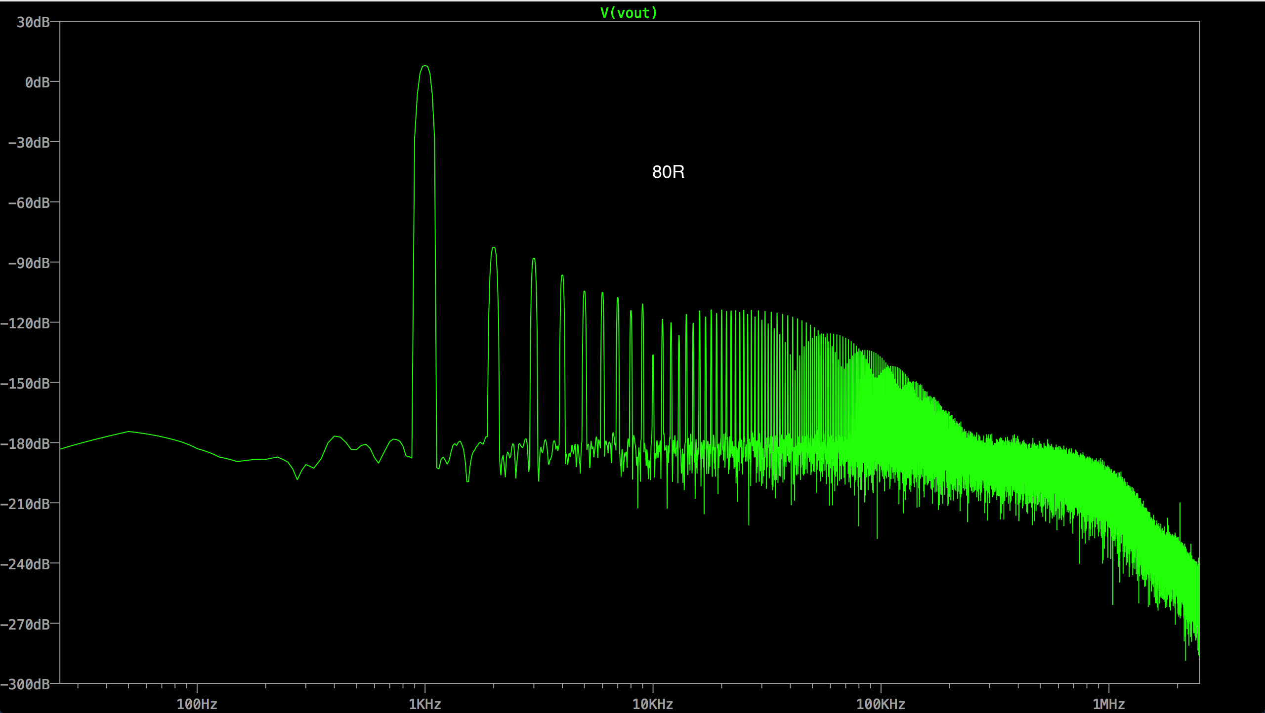

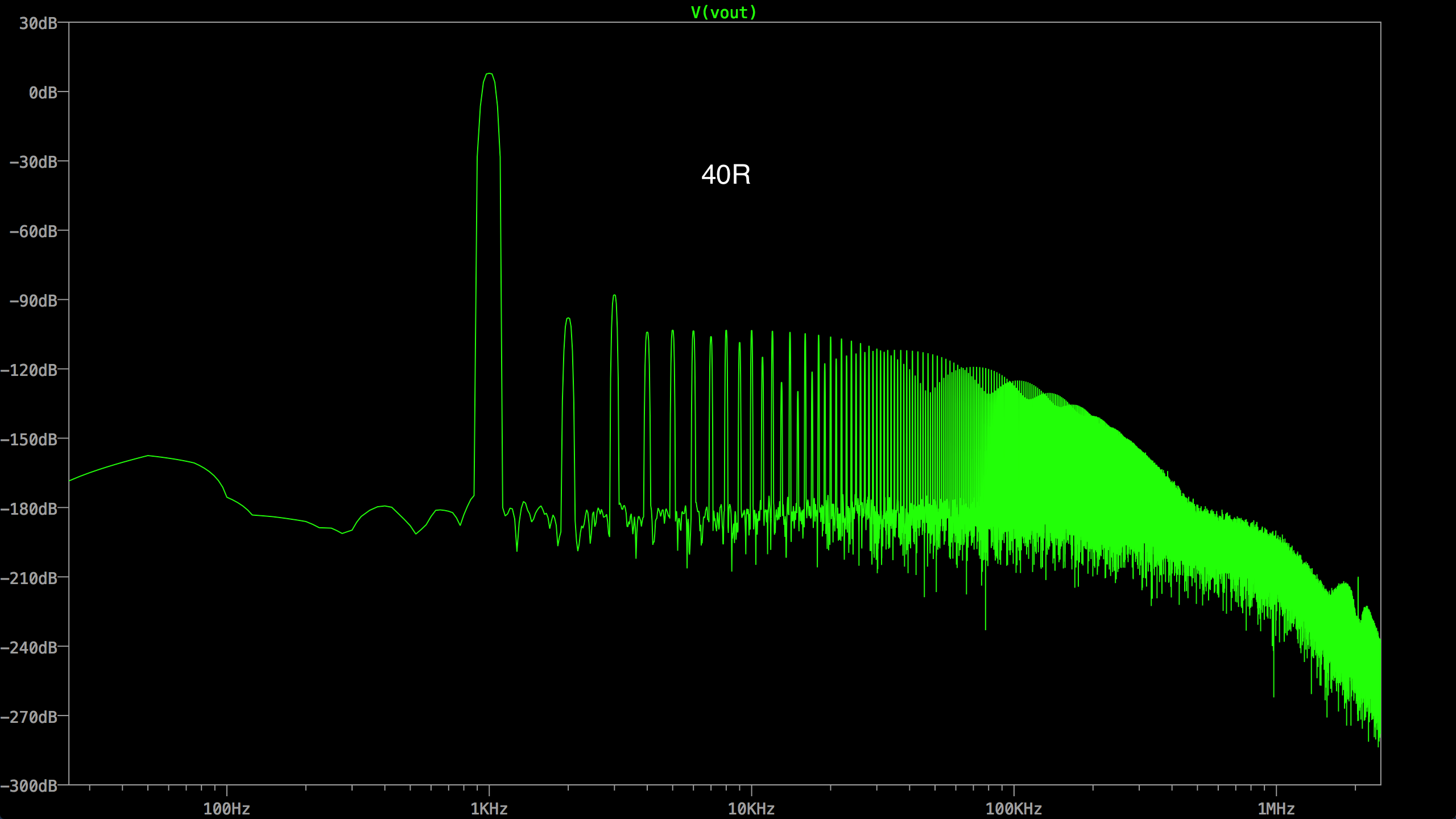

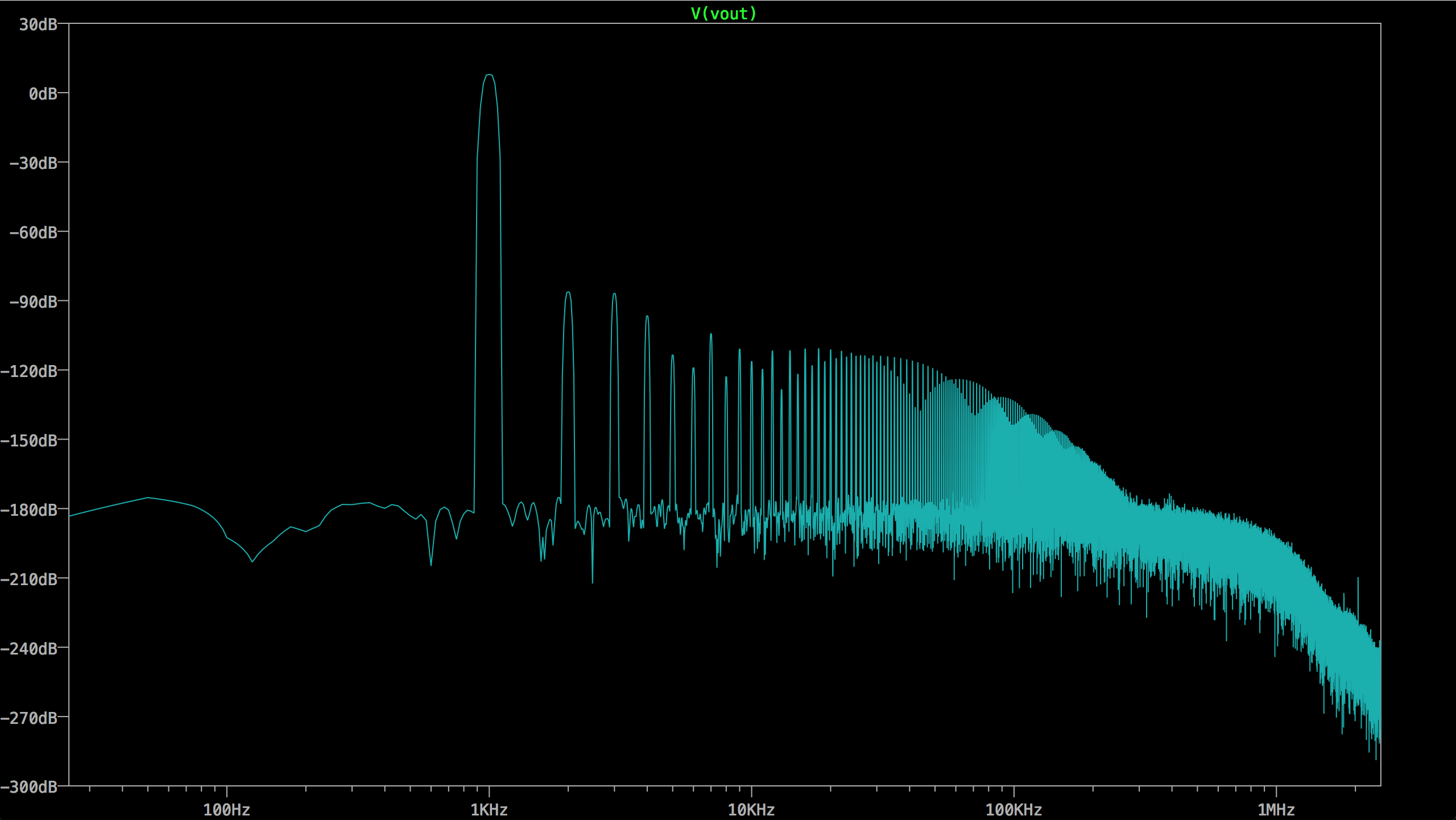

Here are some screenshots of Flat Top window function FFT with different pnp driver emitter resistors at 1W output into 6ohm load at 15.5mA bias, with THD:
40R - 0.001819%
80R - 0.003466%
120R - 0.006514%
150R - 0.008897%
All transistor models I used in this output stage are Keantoken/Cordell models.

And here's the same settings with 80R and 18W output.
THD holds nice at: 0.003502%

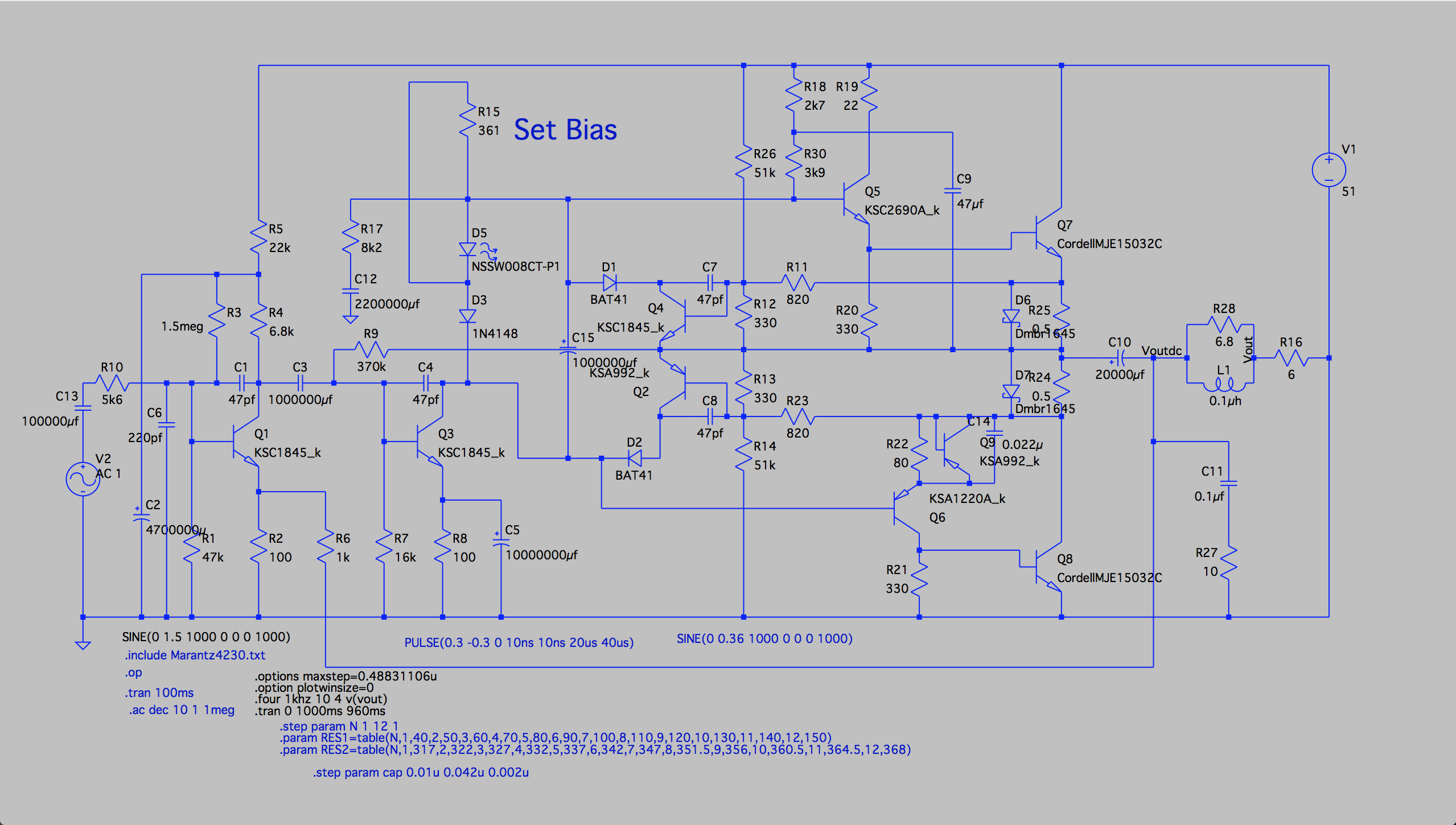

Also attached the circuit schematic.

Yes, I messed up the connection of the transdiode :headbash:
Sadly when I connected it right the result is not that good as before. I get at most the same amplitude of 2nd and 3rd harmonics at about 70R. Lower or higher the 2nd lower and 3rd rise pretty much.
I used a PNP as I've seen in the book of Douglas Self. I attached a screenshot of the schematic he presented. I don't see a 0.5R resistor added in series, but maybe a more detailed implementation could include it. I'm not that knowledgeable as to assert anything.
