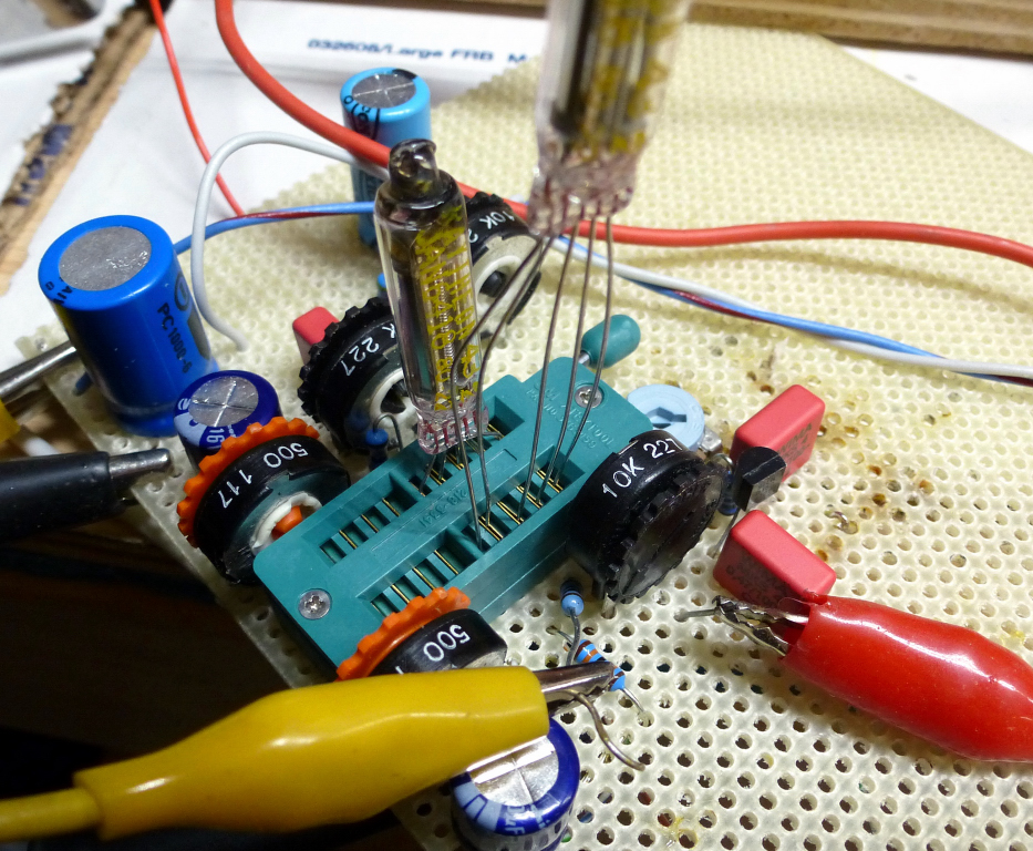

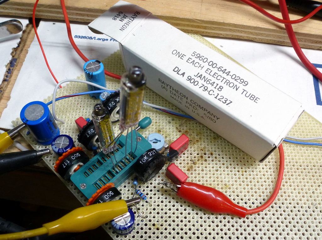

I made a simple test board to evaluate some tubes. I used one or two silicon diodes to raise the filament 0.7 or 1.3 volts above ground. Simple, effective, but wastes power. The schematic you linked does this too. All filaments are wired in parallel and fed from a step down converter off of 12 volts. I think 6 tubes in series would be too hard to bias, but I may try it later.
Long term I will probably use a negative voltage generator chip since there is virtually no current drain. The LM2664 will make -5 volts and eat 1/2 a milliamp with no load.

You can't measure the grid leak voltage with any real meter. An old VTVM has a 10 or 11 megohm input resistance. The cheap Chinese digital meters of today are about 1 megohm. That gets put in parallel with your grid leak resistor when you try to measure the voltage. Just tweak the resistor value for best tone, or lowest distortion. Whichever you prefer.
