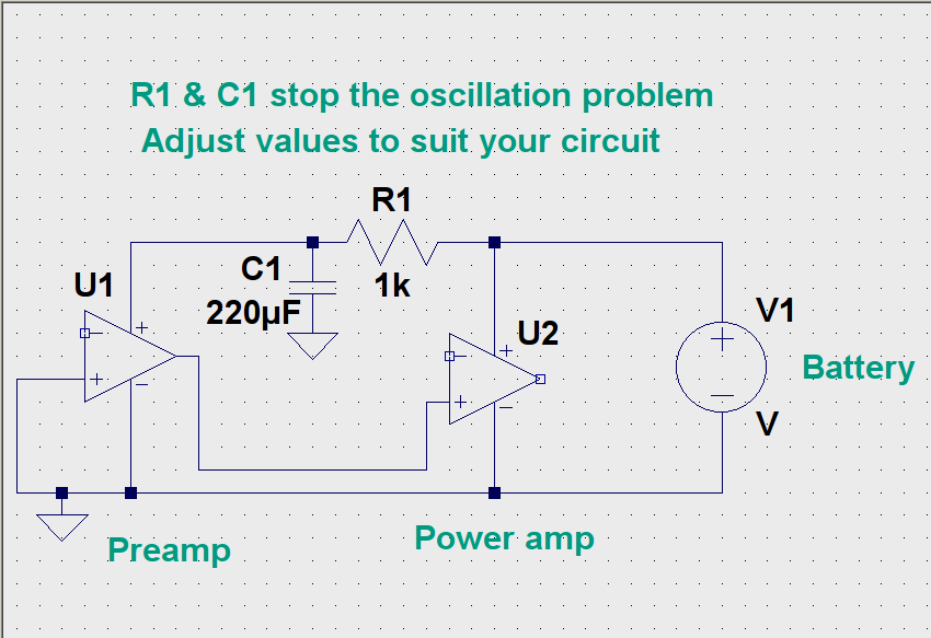

Hi. I have also tried building a simple PA system with 3 mike I/P's.
Seems simple ... Mikes -> preamp -> amplifier -> speaker.
However with preamp and amplifier running off same 12v power supply I get severe oscillations with the volume at less than halfway.
I've tried this with several different amps/preamps (even radio mike receivers) and always the same problem.
If I run the preamp off a separate battery then no problem.
I need to run it all off one battery so how do I get rid of these oscillations.

The problem you described occurs because the power amp draws a fluctuating current from the battery. In response, the battery voltage fluctuates slightly. When you feed the preamp from the same battery, those tiny voltage fluctuations get into the preamp, where they are amplified, and fed back to the power amp.I need to run it all off one battery so how do I get rid of these oscillations.
Now you have positive feedback (same concept as a microphone too close to the P.A. speakers), and you get oscillations.
The solution is to keep those tiny battery voltage fluctuations from getting back into the preamp. In most cases, this is quite easy to do - insert a resistor (R1 in the attached figure) in series with the positive battery rail. Connect a capacitor (C1 in the figure) directly from positive power supply rail to negative power supply rail in the preamp.
Together, R1 and C1 form a low-pass filter. They let DC electricity flow through from the battery to the preamp. But those small AC fluctuations in battery voltage are filtered out by R1 and C1, and never make it back to the preamp.
-Gnobuddy
Hi Gnobuddy
Thanks so much for this clear reply. I had in fact found this solution on the web and was astonished that just a simple resistor solved the problem completely. However I did not understand why it worked. Now I do. Thanks again, Paul
It does require a capacitor too, probably there was already a capacitor in the preamp, which worked in conjunction with the resistor you added....just a simple resistor solved the problem completely.
