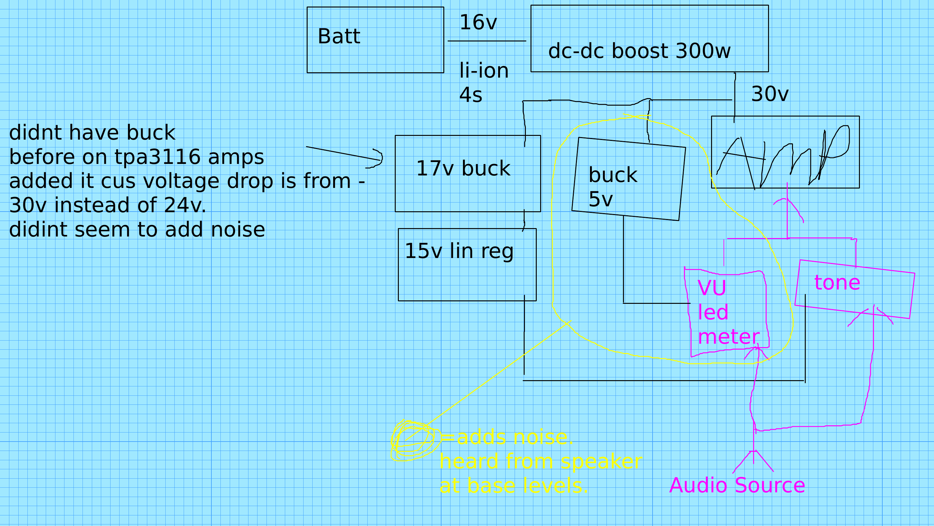

I am trying to have connected together (battery or single mains psu powered):
tpa3250 (use tor browser to view if doesnt load): TPA3250-2CH-50W | 3e Audio
tpa3255 amp TPA3255-2CH-260W | 3e Audio :
I power the (12v OPA2604 tone board) pre-amp via buck dc-dc converter powered from the same dc-dc boost converter of the amp. Which seams to help with noise a lot... Well preamp powered this way seams to not have problems, works fine 🙂. The other +/- 15v dc tone board seams to be ok too. Been changing the dc-dc convert setup ive used for it as the previous module i used kept getting blown up in accidents 🙁 so i need to try out the new one to see if its ok.
Adding the 5v vu meter is new and where i am having noise problems.

Perhaps a sketch would be better to show each device, and the power supply used for each device, and the signal connections. That should remove any uncertainty of what is connected to where.
You appear to have a ground loop circulating around the 30V supply, through the amp, out to the VU meter module, back through the buck to the 30V.
You could check by adding ground resistance (eg. 100 ohm) between amp and VU module (as that connection should have negligible current flow).

Is the portable cd player the 'audio source' in your sketch, and is it powered by its own batteries?
Is the laptop the 'audio source'?
yes. 2x aaIs the portable cd player the 'audio source' in your sketch, and is it powered by its own batteries?
yes
audio source = anything with lineout or headphone out 🙂
How is the headphone amp powered?
There also appears to be a ground loop around the tone board and its power supply and back through the other two ground paths.
How much current does the VU board take? Can it be powered from the 15V supply via a 5V linear reg?

headphone amp as its own built in battery.
i have noise with and without the tone board. both the tone and vu meter with "100ohm" (test meter measures as 70ohm~)
not much current hmm less then 100ma i expect. theres an idea, yea ill try it.
Isolate the audio before/after the tone board. (Puts it on its own island because of the +/- needs) Isolate the audio at the amp input. Don't use those powered isolators! It adds another ground loop on the inputs.

I’ve just realised that mains ac 240v to dc PSU are isolated by there nature 🙂 because other wise mains ground would be connected to dc gound and so audio signal ground which would electrocute the user, urrgh!
Lets generalise and say that ALL audio equipment is to be fed from an isolated supply. An SMPS supply or a conventional mains transformer achieves this. They isolate the circuitry the from the live/neutral connections by means of Galvanic Isolation:
Galvanic isolation - Wikipedia
The mains ground connection may (or may not) be carried through to the DC ground (as you call it). This is a pure design choice and depends on the individual equipment in question. There is no safety hazard or electrocution risk. Many commercial amplifiers and source components do indeed have direct continuity by design from mains ground to both chassis and the audio ground.
Mains ground is at zero potential relative to the floor you stand on, the walls you touch and so on.
