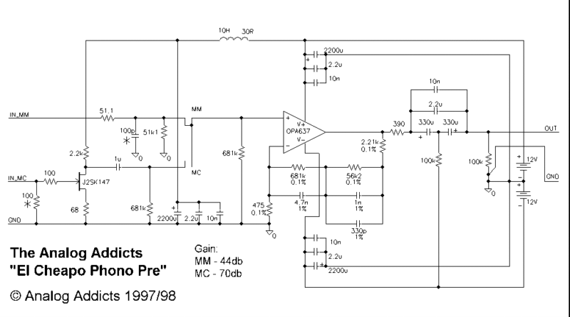

oh, and im still curious what value of caps i need to lower the impedance at higher frequencies. im not an EE, and quite frankly i SUCK at electronics, so i really dont know what i need to do here. help maybe?

bypasscaps for battery PSU.
The complete circuit can be found at http://thunderstoneaudio.nav.to/
Hope this helps 🙂
Hope this helps 🙂
