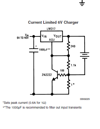

Hi satx,
I've just briefly read through this thread so please pardon me if there's something I've missed ...
However, regarding batteries:
- NimH batteries typically are not easy to float charge, i.e. charge them continuously. They have very "small" signals indicating that they are fully charged so they are rarely continuously charged. I haven't heard of it actually.
Li-ion batteries may be float charged - I do so myself - and if they are kept at a maximum of 4.05 VDC per cell they should last for a long time. Mine have now been used for about 3/4 of a year - still appear to be fine and I hope they will last much longer.
They do, however, need balancing which is a circuit that makes sure that they don't e.g. distribute the voltages so that one battery ends up at 4.3 volts (will quickly ruin it) and another ends up at e.g. 3.8 volts. My batteries just slightly drifted before I implemented a balancing circuitry - I reckon such a circuitry is compulsory.
If I can make a suggestion then it would be to let go of Li-ion & the like (e.g. LiFePO4), NiMh, NiCd etc. and then instead get a sealed lead acid battery (SLA) like e.g. this one:
New 12V 5Ah SEALED Lead Acid SLA Battery for Alarm Systems UB1250 Home Security | eBay
SLA batteries are quite rugged and even accept reasonable overcharging. They are also very fine with float charging (=constant charging) at 13.5 - 13.8 VDC for a 12 VDC battery version.
You can e.g. use an LM317T to charge the battery. A circuitry like the attachment would work. If you replace the 240 ohm resistor with a 220 ohm resistor and use a 2200 ohm instead of the 1k1 ohm resistor then the output will be 13.75 VDC. You may also substitute a 5000 ohm (5k ohm) trimpot for the 1k1 ohm resistor - in this way you can adjust the output up to ~ 30 VDC. If you change the 1 ohm resistor to 0.6 ohms you will have a maximum output current of appr. 1 ampere.
Remember to put a fairly sized heatsink on the LM317T and also to have a minimum of 3 VDC higher input voltage than output voltage on the 317T.
If you keep heat dissipation from the LM317T below 3 watts ( (input voltage minus output voltage)*max current <= 3) then something like this could be used (will get warm though):
4X to 220 Heatsink Small Power Aluminum Heat Sink | eBay
If the heatsink will otherwise be in contact with the rest of the circuitry there should be an heat conductive isolator between the LM317T and the heatsink.
Hope this helps.
Best regards,
Jesper
