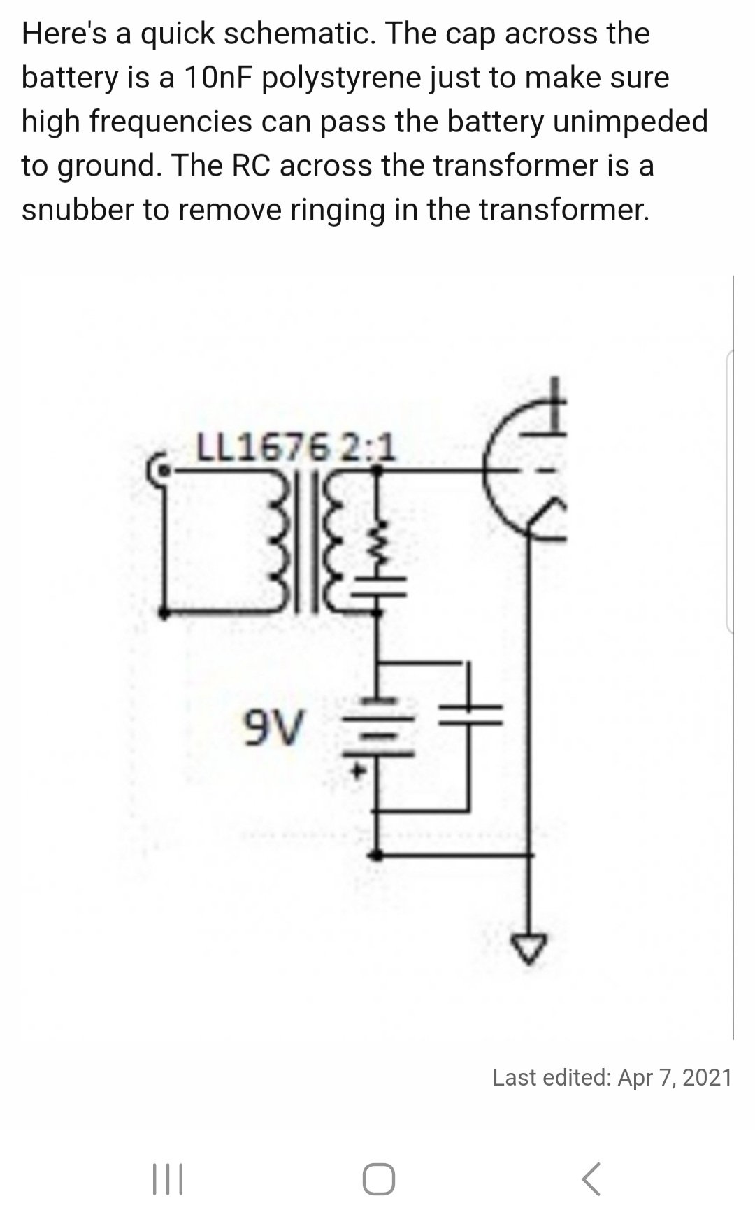

I use a 1:1 input transformer (Lundahl LL1676) feeding the 01A grid in my preamp/DAC. I have a 9V battery between the transformer secondary and ground. Using a lithium battery it has provided excellent sound and very long life (essentially the shelf life of the battery). No DC blocking cap is necessary because the transformer isolates the DC voltage from the signal input. The attached schematic shows 2:1 configuration but I've since rewired it to 1:1 to give more gain in the preamp for weak sources.
Another neat trick is that you can flip the +/- in the secondary to compensate for the single triode inverting the signal phase.
You can also use the above scheme to directly interface a DAC board to use the triode as an output stage. In my case it's a Buffalo IIISE Pro 9028 with DAC outputs directly wired to the transformer primary. Proper selection of the secondary snubber provides a filter to roll off HF hash from the DAC as a bonus.

Batteries usually perform worse than an LED. Simple as that.
Despite what you might believe, batteries are noisy. A standard alkaline battery has a noise floor of about 2uv. A Nicad is so low that most test gear will struggle to measure it. But this only works when there is very little current flow. As current begins to rise, the noise increases. Keep in mind that a basic resistor and capacitor combo has virtually no noise contribution (the noise is well below the noise floor) so long as you have good airflow around the circuitry.
Compare that to red LED that could be as low as 0.5uv and you see why people are telling you to use LED autobias over battery bias.
So then why do people talk about battery bias? Simple. Batteries are an excellent option for grid biasing. Some people feel like grid biasing is superior to autobias. Sometimes it's super convenient to use batteries to grid bias an output tube in order to keep the B+ lower. Whatever the reason, batteries are a very handy solution in that instance.
You can obviously try battery autobias for yourself, but a lot of people have already tried and found LED autobias MUCH better. Myself included.
