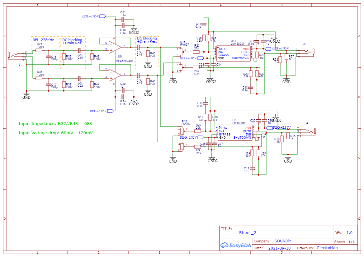

I wanted to create an headphone amp with one in and two out based on the LM4880 being fed from a dual supply instead that from a single one.

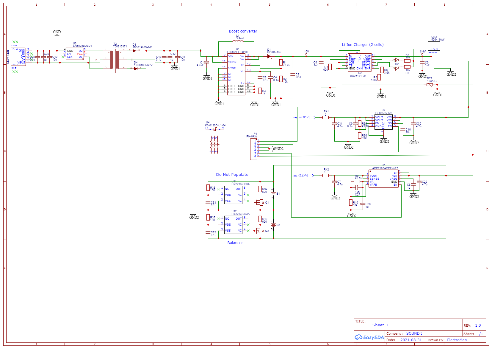

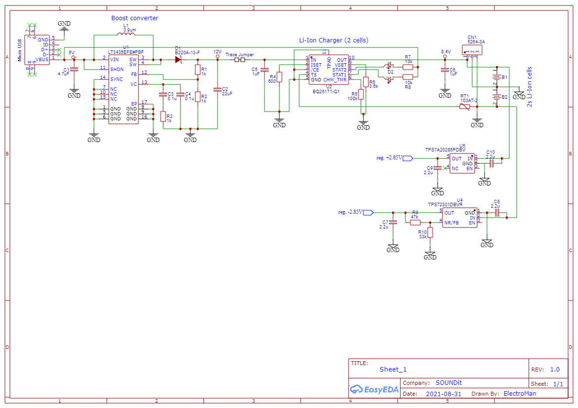

For the power supply I wanted to split two 16340 li-ion cells (3.7V - 700mAh) with common ground or virtual ground (as you name it) to make it a +- 3.7V
These two cells will get charged from USB (only charge).
Now I am having hard time with the ground connections because:
if the USB charging port is connected to a PC, then the charger ground is connected to the PC ground.
if the audio input jack is connected to the PC's audio output, then its ground is also connected to the PC ground.

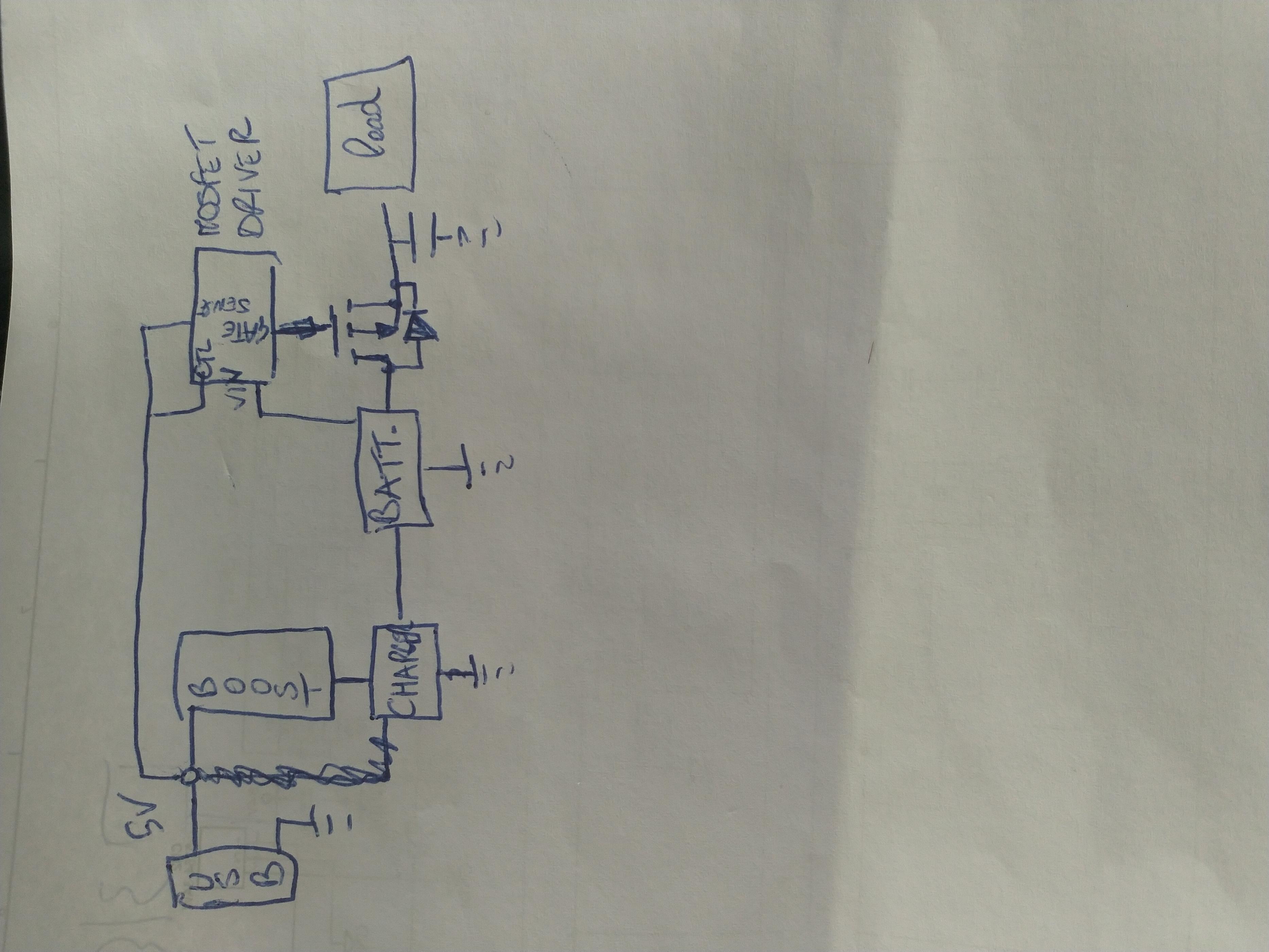

So to avoid this problem I came up with a possible solution in order to break the loop:
or about the same but after the charger:
What do you think can work better? Any help will be really appreciated

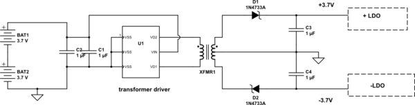

A much simpler method would be to use a Cockroft-Walton style circuit (below). The switching maybe easily carried out using digital logic ICs such as the ones in the 74HC series, as the power levels are low.
To be honest I don't think this approach will be easier. At least not for me😱

Another possibilty would be to use a DPST switch to change from charging to split supply and not to be able to use it during charge (not a big problem).
Does anyone know how I could I implement that when the USB is inserted/detected?
