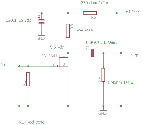

The MC stage works with 12 volt, using the 2SK364.

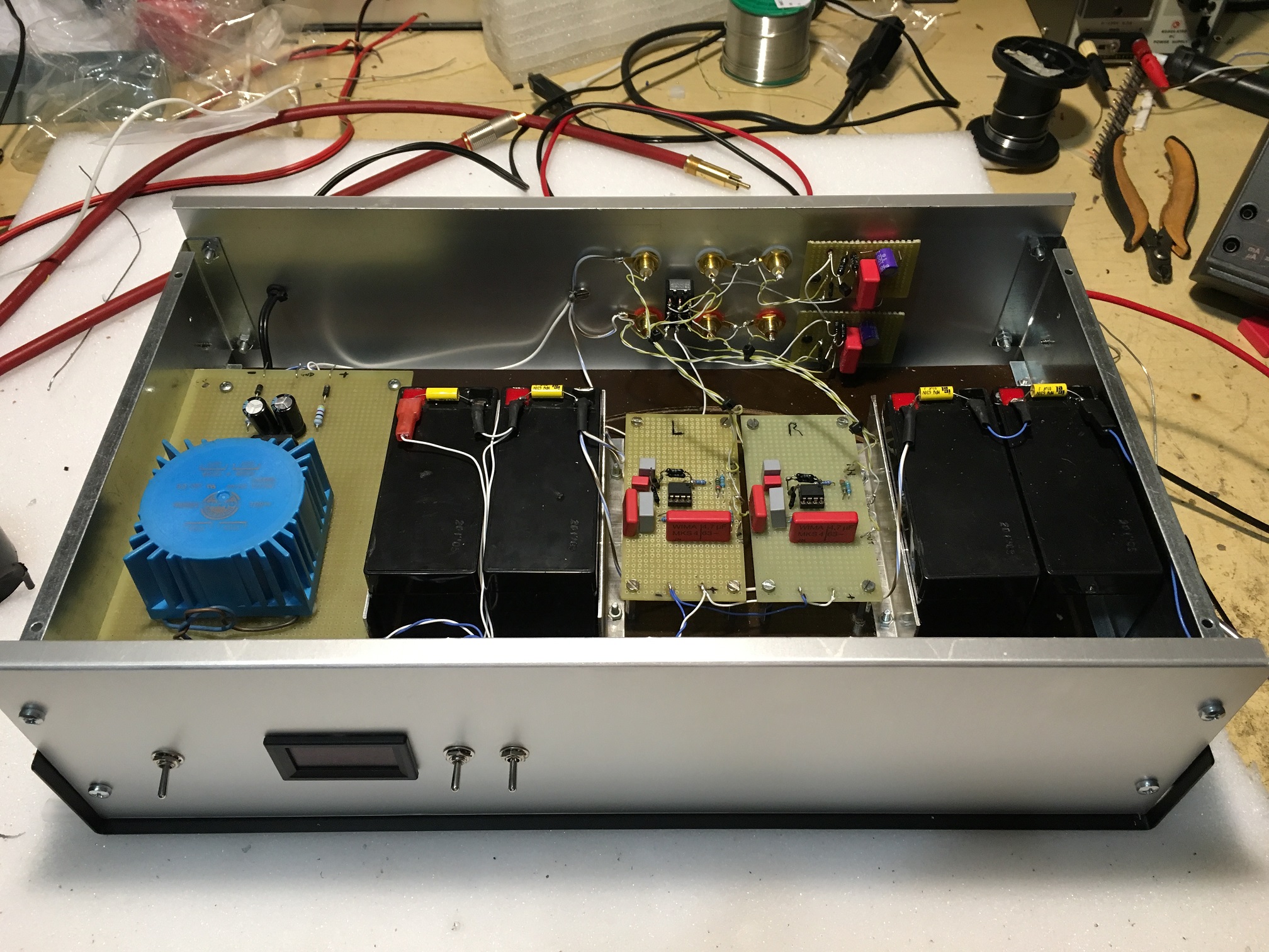

In attach the photo of proto ; it has 2+2 battery at 12 volts; two pcb for a test of the project + 2 little board with MC circuit.
There is also a circuit for charge and a little display to check the voltage.

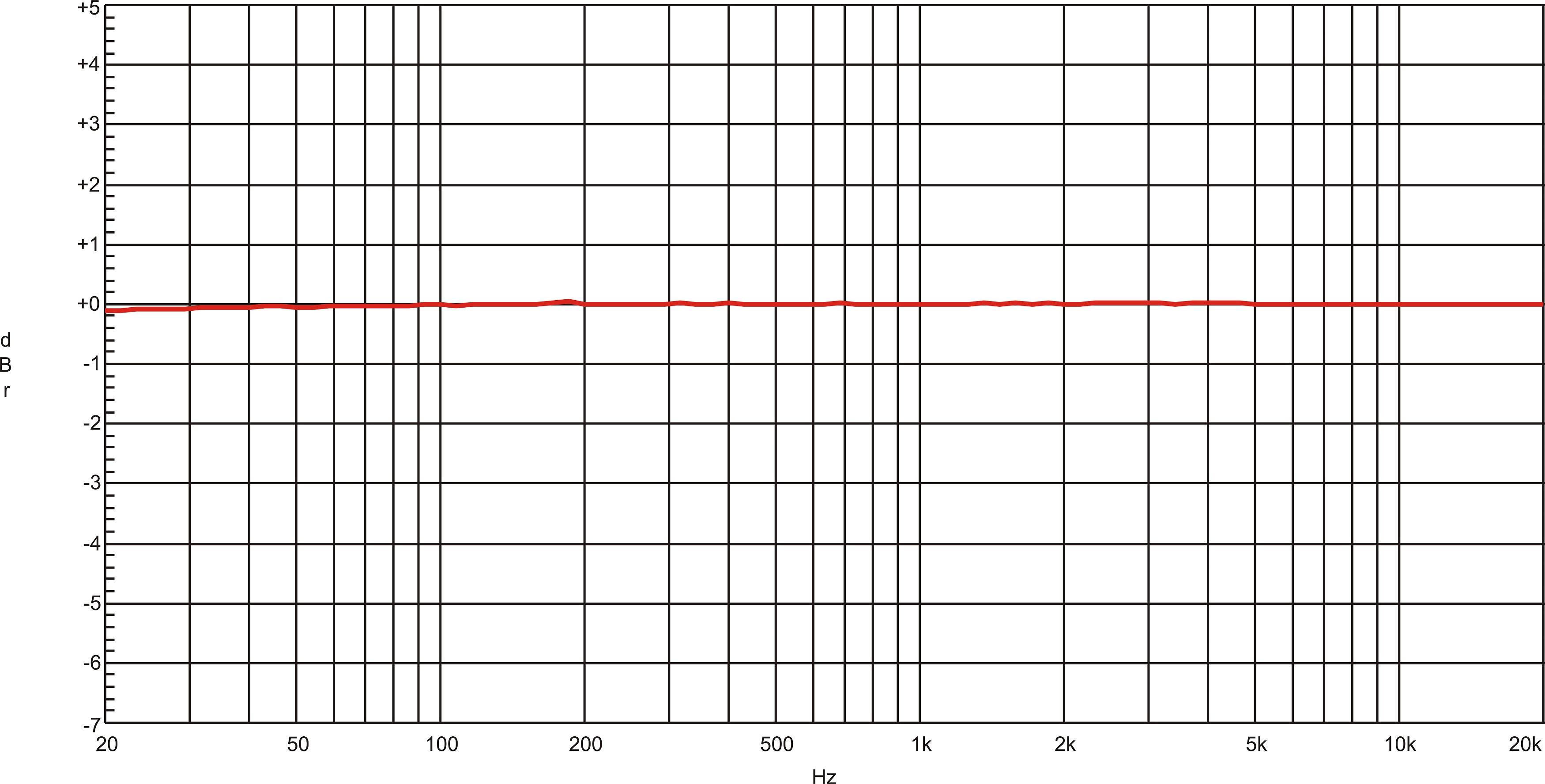

In fig 1 there is a freq answer of MM

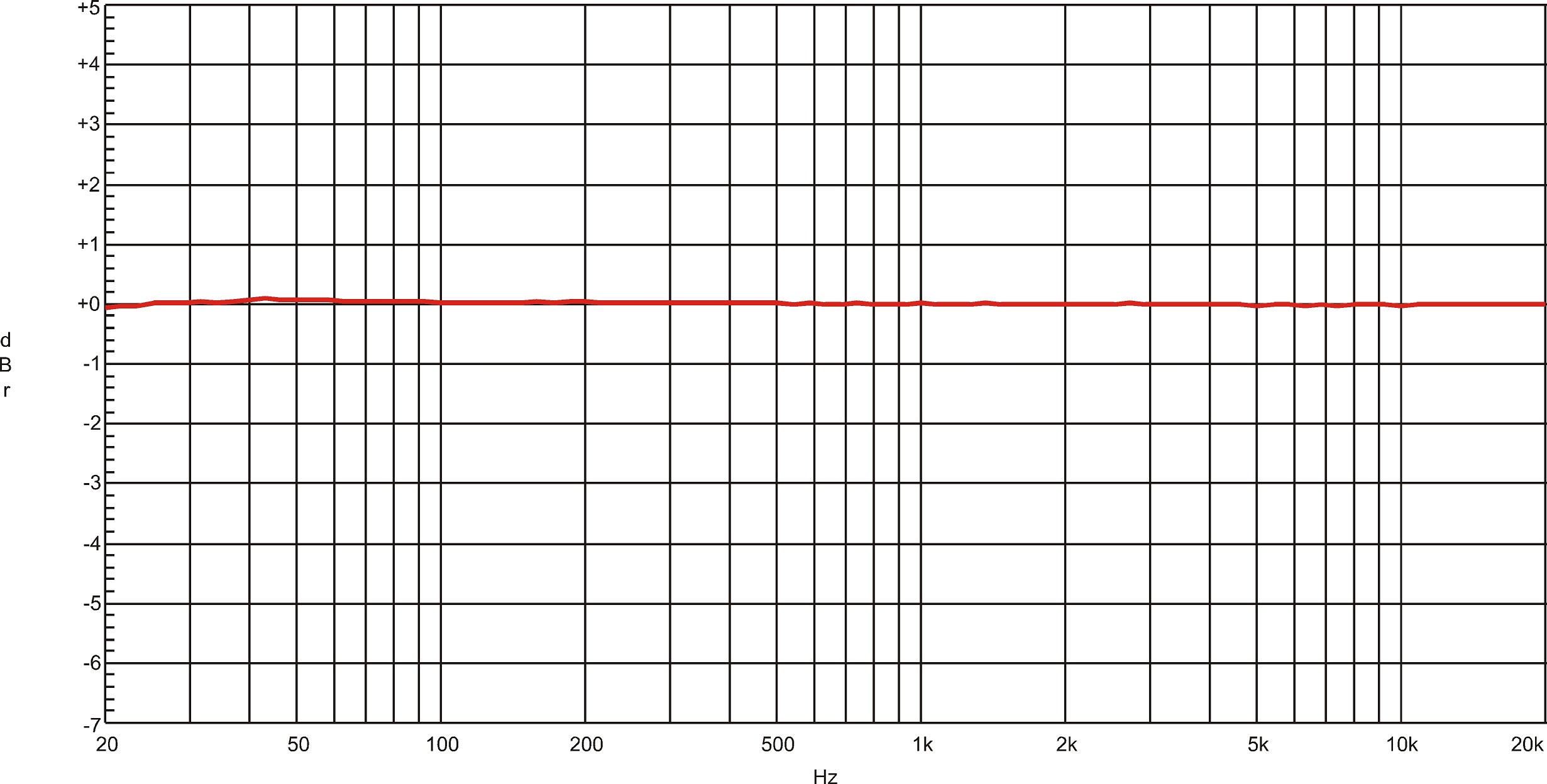

Fig. 2 is resp. on MC

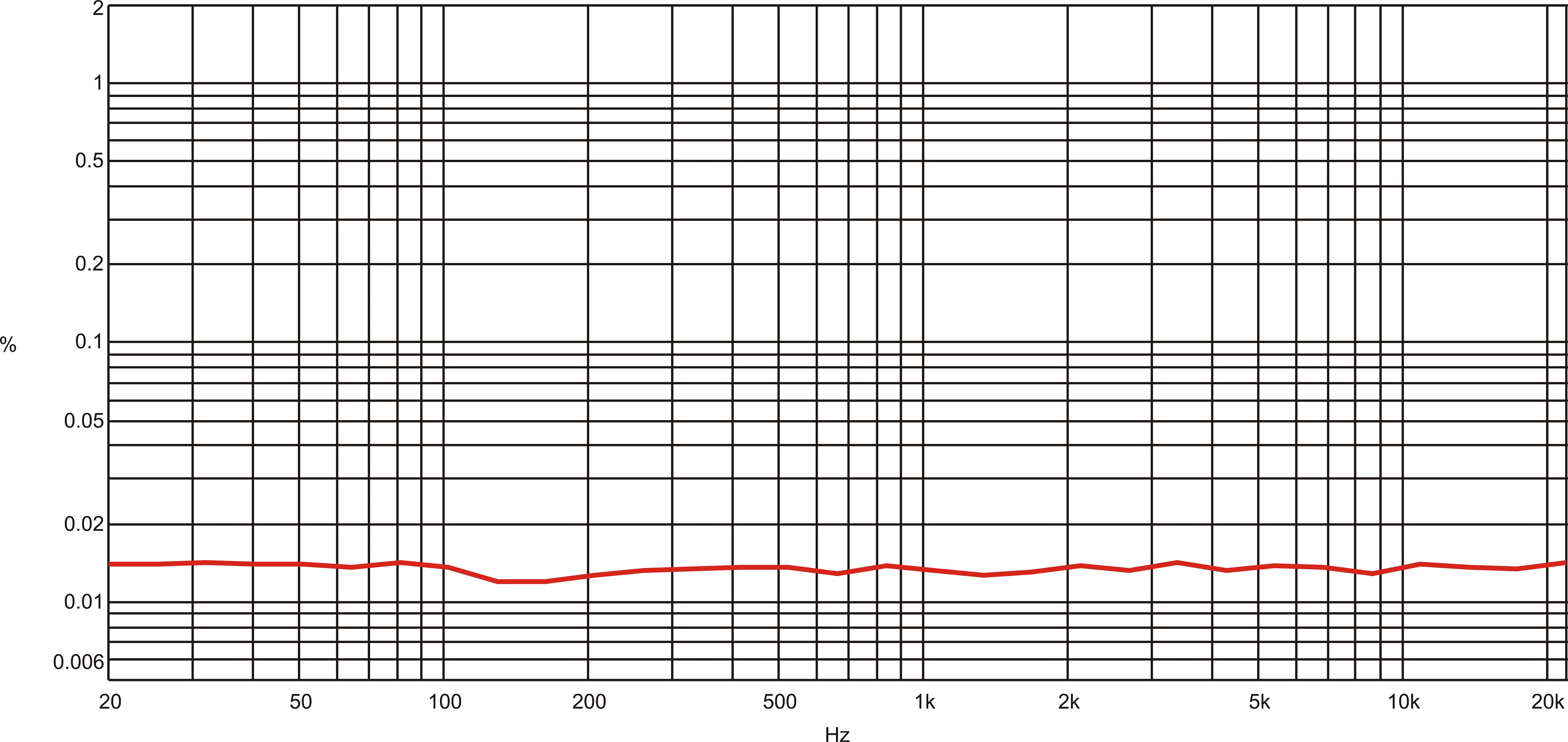

3 is the THD vs freq on MM stage

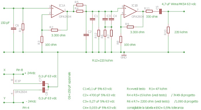

The circuit is 4 for MM
for MC is 5

Very interesting, and nice project.
I have a few small comments, I'd recommend moving those bypass caps to the boards, the wiring inductance negates some of their benefit.
I hope you have fuses in series with the batteries - if a cap or other component fails you can have a very spectacular fire.
