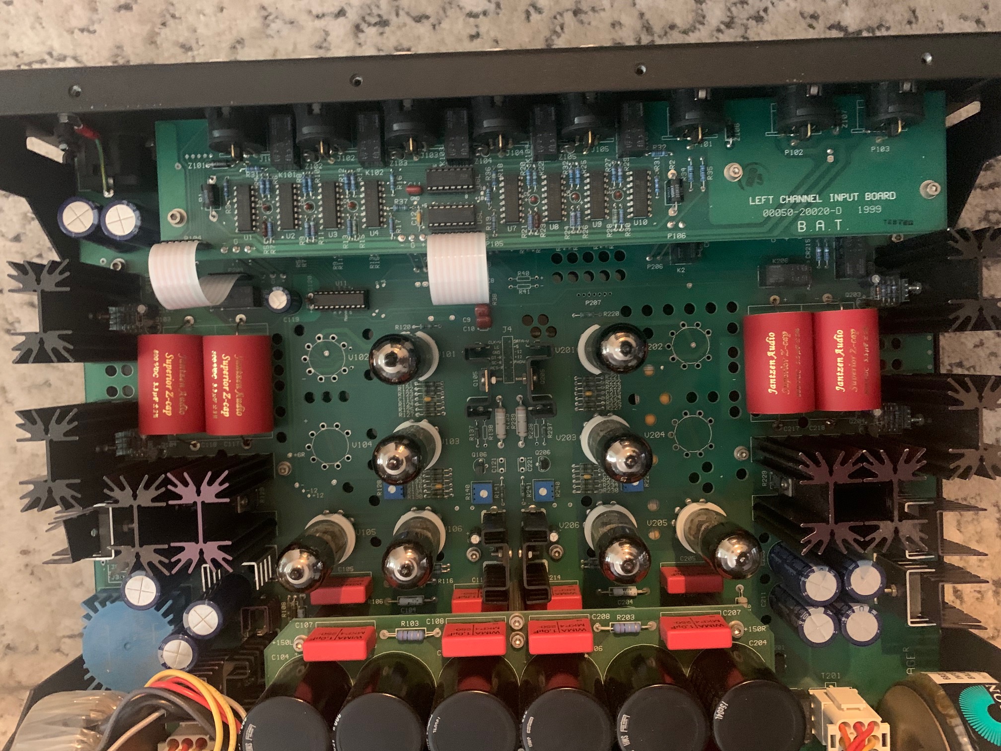

hello I want to replace the sixpack capacitors of the BAT VK51 SE and the 1uf jensen are not available.
Someone has changed them and what brand they have placed.

my question is:
could you substitute the JENSEN 1uf 650v OIL for MKP capacitors?
Someone has done it since the measures of the Sixpack is reduced having 6 capacitors.
What brand do you recommend?
No technical issues. The sound will obviously change.
