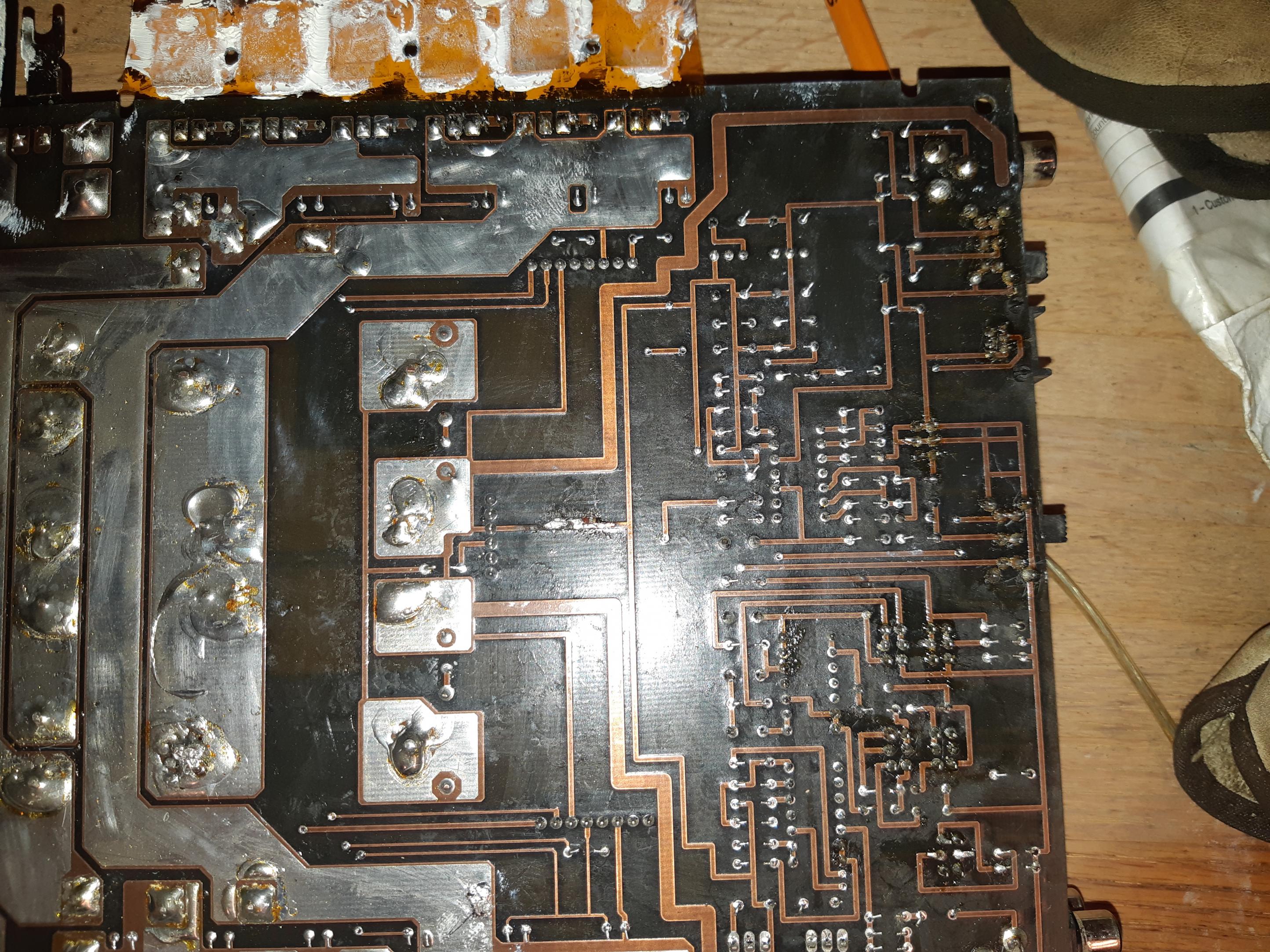

I picked up this amp for 30 bucks knowing it wasn't working properly. I powered it from my car battery and it powered up fine so I connected a subwoofer and audio in and no sound. I opened up the amp and noticed a burnt trace on the bottom side of the board. I repaired the trace and tried it again. I'm getting mild bass out of it but also a scratchy distorted sound. I'm lost at this point,any suggestions?

I'm not sure what circuit it was in, it was between the blue 106k250v caps, one of the pins on the driver board and to a resistor that is connected to tl074cn

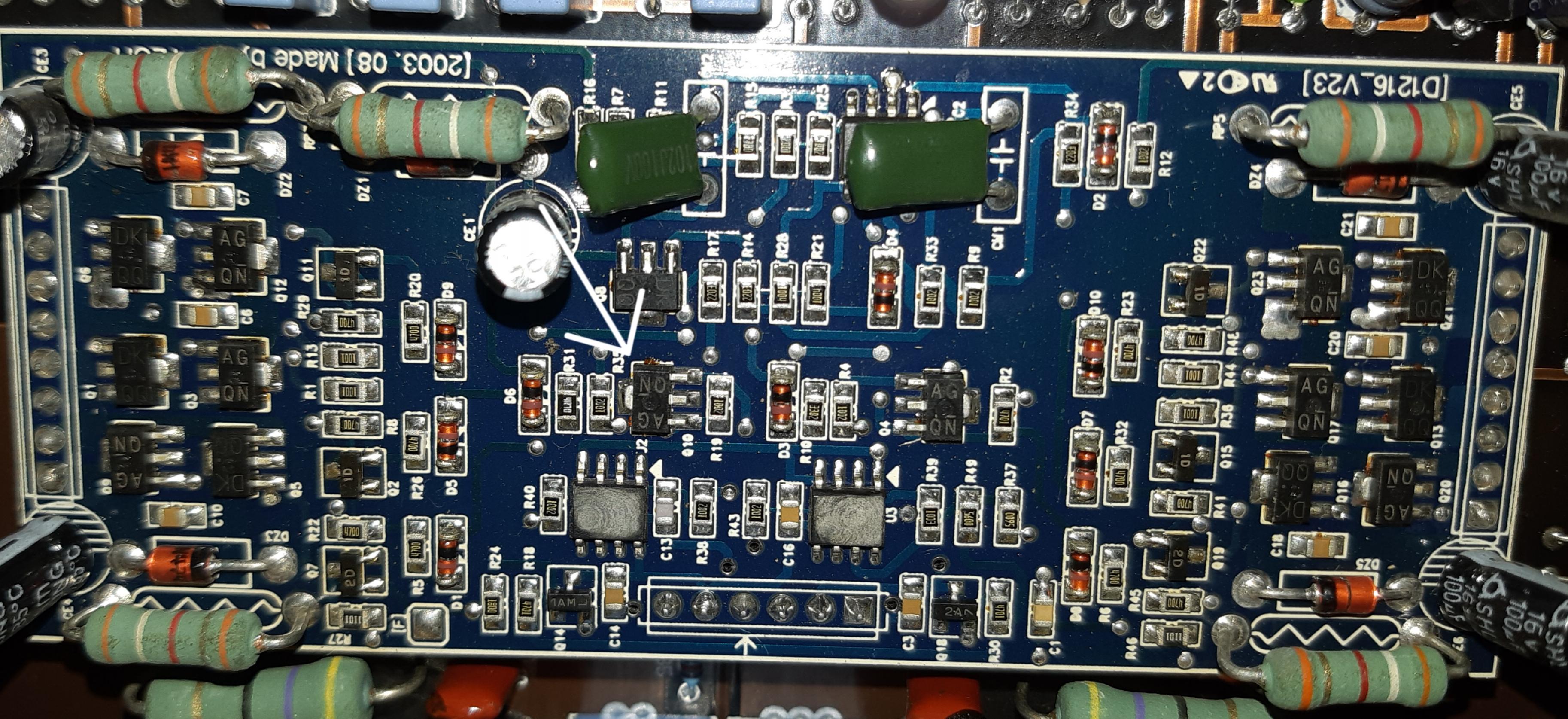

Hi Perry, I have rail voltage(35v) and I'm getting 27v between Vcc+/- pins on the op-amps. Since my last post I discovered a shorted transistor on the driver board I believe it is a 2SA1797-Q. I've removed it from the board to test it just to make sure it was the trasistor that was shorted. Is it common for these devices to go bad or should I be looking for other bad components that may have caused it to short out?

Is that a photo of the driver board in your amp? Or a photo from some other amp?
The transistor you pointed to is in the protection circuit. If it's shorted, it could cause the signal to be badly distorted.
The signal is badly distorted. When I was testing the voltages I turned up the gain with audio and the amp went into protection mode

That 4,7 ohm was in series with the protection circuit transistor that failed.
The 470 ohm resistors often open when the protection circuit is engaged for an extended period of time.
