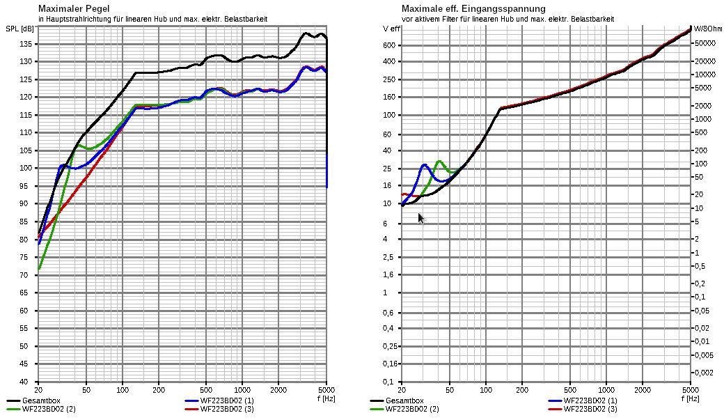

Hallo,
I have a question about max SPL with bassreflex and closed boxes.
I tried to calculate a ~70L boxes with Wavecor WF223BD in BoxSim and suprised by the output.
As you can see in the images, I've added 3 such speakers in a 40cm box, one closed (red), one BR tuned to 30Hz (blue), and one tuned to 40Hz (green). In the efficiency plot, the blue plot looks good.
For the maxSPL plot, I've set the max themal power of the speakers to above 1000W, to make sure we see Xmax-limited results. Just as I'd expect, details like volume of the box drop their influence on max SPL then.
But isn't only about 97 db max SPL @50hz a suprisingly low number for a bass of that size? And how does BR manage to get ~12dB maxSPL more @fb given an Xmax limit? Wouldn't +6dB be the outcome to expect?

According to loadspearkerdatabase.com, max SPL@50Hz in closed Box is 99dB (for both WF223BD versions, Xmax +/-6,5mm), also independent of volume, according to their CB sim.
Maybe Visaton's BoxSim just uses some 2dB more conservative assumption about wave coupling there.

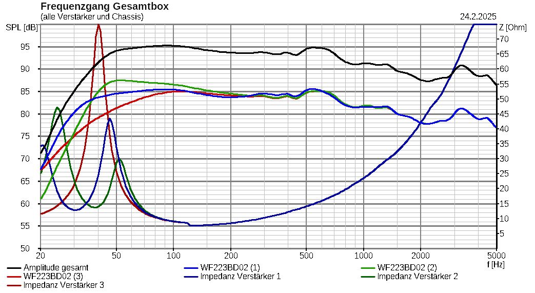

The plots include a simple crossover with 3 mH, 1 Ohm.
Baffle step correction was turned on (but when turned off, the +12dB instead of the +6dB relative to closed Box "problem"/question remains).
At Fb the driver cone barely moves, the sound output comes mostly from the bass reflex port.
Because of that the BR enclosure has a higher possible output at and around its tuning frequency.
The added possible SPL depends mostly from the tuning and the Qb.
For sealed enclosures the max SPL has a 12 dB slope.
Going down one octave requires the quadruple air displacement.
Only increasing air displacement or reducing radiation angle will increase the possible SPL (for sealed enclosure).

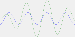

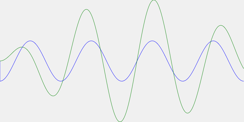

Great, looks like I'm wrong.
I've made a simple simulation script that shows me (modulo probable bugs) that vented air amount can get higher (much higher at fb, I think). But it also shows some addition (of fb?) at other frequencies. Given that (at least intended) style of simulation is something I really trust, the prob is probably solved.
