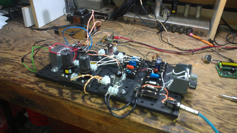

Thanks for all the detailed comments! I do like the AB165 preamp - makes the most sense. It's the power section of this version that has too many wierd things in it (feedback on the power tubes, OT feedback thru a capacitor to the grid of the PI tube, etc). But that's on my other thread (6V6/6L6 switchable..). I'm breadboarding it now, using a basic Fender preamp (Champ, Deluxe) and configurable tone stack. Will add an LTP/pwr board to it, get it up and running, and then play with the preamp. Thanks again!
