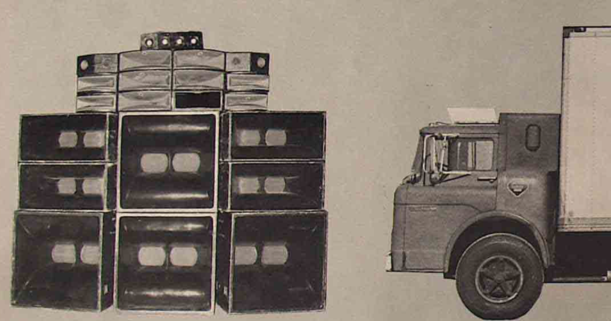

Uwe,
It can be done, but "a well designed vented box" will be larger than a "well designed" compression chamber for a front loaded horn.
The photo below shows an old (1979) system with ported compression chambers that attached to 45"x45"x30" deep straight bass horns, though the straight horns sealed the ports when used.
I only used the cabinet backs on one or two gigs without the bass horns...
Art
Art

2) A large "waveguide", say double the frontal area of the LF cabinet, will also result in around a 3dB frontal gain, simply because the increased frontal area results in larger boundary area. This larger boundary area works equally well regardless of the cabinet design, whether sealed, BR, TH, or FLH.
Although the old fiberglass horns shown in post #2 had a horn cutoff above 60Hz, the rather huge frontal area of the stack allowed the direct radiator response below cutoff to provide a fair amount of frontal gain to below 40 Hz.
