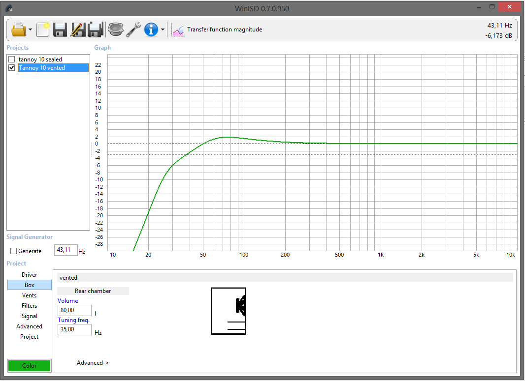

This driver needs a much larger box to go low i see with the specs (i used those of Troels) you give. A 150L ported with a round port of 10cm diameter and 15cm long gives a decent flat response i think. 80L is way to small for that, and you won't have and F3 of 35, but more somthing like 40Hz with a big 3dB bump in the response between 60 and 150Hz. if you still do an 80L cabinet, use a single 10cm round port of 16.7cm tells winisd me...
And as XMAX is not stated, it's hard to tell that this will really be the case for this driver. If i use a guessed xmax of 2.5mm (typical for this kind of drivers), the bass response cuts off at 100dB (8W) and full power (15w), there is a sharp cut at 80Hz due to that.

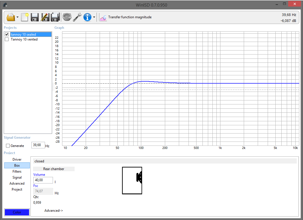

And sealed with the specs you mention, a QTC of 0.707 (F6 of 40Hz) needs a 194L cabinet, the 40L gives a QTC of 0.959 and an F6 of 50Hz

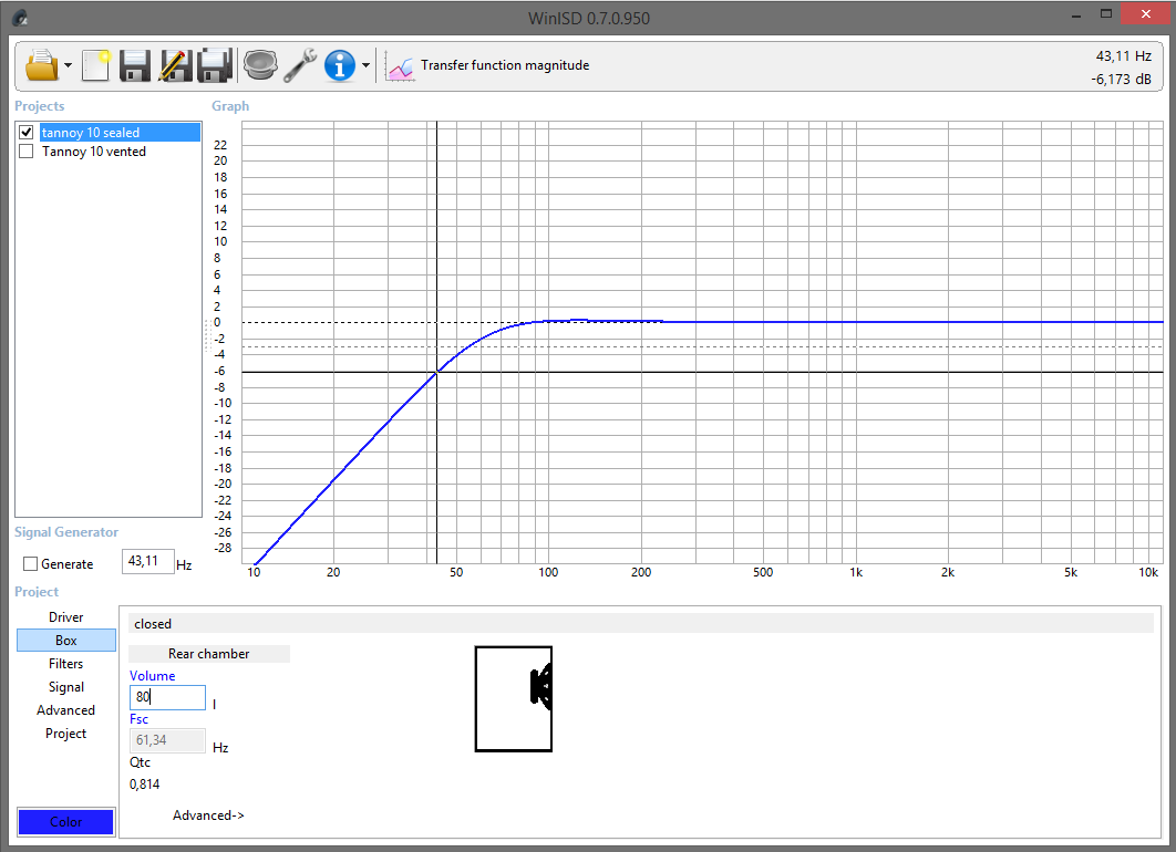

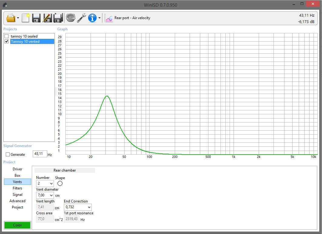

I use WinISD software to model, it's free and easy to learn if you know the basics about speaker designing. WinISD - Linearteam
I use the average specs of the list of Troels, and model both sealed and vented. I made a few printscreens so you can see (and adapted vented to 2 port systems). You can also manually calculate that (like they did before computers) but modelling software got very good these days, and WinISD, Hornresp and VirtuaxCad are excellent freeware. They can fast tell you what is possible...
I would rather use an 80L sealed for this driver, it's better fit, and it goes reasonable low. For sealed, you need to look at F6 and F10 to know the response, not to F3 like with ported cabs.

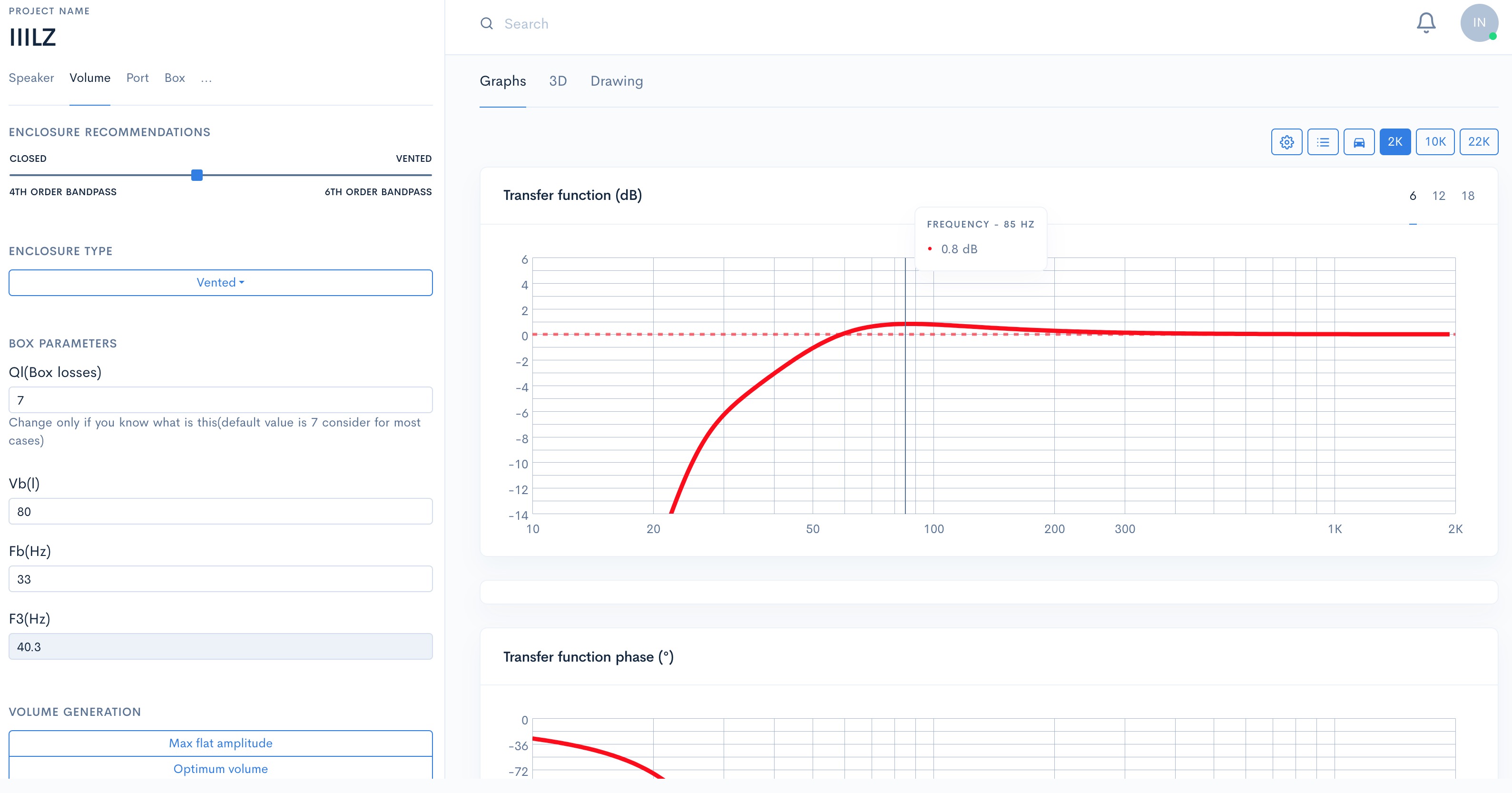

So I've settled on 80L tuned to 33Hz - 2x) 50mm dia ports, 103mm long. There's a ~1dB hump but I have to live with that, I don't have space for a 200L cabinet.
Before I start cutting things up I'd really appreciate any input from Dave (Planet10) or Scott (Scottmoose) - I know Dave has made an Onken style cab for an old Tannoy.
Would either of you suggest anything radically different than a ported enclosure?
