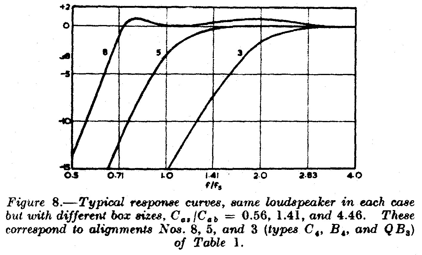

The original 1961 Thiele journal paper covered a lot of different bass reflex alignments that corresponded to particular values of Qts, h=Fb/Fs, and α=Vas/Vb. The Quasi-Butterworth (QB3) alignments generally had values of Qts<0.383, the B4 alignment had a Qts=0.383, and the Chebyshev (C4) alignments had values of Qts>0.383. Of course, when QL<∞, these Qts values are increased a little to compensate for the additional losses in the system.
The figure below is taken from the abovementioned journal paper. It shows the variation in low-frequency response that is representative of the C4, B4, and QB3 alignments. By adjusting the box tuning frequency (Fb) and the box volume (Vb) for any given driver, it is possible to get it to produce a response that is still going to be very useful, but one that does not correspond exactly to any of the "standard" low-frequency alignments.

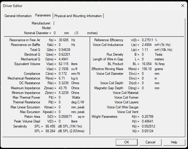

The DATS V3 can only be used to measure the free-air Thiele–Small parameters of the driver, or the sealed-box (Qtc, Fc, etc.) of a low-frequency enclosure. As far as determining the Thiele–Small parameters of a vented-box low-frequency alignment, it's possible to deduce Fb from the impedance minimum that occurs between the two impedance peaks. As a first approximation, the net volume of the enclosure can be used as Vb when calculating the value of α.I do have a Dayton Audio DATS V3 that I used to measure my drivers with and the friendly people over at Parts Express said this tool can measure the subwoofer's total Q (Qtc).
Note that it is possible to estimate the parameters associated with a bass-reflex low-frequency alignment from the measured impedance response. The measured impedance response would need to include the two impedance resonance peaks, some data close to 0Hz, and some high-frequency impedance data that is affected by the voice-coil inductance behavior.

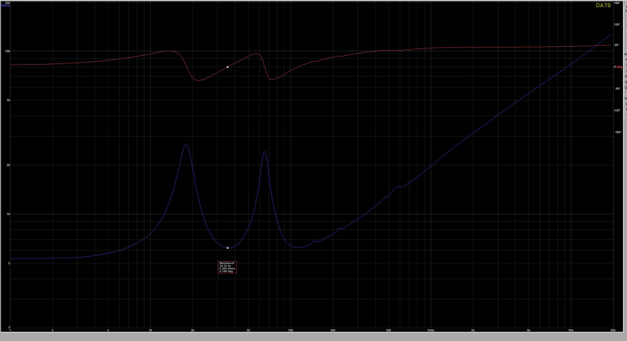

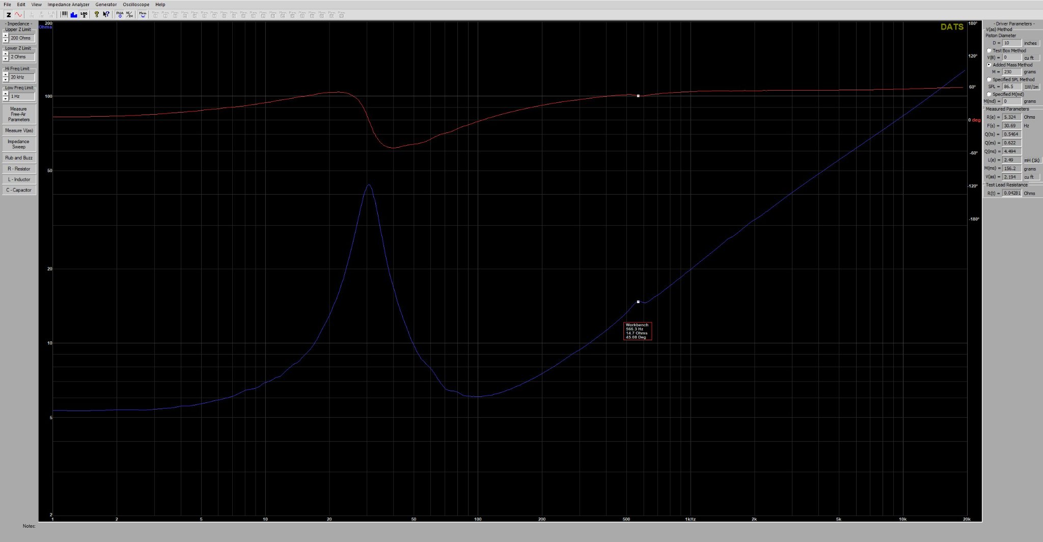

@Peaches2016 Was that in a sealed enclosure? Or a ported one?So I connected the driver to my DATS and then installed it back into the enclosure and ran the sweep. After the sweep was complete I got a Qtc of ".93782" (picture enclosed).
Can you show us a picture of the impedance sweep that was completed by DATS V3? It would help us to better understand what was going on, and then to tailor any comments accordingly.

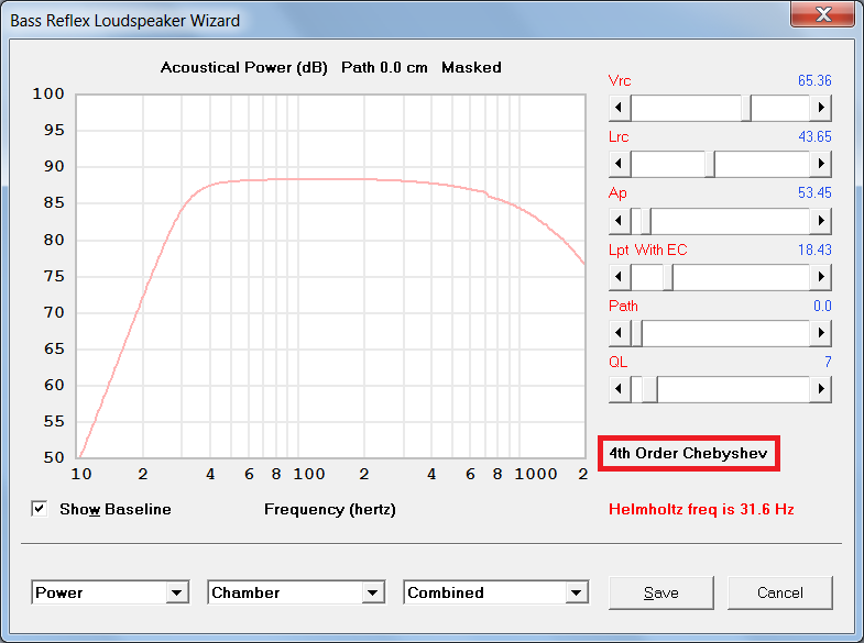

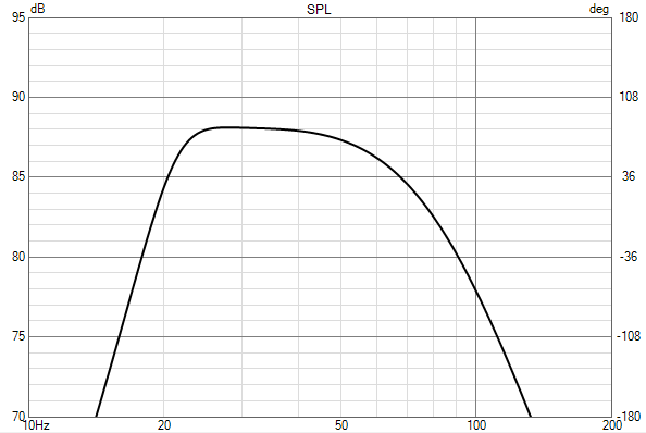

This driver, with Qts=0.55, is very well suited to a bass reflex low-frequency alignment. Below is the VituixCAD simulation of this driver in a 174-litre enclosure tuned to 23.0Hz. The −3dB point is approximately 21Hz, which is commendably low and useful in subwoofer applications.Here are the T/S parameters of the raw subwoofer driver if you need them.
Adding a Linkwitz–Riley 4th-order 80Hz low-pass filter produces the following response. Note how flat it is in the passband.

Thank you for the response. I have included two more screenshots, one of the impedance curve of the driver and another with the driver in the box when I was trying to find the port tuning (lowest point between the two humps) of the enclosure. This is a ported enclosure and port tuning is around 35Hz. I was kind of hoping that with this data I could find out the bass alignment, but let me know if there is anything else you need. If you need the internal volume of the cabinet and port dimensions I can provide that as well.

The vented-box impedance curve does indicate a vent tuned to around 35Hz. The cabinet's internal volume would help to determine an estimate of the low-frequency "alignment" that was selected. The vent dimensions would also be useful for checking the computed value of Fb against the measured value of Fb.

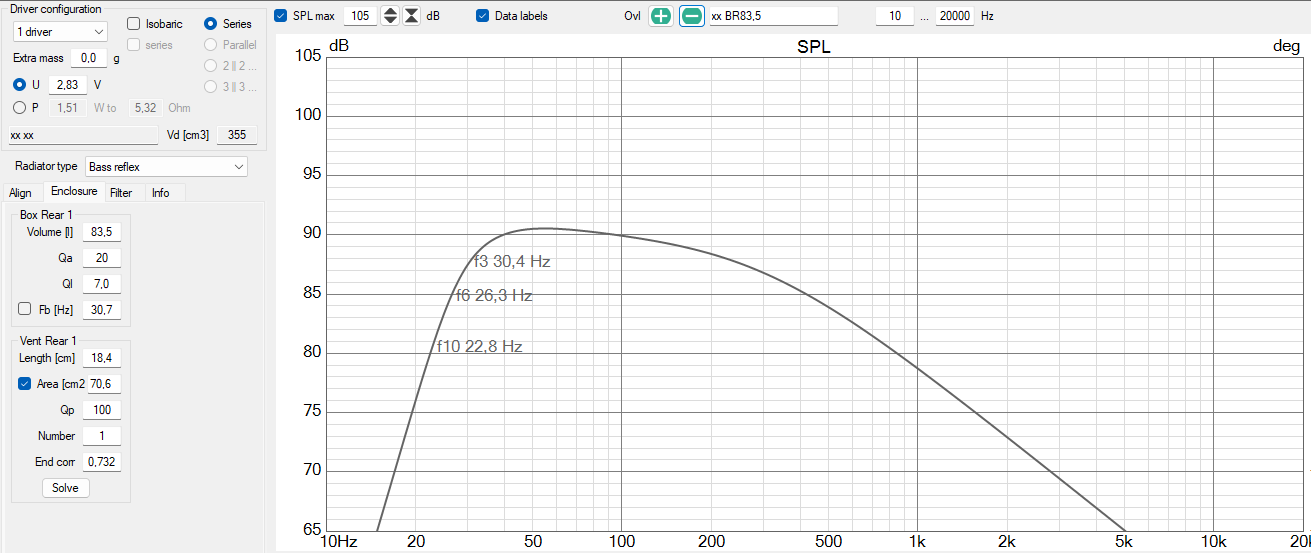

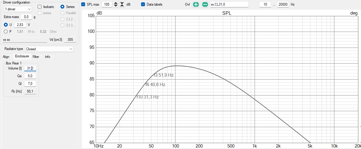

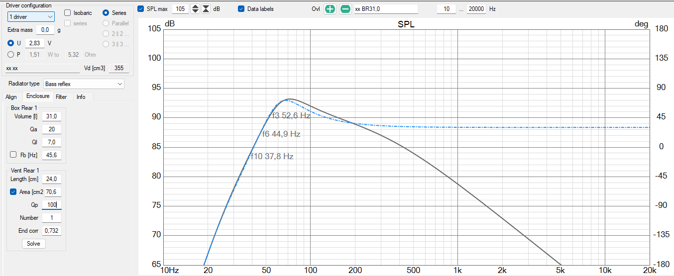

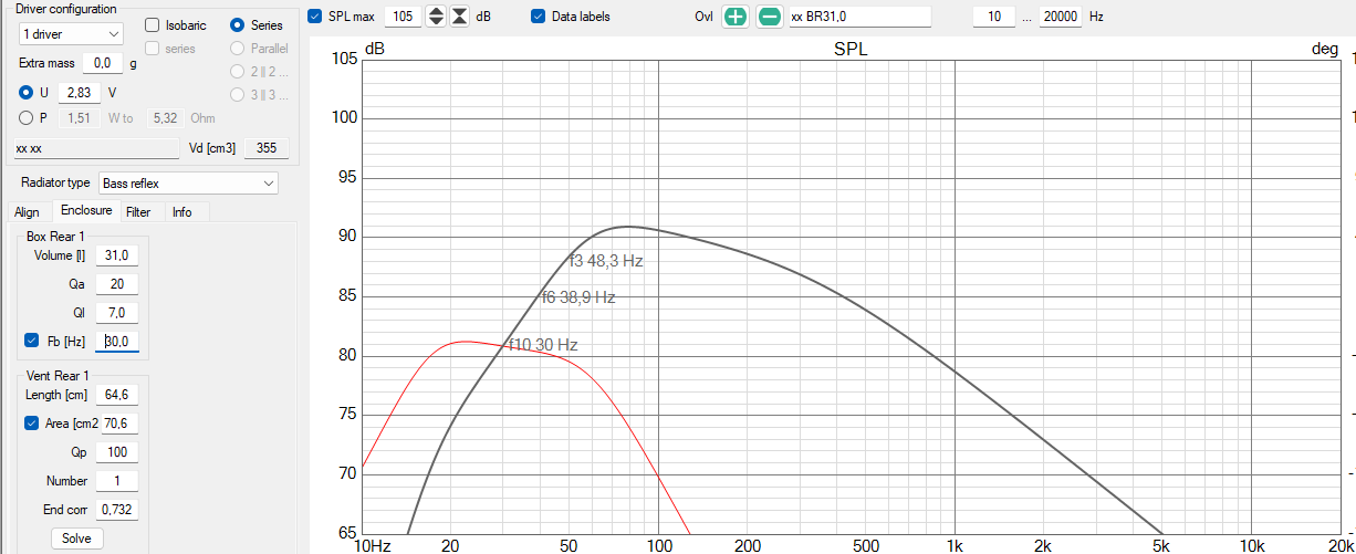

This is your alignment (31L @ 46Hz) with/wo the effect of the Le: you're right about the bump.
and this is a standard sbb4 alignment (84L at 31Hz)

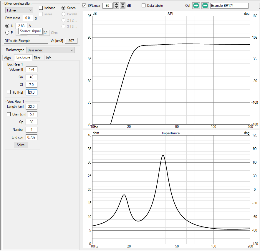

When I looked through the VituixCAD driver database, I spotted these drivers. They fall within the range 0.60≤Qts≤0.65, and are similar in diameter. The stiffness of their suspensions varies by factor of 10.8 even though their Qts values are quite similar (higher values of Vas correspond to a softer, more compliant suspension).
Even though they have very similar Qts values, based on the Vas value, the Fane driver would need a much smaller enclosure than the Dynaudio driver. Of course, the low-frequency cut-off of the two systems would be quite different.
Drivers with high Qts values can often be used with vented enclosures whose Vb > Vas by quite some margin. If it isn't, then the Chebyshev tuning with some passband ripple won't come into play.

The Hornresp Bass Reflex Loudspeaker Wizard allows the user to choose from the following options:
- Default Alignment
- 4th Order Butterworth
- 4th Order Boom Box
- 3rd Order Quasi-Butterworth
- 4th Order Chebyshev
Select the Tools > Design Wizard > Bass Reflex menu commands from the main Input Parameters window in Edit mode. Double-click on the alignment name to change option.
