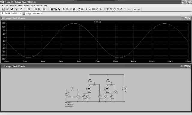

Gidday
apropos my preamp.
I've been playing around with spice models of preamps, and I've come the the following conclusions.
for a pre amp the 12ax7 has far too much gain.
So i've had a look through my collection and have found a couple of 12bh7as, this has a mu of about 17, twin triode, and it's a relatively high currrent device, used a lot in drivers etc., should be good for the tone stack.
I was also intrigued by the Blues-112 combo amp as shown in www.duncanamps.com, it runs the preamp at about 50v.
So i thought why frizzle your fingers when there's no need?
Have a look at the attached curves, the sine wave is a single stage 12bh7a running at about 60v with a 1 volt 100hz input, looks very nice.
my thoughts now are to put a gain pot [sensitivity] after the first stage, then another stage to drive the tone stack, followed by another gain stage, then a pot for overall volume to drive a cathode follower.
any thoughts?
Bill.

That's pretty much what I'm doing for my acoustic guitar amp. Gain, pot, cathode follower, tone stack, gain, master volume, phase inverter, power amp.
I like the idea of boosting the incoming signal substantially before the gain or sensitivity pot. Even a very large input signal won't overdrive the input stage if it is biased for it. Then the sensitivity adjustment to bring the signal to a desired nominal level for the rest of the journey.
