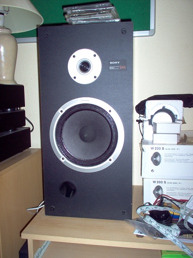

I recently built some partly home made speakers. In reality I used an existing cabinet for some old Sony 2 way speakers and converted them into 3 way speakers with a cross over. One bullet type tweeter, one 3 inch mid sealed back midrange, one 8 inch woof for each cabinet. The cross over is supposedly a 3 way cross over but is really just a 2 way cross over as the woofer is connected directly to the input. Not sure if this is the usual arrangement.
Everything sounds good except for the fact that I'm very disappointed by the bass performance. Initially it was worse, during the first test even though the speakers were loud the bass fell horribly flat. The bass ports were also blowing tons of wind, almost like a fan. Adding a layer of insulating material to the inside of the cabinet helped a lot to my amazement. It cut down on the wind effect and made the bass sound better. It also made the cabinets stop walking around like they were initially, I couldn't keep them put. First I added one layer and then another which improved things further. I did not add more after this point as I figured past this point it would begin muting the sound based on a previous experiment I performed. The cabinets still vibrate and move on the floor a tiny bit but not much.
Regardless of the improvements, the bass is still honestly kind of crap. The bass isn't absent just sounds like there's way too little of it and turning it up further does not help and ends up pushing the other drivers into distortion. Kick drums seem to sound okay but bass lines are barely there. The woofers themselves seem to be working their ***** off but aren't producing much actual sound. If however I go to the corner of my room where my bed is, they sound like what I think they should sound like all the time. If i go back and stand in front of them, again nothing. I know room acoustics play a big role but I feel they should sound a lot better all on their own. Since these cabinets were made for 8 inch woofers to begin with I did not expect there to be a problem with an incorrect cabinet size for these woofers but it seems that this is what is happening.
The cabinets are 55.5cm tall 32.4cm deep and 22.8cm deep. Wood thickness is about 1.3cm. One of my doubts about these cabinets are the ports. They are about 5.4cm in diameter but have no pipe, in other words it's just a hole in the front of the speakers with no port going deep into the cabinet.
I'll admit I used some pretty generic speakers, I know i'll probably lose about half of you there, but the mids and tweeters sound decent. I feel like the woofers despite their cheapness should still be capable of more than what they are doing now. They may be falling a bit flat but the bass isn't totally missing and when I get in that corner of my room they sound amazing. I feel like they are perfectly capable of doing better.
My question would be what is causing this? Perhaps I need to make the port smaller or larger? I tried sealing the port and it doesn't really help. At one point I removed the connector panel at the back for the cross over and having that "port" open gave some very good sounding bass but only if i stood directly behind the speakers. I'm also guessing that the fact that these still walk about the floor a little bit means that these cabinets are still flexing a bit too much and may be wasting energy.

The boxes are probably tuned too high because the "ports" have a really short effective length. This causes the port to act as an acoustical short circuit at low frequencies - a literal hole in the box. The port and woofers work against each other at low frequencies delivering weak bass in to the room and woofer excursion becomes uncontrolled.
If you are unable to model the woofers/boxes using a program like WinISD or BassBox Pro, try experimentally lengthening the ports by extending them with some tube/pipe.

"Wood thickness is about 1.3cm. One of my doubts about these cabinets are the ports. They are about 5.4cm in diameter but have no pipe, in other words it's just a hole in the front of the speakers with no port going deep into the cabinet"
That means "tuning" at around 150Hz. No wonder there is no bass!
25cm port length gives tuning to 33Hz, try that! The test port can be outside and final port tube may have a bend to fit in the enclosure.
I made some pipes out of thick construction paper to experiment. At 25cm that definitely helped while listening to a 40hz signal. Cleans up and "rounds up" the sound instead of sounding like speakers that are just flopping around. For now I've installed these semi permanently using a slight bend of the pipe to make em fit.

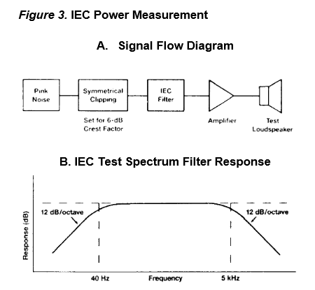

Power testing a driver is actually quite precisely defined below in terms of bass loading, something you evidently wouldn't know from a hole in the ground... 😀
A high efficiency 8" bass is actually unlikely to be comfortable with more than 25W rms.

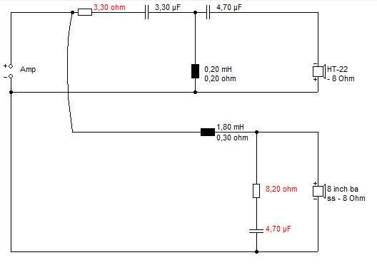

I know this sort of thing well enough:
That's how it is done. Crossovers matter too. You usually need a coil at least on the bass unit.

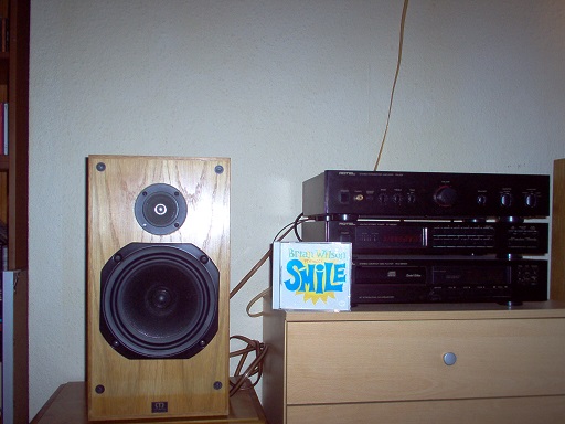

I like my two-way closed box speakers. Nothing pricey there.
Nothing too hard in the crossover either:
