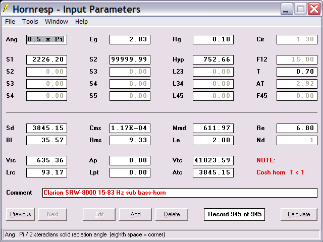

Here are the specs for the driver: Fs 17Hz, Vas 87cu/ft, Mmd747grams, Qes .43, Qms 8.58, Qts .41 Sd 596 sq/in, max stroke 18mm, SPL 97 1watt/ 1 meter, 300watts RMS, 1000max. I'm afraid these are the only secs I have. I'd like to put it in the basement and vent it into the listening room.

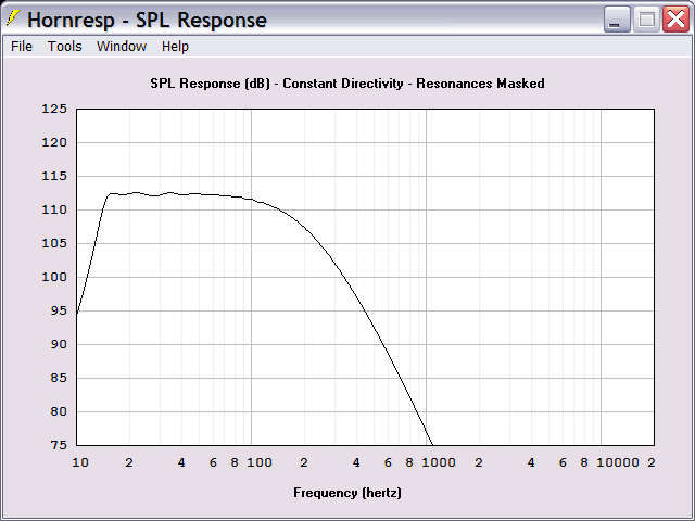

OK, 'crazy' I can do
HornResp limits mouth area, so can't get really 'crazy' with 15 Hz being the lower limit for a full size mouth plus any room gain, so while this is a reactance annulled alignment its LF extension can be increased by using a larger rear chamber and letting room gain pump its response back up.
GM
GM
The curve looks great GM but some of the spec #'s look odd to me. I must first apologize for not being familiar with hornresp. I tried to download it twice, but it will not run on my computer. I'm OK with the exponential flare, but need to know the throat and mouth area. As well as the lenght. Thank you. I like your identity pic. I have the book that photo came from. I have read the book, but have yet to apply or understand it's teachings. Thank you for your time.
SIRDRINKSALLOT said:I tried to download it twice, but it will not run on my computer.
Hi SIRDRINKSALLOT,
Have you tried running Hornresp Version 20.00 or later? The program was converted from 16-bit to 32-bit operation at Version 20.00, which might make a difference if you had been downloading an earlier version.
Kind regards,
David
SIRDRINKSALLOT said:The curve looks great GM but some of the spec #'s look odd to me. I must first apologize for not being familiar with hornresp. I tried to download it twice, but it will not run on my computer. I'm OK with the exponential flare, but need to know the throat and mouth area. As well as the lenght. Thank you. I like your identity pic. I have the book that photo came from. I have read the book, but have yet to apply or understand it's teachings. Thank you for your time.
You're welcome!
Actually, since HR's alignment using its design Wizard ~ matched my calcs I just posted its results.
You'll have to be more specific about the odd specs. All I did was input yours plus assumed a 6.8 ohm Re since I found out it's a dual 4 ohm VC driver, ergo a nominal 8 ohm driver if wired it series. BL, etc. is calc'd by HR based on the T/S specs you listed.
Ideally you need to figure out why you can't get HR to run in case you want to make any changes or just try to find a different alignment.
throat = 2226.2 cm^2
mouth = 99999.99 cm^2
length = 752.66 cm
rear chamber = 635.36 L net
front chamber = 41823.29 cm^3 net
Obviously, at these sizes, rounding off numbers is not going to be audible.
GM
