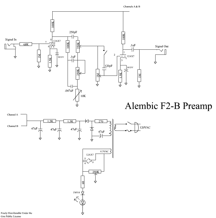

You could try to build the one in the picture. It's a very simple schematic and sounds very good indeed, I recently built one myself. The original Alembic unit has two identical channels (which are modelled after Blackfaced Fender amps). I built a preamp with only one channel, and added "bass-shift" and "treble-shift" functions like present in the Mesa Boogie Bass400. I have built that preamp as well (a long time ago), and didn't like it much.
I did redesign the powersupply with DC heater supply, and B+ with a overkill amount of capacitance (had a bunch of caps lying around).
The preamp is easy to build and sounds super, I would say a fine candidate for a first project (if you treat the HT with the appropriate amount of caution).
Looks nice and simple but since you use both halfes of the 12AX7, wont that produce way too much gain? Have you measured you "maximum" output signal voltage?

I am not much of an EE guy (rather ME) so I didn't measure anything, but this schematic is built by Alembic so I just considered it a finished design. I did hear someone say there is a mistake in the schematic somewhere.
But you are right, when using my (active) bass, the output is quite "hot", I am thinking of adding a 6db pad.
