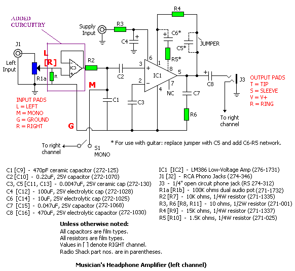

I changed this curcuit to reflect the changes you suggested. What size would the resister in the purple box need to be if I use a 250K ohm pot? And did I do it right? I have some extra LM386 IC's that I would use for IC3.

Hi jman 31,
shematic you posted is not too smart for guitar. Pot in input for instrument is bad idea.
Better way - take simple Cmoy shematc with 10K volume pot, and before pot put input buffer ( take first opamp schematic from your posted schematic without pot, input directly to opamp's +in, R- 1Mohm).
you don't need any caps in signal path, guitar have not any DC on output.
if you need amp for guitar only, you don't need stereo, use one dual opamp - one half for bufer, other for Cmoy amp itself, connect output to both phones.
if you need "universal" amp, use dual opamp for Cmoy part and other one channel opamp for buffer.
Good luck!
Zigis.

Thanks for the input, but you have got me more confused now. I am very visually oriented. I will sit down when I get a chance and work up a schematic for what I think it is you are saying.
Am I getting it right that you are saying to use the LF353N Dual Bifet Op amp that I have as the amp, and one of the LM386 op amps as the buffer that wxn was trying to explain?
TheSeekerr said:
Other way around - you need high input impedance for the buffer, so use the Lf353 opamp there (BTW, why scavenge opamps? They're cheap....), and then use the 386 for amplification duties.
