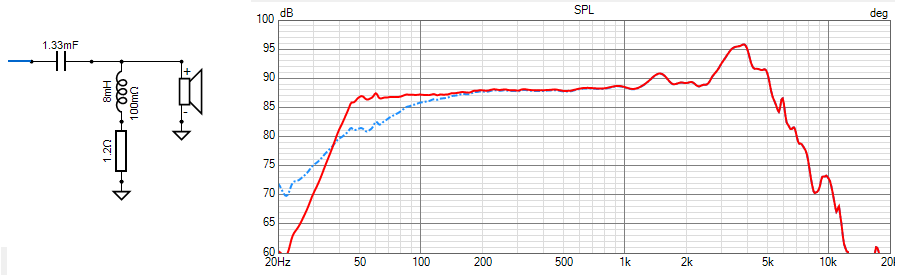

Example. I can increase the order and extend the bass as simply as using a high pass filter.

What you describe is the way it happens when you change the size of the box. You say this is active? Maybe that means the frequency stays the same while the response around resonance goes up.
It depends where it happens. At 70Hz a peak may be ok, but not so much at 150Hz.
