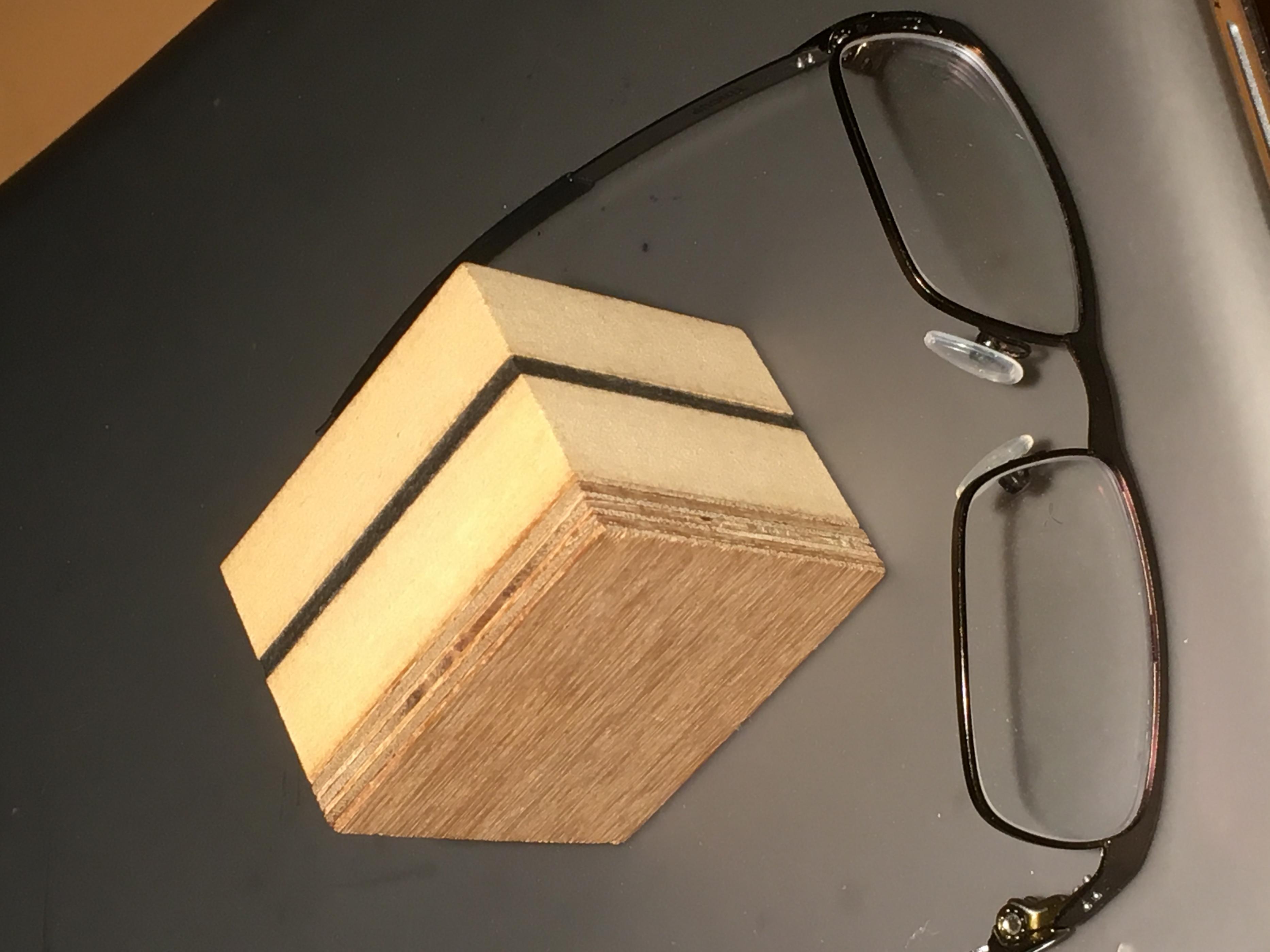

I did some testing before I settled on mdf. Like many others, I have been suspicious of the use of mdf, so I made up some 30 X 30 cm (1 ft square) test panels of constrained layer construction. The damping layers were 1) Sikaflex-Pro polyurethane sealant adhesive, 2) Bostick glazing silicone, 3) 3 mm rubber sheet, 4) polyurethane wood adhesive, 5) Fiberglass resin. All the damping layers were 3 mm thick. The constraining layers are 18 mm mdf or 18 mm birch ply. The objective tests was to drop a 20 mm steel ball bearing from a fixed height onto the test panels, which were either clamped at two edges or solidly held down onto a 150 mm (6") thick concrete slab. The height of the rebound was measured on a calibrated scale. The lower the bounce, the more energy absorbed. To cut a long story short, the best performer was mdf+Sikaflex-Pro , with the mdf+Bostik a close second. The worst was mdf+fibreglass resin and close behind mdf+polyurethane wood adhesive. In these last two cases, the high bounce was accompanied by a definite "ping". Most unpleasant! The mdf+Bostik glazing was the best choice for a couple of reasons. a) Cost; half the price of the Sikaflex, b) ease of extrusion; the Sikaflex was very hard to pump out of the gun, a real issue for large areas. The subjective test was listening to the signature of the ball bearing impact. All of the plywood panels sounded distinctly boxy, woody and coloured, and were rejected. As for isolating the mid-treble from the woofer, I have used sorbothane hemispheres between the enclosures with excellent results.

I must have built at least a dozen pairs of speakers since I asked for advice. To cut to the chase, the most effective technique I have found for controlling box vibration is opposed reaction cancelling woofers, as suggested above by planet 10 and chris661. It is spookily effective. I have completely abandoned my reservations about this technique.

That's because the topic never dies! Back then you said "mdf+Bostik glazing was the best choice for a couple of reasons. a) Cost; half the price of the Sikaflex, b) ease of extrusion; the Sikaflex was very hard to pump out of the gun,"This sure is a Lazarus thread...
--> Is that still your best? Or any revision since then?
I kept a constrained layer sample about 60x65mm sitting on top of my speakers as a conversation piece for 8 years now. The silicone constrained layer is still pliable, definitely not hardened. Despite this, I can't pull it apart. The only time I managed to separate a sample, I had to put it in the vise and with extreme force the mdf failed rather than the silicone interface. This is still the best readily available damping layer I have found. Just make certain it is glazing standard silicone. This is designed to be flexible, durable and uv stable.
Despite my success with cld speaker construction, I am a huge fan of reaction cancelling woofers. My preferred strategy is separate enclosures for the mid/treble (cld) and bass (reaction cancelling opposed woofers).
