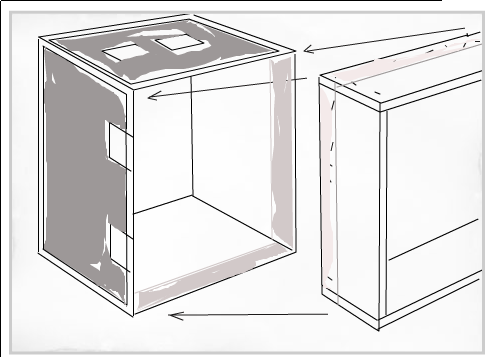

Here's the challenge:
The size of the outer box is fixed:
I want to turn it into a good high-power (SPL) Bass Cabinet.
I would use either a 12" like the MCM (price and specs are good!),
or a 15" woofer.
The shape seems to cry out "folded horn", "tapped horn", "Karlson-mod" or something!
It should be loud enough for medium/small gigs,
but not require scads of amp watts to drive it, hence my 'horn-tech' appeal.
Here's the idea:
I turn the top half of the cab into a bass-guitar-cab,
with the speakers facing down.
To protect the speakers during transport,
you could have a shorting-jack to freeze the cones.
Now the bottom is like a speaker-cover with wheels.
You wheel it around face-down,
but for playing you unclip it from the wheels/bottom,
and tip it on its side.
The inside dimensions are about 20" x 26" x 14" = 4.2 cu. ft.
Minus some reinforcement/folding hornwork, say about 4 cu.ft. or less.
Is that enough for a couple of 12" or a 15"?
It needs a good cleaning out.
It had some drum parts, and alot of deteriorating foam in it.
Please, those of you who love THs, or Karlsons, or FHs,
give me a clue in the way of a usable blueprint.
I'm an ok carpenter, but I'm not a pro speaker-builder!
It could be in the form of a slip-in inner cabinet,
or just a framework using the outer-cab itself, with reinforcements.
All ideas welcome!

The first cabinet I built was a Karlson, I did not like the midrange coloration the "Christmas Tree" creates.
I sold the cabinet to a bass player who did like that sound.
A Karlson is a BR, the added air mass in front does tighten up the bass a bit, but not enough to negate the coloration IMHO.
You need to define how low you want to go, the low E on a four string is 40 Hz, the low B 32 Hz.
Hitting either fundamental with a TH that size will require a lot of folds, adding a lot of weight, and won't be much, if any louder than a BR. A TH will only be flat for the bottom two octaves or so, then has huge peaks and dips.
I would not consider a TH to be usable for bass guitar unless using a top cabinet above it, requiring DSP for proper integration.
The size mentioned is far to small for a FLH (FH) unless you don't care much about the bottom octave of bass guitar, and upper articulation.
A low tuned BR using a 15" would be the best bang for the buck, a 2x12" with the right cones could go a bit louder, lower and higher.
That said, the most popular bass cabinet is the Ampeg SVT, using 4 pairs of sealed 10" speakers. It rolls off at 12 dB per octave from around 60 Hz.
You could fit four 10" in your cabinet using a "V" shape baffle, which could extend in to the lid. That would be my choice, ported or not, if ported I'd choose an Fb below the low string's fundamental frequency to keep the cones from flapping on low notes.
Art

Okay, I just measured the inside of lid, and it will allow
an additional (outer dimensions)
20" w x 26" t x 6" deep extension, of lets say 3/4" plywood front
18.5" x 24.5" x 6" (internal) = 2379.5 cu in = 1.38 cu ft.
That brings the cab to well over 5 cu ft of space available internally.
Thats the same or larger than a Marshall cab.
i.e., it should support 4 x 10" and give good bass,
or 2 x 12" as a simple closed cab (or small ported).
but I'm still thinking there's now room in here for a Karlson...

Here's what I was picturing:
This frame would snug-fit inside the box, extending it 6 inches.
2 inches would overlap, for something to screw to (total of 8 inches).
This makes the box effectively about 20"x20" x 26" (external).
To keep the cones from flapping, AKA unloading, port the cabinet around the low E or B (40 or 32 Hz) there are many online port calculators to determine what size and length port(s) to use. Dividing the cabinet internally in to two sections is a good idea sonically, and would allow more amp /impedance flexibility.Wow that also would be great, to cram 4 x 10" in there!

Slapping or popping strings can put out full tilt boogie power down to only a few Hz, so you need to watch that.
Sealed cabinets (like the 8x10" SVT which has four chambers) provide more cone control down low, but have less output down low than a BR.
I prefer a concave "V" for the extra air load it provides, but a convex "V" would work O.K. too, ether would allow 4x10" in the cabinet.
