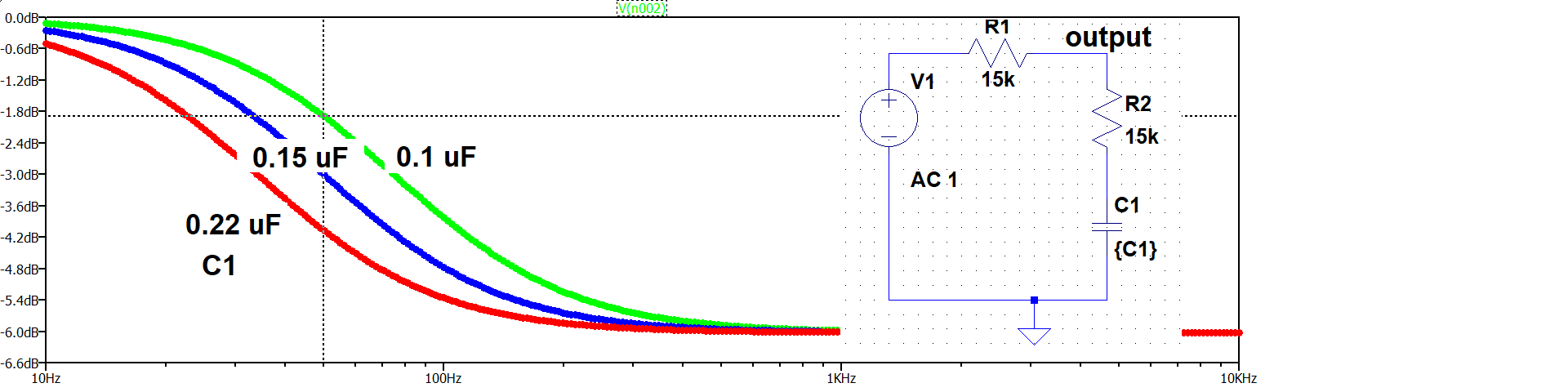

I'm getting ready to build a very small bluetooth speaker using the blue Sanwu 3118 mono board. My main aim is getting an ok(ish) bass response. Since I already know that my box is really too small for any meaningful bass I would also like to add a simple bass boost, something like 6dB at 50Hz. I'm a total noobie at all of this so I reckon a passive design would be easier? I'm fine with losing gain.

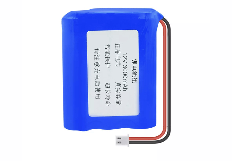

The other thing I need to understand is what effect different input voltages will have on the output wattage. From what I've read I can run this with a pack of 3 18650 batteries like the one in the screenshot below but I can't find a way to figure out what that gives me.

And regarding that boost, it can not be done by passive components. You can only attenuate with passive filters. So basically you could attenuate everything else but the lower frequencies to get that "boost"
Yes, TPA3118 will work with that type of pack. You can check the output with specific voltage from here, page 10 onwards: http://www.ti.com/lit/ds/symlink/tpa3118d2.pdf
Firstly apologies for posting this in the wrong thread (can it be moved?) As for the boost I didn't express myself properly. I understand I can't add passively, which is why I said I don't mind losing gain. I suppose the correct question would be how to reduce everything above 50Hz by 6dB. The box I'm planning to build will be around 0.6 litres and I'd like to use the Tectonic Elements TEBM35C10-4 BMR. To my mind that would be a good way to go for a small mono design due to its wide directivity.

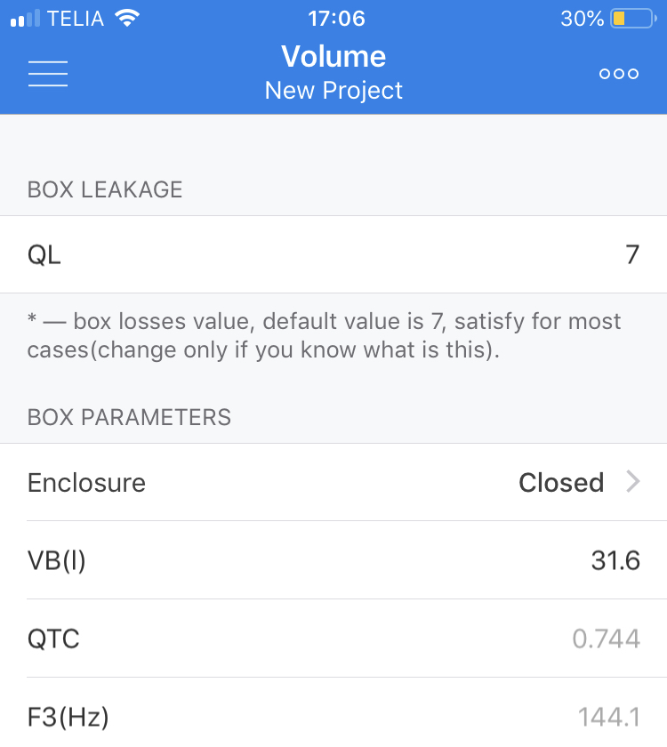

I was also considering the Dayton Audio MD65-4. I was playing around with speakerbox lite and ended up with a O.6 litre box with FB and F3 values just over 70Hz. I checked back today and FB has now been replaced by QTC, not just for my driver but also for any driver I looked up...
I had a look at that driver in WinISD. Were you planning sealed or BR? 0,6 liter sealed has -3dB at 118hz. With BR you could get something below 100hz, it has -3dB at around 73hz. Tuning with regular port will be almost impossible, so I would advise to use a passive radiator.
