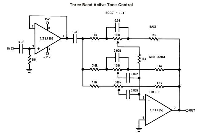

Re: LF353 (dual channel op-amp) and the circuit @ http://www.national.com/images/pf/LF353/00564939.pdf ... The SoCal Anon1: " ... It could double as a buffer ..."
I might also suggest leaving the first half of the chip, the unity gain stage, outta the circuit altogether, thus eliminating one of those pesky capacitors (and some of the THD) outta the audio signal = modest improvement in the sound.
If the input is directly from a well mannered pre-amp (with little or no DC offset and the gain firmly under control, higher output impedence, etc.), then there only need be a single cap in the audio signal = the single 1.0 uF non-polarized = 😀 ... in which case, the op-amp could be one of my favorites (see my avatar image) ...
Re: Costs of op-amps. If you have to ask, you can't afford to use a cheaper one ... Most single channel op-amps cost way less than US$10, dual channel op-amps less than US$12 ... speciality purpose op-amps can cost upwards of US$20 and the higher the cost, the closer they are to either obsolesence or beta development (untested in the field). The main stream op-amps are the ones that work well and cost the least ... IMOP
Any sample op-amp on this page = less than 5 US Bucks : http://www.analog.com/en/prod/0,,759_786_AD825,00.html

I have used this circuit quite a few times and had very good results....
it would be good to put an Inverting unity gain buffer before the circuit so you maintain the correct Phaze/Polarity....
" ... it would be good to put an Inverting unity gain buffer before the circuit ..."
Maybe 'tween the DC blocking cap (C11) and the circuit? ... Then you could use a dual channel version of the TL082 (U2A) ... U2B ?
I might also suggest increasing the size of the I/O input / output Caps (U10 & U11) to > 2.2 uF for a bit better low end response ... No?
" ... Or remove the caps if you are sure that there won't be any DC offset problem. ... "
You might be right here, except there will be a varying output voltage / impedance question as when bass or treble or mid offset from 0db gain or loss ... leading to possible offset from the op-amps to whatever this circuit it is hooked to ... I believe I would keep the output DC blocking cap, but the input cap (C11) might not be needed ...
( Note that the op-amp(s) is not rigged with any DC "bias" offset control(s) ... which might or might not have a downstream effect ... 😕 )
The circuit is a good one, using a tried and true methodology ...
