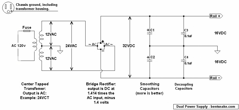

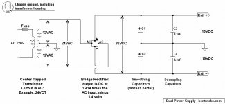

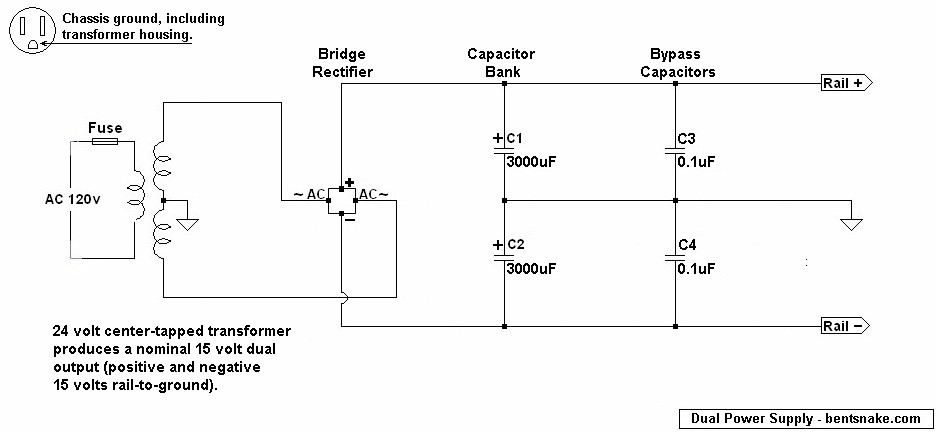

I dunno, for some reason I think the below representative schematics might be of interest. Power supplies are not complicated, even though some enjoy making them seem that way.

The general rule is one rectifier bridge plus reservoir cap for one transformer secondary. Very experienced people may occasionally break this rule, with care. Others often think they can break this rule; they can't, and usually end up either with short circuits across half their diodes or circuit nodes which have to be at two different potentials at the same time.jammin said:Does each pair need its own bridge rectifier from the tranny? Or one high rated BR followed by paralleled smoothing caps /rectifiers.

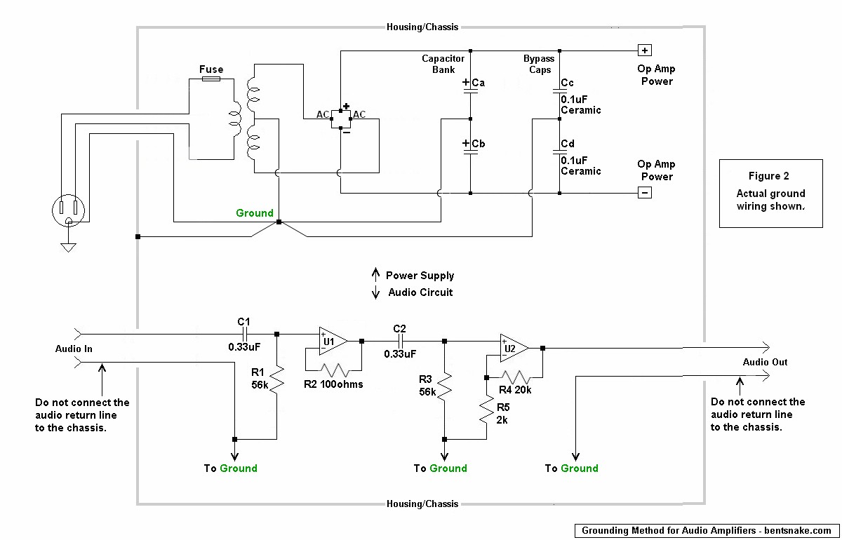

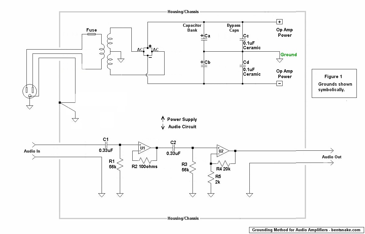

Obviously a case where small problems can become big ones. So although you didn't ask I'm going to volunteer my suggestion for a grounding method.
WAIT! The circuits posted below might (or might not) look complicated, but they're really not. The two circuits are electrically the same. It's the same circuit shown two different ways for the sake of what I hope will be clarity.
The rule being applied is to keep audio signals separated from power supply voltages and currents. This is desirable because, depending on an individual circuit and layout, resistance in conductors can create what in essence is a passive (resistor based) mixer. In this case a mixdown of audio and power occurs, which obviously will distort the audio signal.
There is no way to prevent this because all conductors have at least some resistance, so the problem is avoided by keeping audio separate from power in the first place. The two are allowed to mix only at a single ground point near the power transformer or battery(s).
Additionally, it will be seen that the power supply bypass caps are also separately routed to the single ground point. This is because these capacitors are injecting noise into ground (that's what they're for), so the intent is to minimize the mixing of noise into the audio signal.
The main capacitor bank is also routed to the single ground point because now it has to be. By now there are no other grounds to connect...
...except the decoupling capacitors located at each op amp, if used. These are not shown, but they too inject noise into ground and should be separately routed.
Unfortunately all this can become tedious, and in a very large circuit like yours can be ridiculously complicated. For your 50 op amps you pretty much have to fall back on some sort of ground bus arrangement. But I still suggest, at a minimum, running separate bus conductors for audio, and for power, keeping them separate until they reach the single ground point.
It might be asked, what happens to the noise at the single ground point? How is it cancelled, or where does it go? It isn't cancelled, and it doesn't go anywhere. What does happen is that it becomes insignificant.
Strictly speaking, once a voltage is created it can only be canceled by an equal voltage of opposite polarity. This does happen at the single ground point, but only at random.
The main effect is that the small noise voltages are mixed down into the relatively huge power supply voltages and currents. When this is done the relative--emphasis on relative--amplitude of the noise is reduced to several decimals. In engineering terms the noise is "swamped" by the power supply voltages and currents. It's still there, but it's relatively so small that it becomes insignificant.
I hope this might be of some interest.
