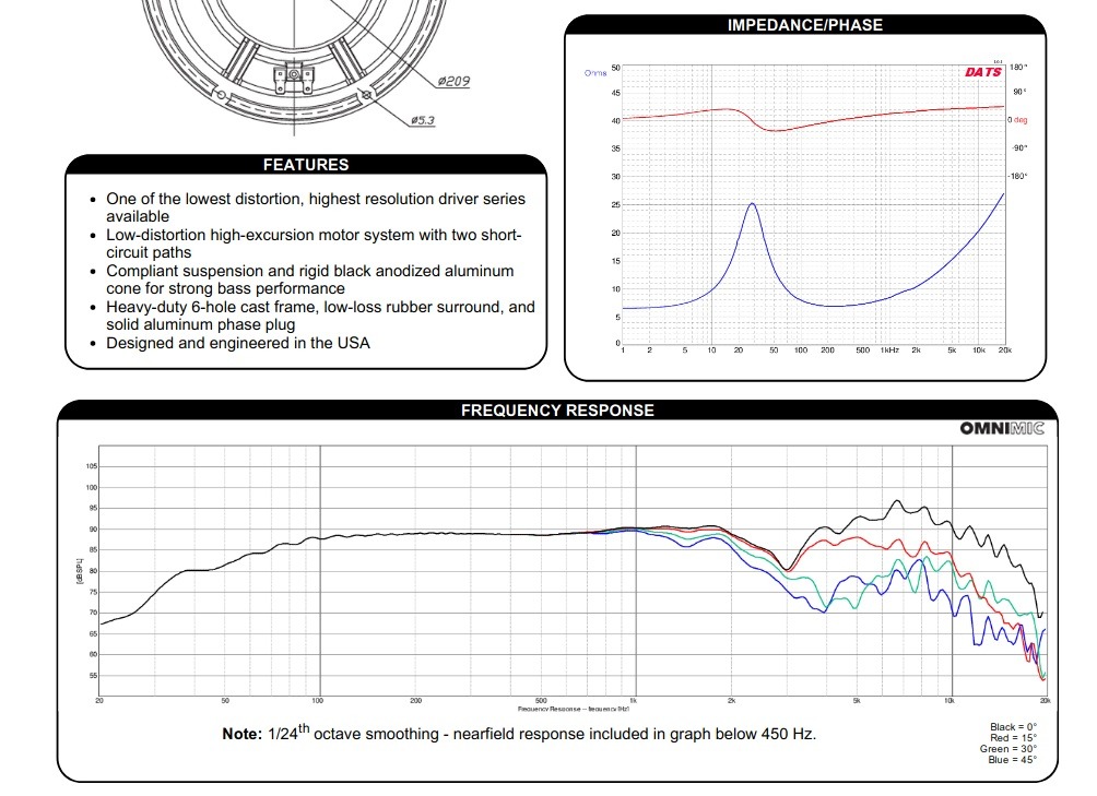

I'm trying to crossover my Dayton RS225-8 at 1200hz. I realize I'm pushing them a little high to avoid breakup but they are what I have to use without purchasing new drivers. No measuring capability here and don't understand simulation software. I'm using MH-Audio calculators. The calculator asks for driver impedance at XO point. Factory specs show about 9 ohms impedance at 1200hz. Do I use this impedance AND add a Zobel to flatten impedance or just use this? Thanks for any suggestions. By the way they are in a 42 liter BR cabinet with a 10" wide baffle. Also wondering if baffle step is needed. Thanks again.
If you use a Zobel, the impedance for the calculation is the total impedance of the driver with the Zobel.
You use a Zobel or an RC network (it does not need to flatten driver impedance totally, depends...) exclusively when you can't get the LP response behave exemplary without one.
It won't be 9 ohms after you add the standard Zobel. Just for interest's sake it should be possible to make a special 9 ohm compensation instead but why complicate needlessly.
Skipping it and using 9 ohms may be fine, yes the impedance will be changing but that's not the only thing that will be, ie the response will be too. Either way you might eventually come to a similar result.

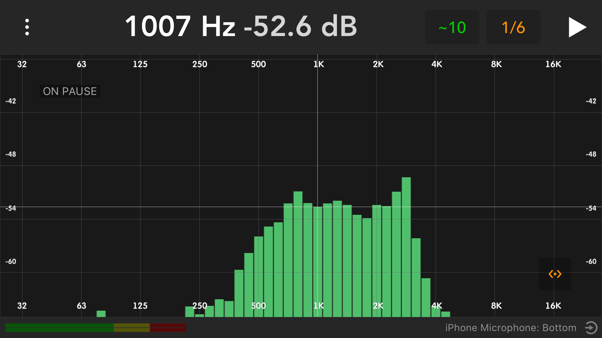

When you say "no measuring capability" - do you have an iPhone? There's programs that will display a real time frequency response of an acoustic signal. Put that with a pink noise file playing continuously and you can certainly see the response of your attempted cross at 1200 Hz, using "nth" octave bands, where n is the frequency resolution.
The mic in the iPhone will certainly pickup flat enough about 1kHz...

Can you suggest a free app that I could get to do that? Thanks.When you say "no measuring capability" - do you have an iPhone? There's programs that will display a real time frequency response of an acoustic signal. Put that with a pink noise file playing continuously and you can certainly see the response of your attempted cross at 1200 Hz, using "nth" octave bands, where n is the frequency resolution.

I use https://apps.apple.com/us/app/spectrum-eye-rta/id794366989 "spectrum eye". I did pay $13 for it. Pretty good for checking out what's there, what's not in a pink noise spectrum.

Whatever are you trying to do, TubaV? Common enough woofer. Been done before.
https://www.parts-express.com/Dayton-Audio-RS225-8-8-Reference-Woofer-295-356
What does everyone think? About 8.2R and 15uF impedance correction? 😀
