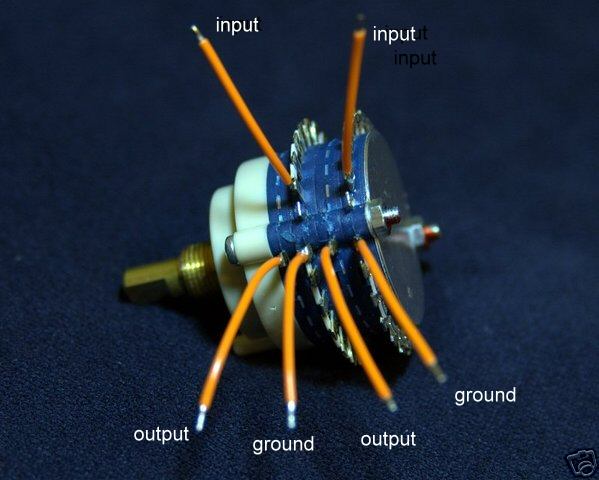

I am sure that I am wrong because I obviously make a systematic mistake.
Let me explain it this way:
My attenuator is a 21 step. I was curious about the impedance values between input and output at different steps. With the multimeter I measured for the 50 kohms log pot.
- Step 1 (turned off full left direction): 50,9 kohms
- Step 2 : 50,6
- Step 3 : 50,2
- Step 17 : 40,0
- Step 18 : 35,0
- Step 19 : 30,0
- Step 20 : 20,2
- Step 21: 0,0 (turned into full right position)
So you see at step 17 a value of 40 kohms. This is a common big output Vol. position. I can particullary explain my mistake myself. The current is constant determined by the value of total Resistance value, or not ? In my case 50,9 kohms. So let's consider a constant voltage of 2 Volts coming from the CD Player -----> Current = 2 volts/50900 ohms = 0,00004 amperes.
In every attenuator step the current is same as above calculated, O.K. ? Only the divided voltages change depending on attenuator steps. Like the calculation: U1/R1=U2/R2=U3/R3= ... 0,00004 amperes. The bigger the Resistance the bigger must be the voltages to get same amperes. But why I get 50,9 kohms (Step 1, Vol. minumum !) which should mean that the voltage is here full input (2 Volts). I suspect that my attenuator has no resistors in series where the voltages are as different as in their different taken positions. I think that in my attenuator every step has it's own value based on different resistors. On the other hand I would get this time different currents at constant voltage and different resistor values. But the poweramp's output power is adjusted by different gains usually measured in volts and not amperes ....😕 I added a pic of the attenuator - maybe there is another mistake. attenuator.JPG

Hi, do you mean I should take the difference:
Voltage value of Step 17 = 50,9 kohms - 40 kohms = 10,9 kohms
U total/R total = 0,00004 amperes ----> U at position 17 = 10900 * 0,00004 = 0,436 Volts. That would make sense the 0,0 kohms value at position 21.
When I take the difference 50,9 kohm - 0,0 kohms = 50,9 kohms and the result is full input voltage (2 volts).
There are two impedances which matter in a volume pot or a step attenuator: input impedance, and output impedance. The impedance from input to output does not matter so there is no point in measuring it.
In most cases the higher the input impedance and the lower the output impedance, the better. Typically, the highest output impedance occurs at the -6dB position, where output voltage is half input voltage, and is equal to 1/4 of the total resistance. In your case this would be around steps 19 and 20, which have an output impedance around 12k.
